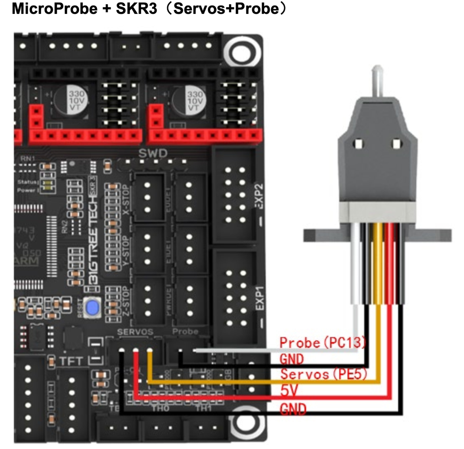

How does the Biqu Microprobe work? A quick look a their documentation leads me to believe you hook up 5V and GND, then have two GPIOs - one for deploying/retracting the probe and one for reading the value.
You should be able to do this with gcode and pin definition in FluidNC.
Looks like you use the orange wire to deploy/retract the probe, this would be an output pin you define and toggle with gcode when you want to probe.
You read the white wire for the probe status- this gets connected to an input pin.
You’d need to map the probe deploy/retract to a pin you define that is accessible by gcode, and define the probe pin to IO you read to see if the probe is triggered.

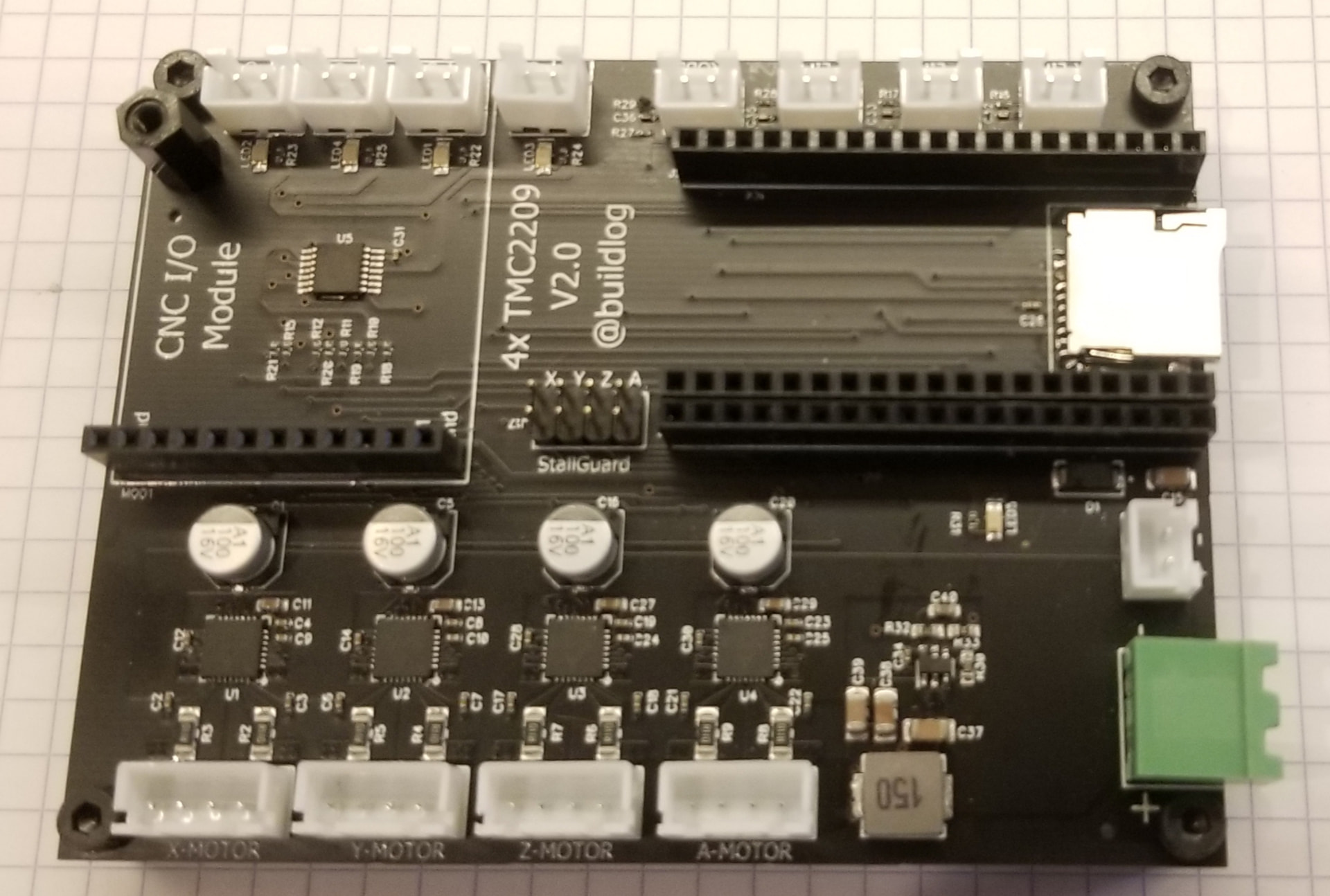

As a reminder from other posts on this site, this is the controller I’m working with. I did finally stick some heatsinks on the TMC2209s

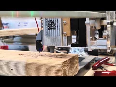

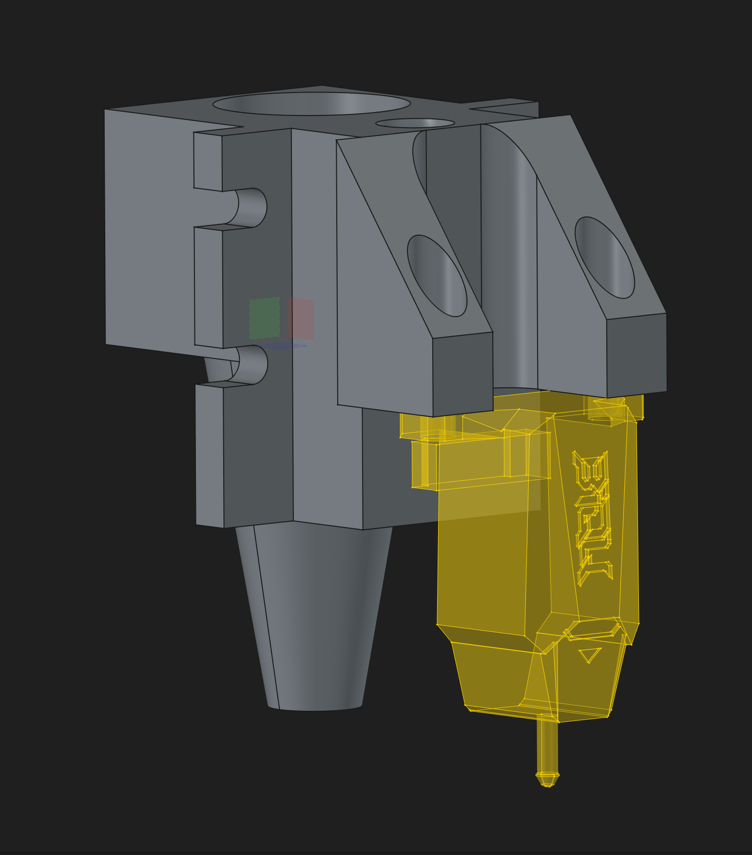

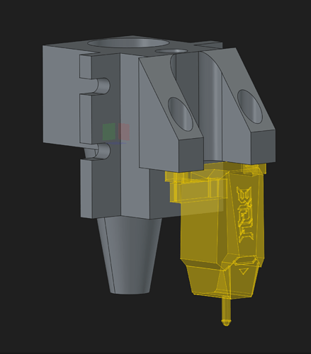

Had to remix the air-nozzle to add the microprobe mount.
It’s alive! I still need to figure out the homing sequence.
