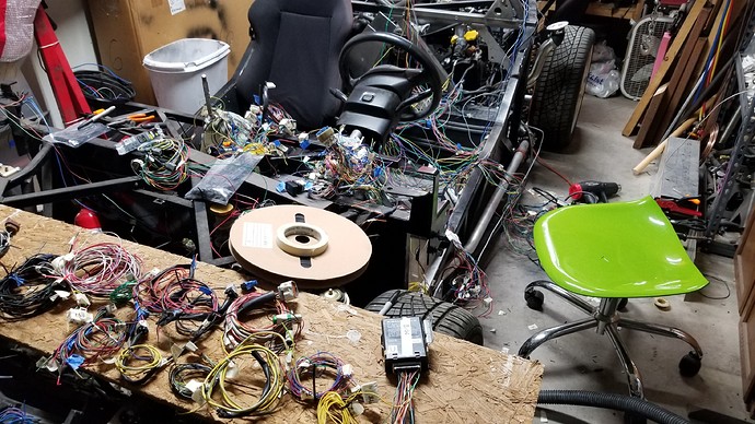

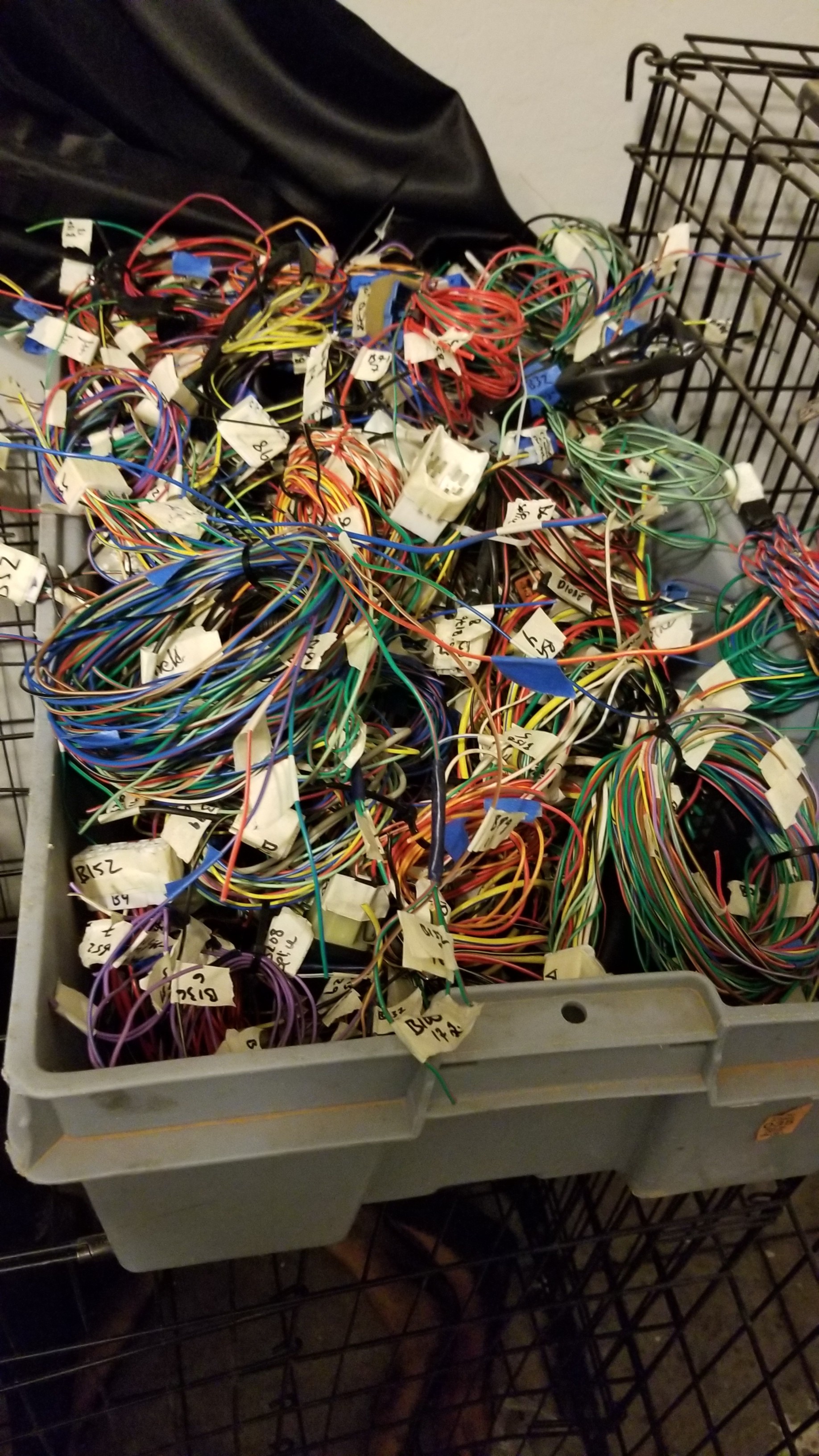

Oh that is a lot of wires. That looks pretty fun, and stressful at the same time. I like organizing wires, and shortening them, but extending them drives me nuts!
It’s just like extending wood. Grab each end, and pull! :hernia: :andre_the_giant: :hulk:
Hmph… :weaksauce_emojis: :wink:
Yeah. It was bonkers, and with all the time I spent building and playing with my V1 machines and resulting printer, it ended up taking me a little over a year from cutting the first wire to the first engine re-start, lol.
My goal was to retain as much OEM functionality as I could, so I only removed things that I can’t use (airbags) or would rather upgrade (stereo).
I took some advice I was given to leave the wires as long as I could to minimize the number of splices and, by extension, possible failure points. But if I were to do it again (which I likely will) I’d just cut the connectors off, mount them where they belong, and run the wire as needed. I spent A LOT of time managing the wire coils and tangles.

Yeah the wiring was…and still is…something of a mess. At some point, this car is coming all apart and going back together. I’ve gotten better at some things, acquired some tools since I started (like a cnc) and I think I can do better.
The wiring took forever, but really it was more like a puzzle for me because I cut it all apart. Every single wire. Put it all back together by reading the schematic.

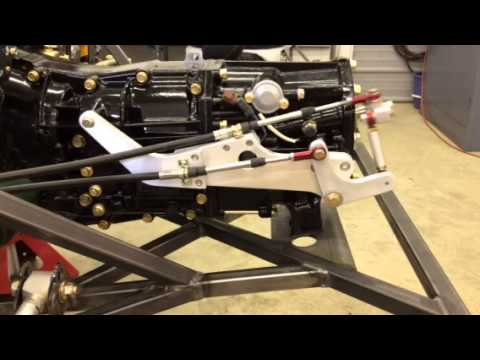

New project…bell crank. Have to reverse the motion on both cables to tidy up the rear and be able to flip the shifter. The plan is to make the bracket or is steel and the other pieces from alunimimium. I’ll have to resize the primo to attempt this, though. As for the steel, I’m not sure how many times I want to try it. At least once, no doubt, but maybe if it doesn’t go well I’ll strap on a marker then cut it out by hand or send it off to the water jet guy. That’s what I built the first burly for anyway. Mock up parts and either mark them out or send them off.
I need to add some rods for linkage to the selector, then figure out the selector bracket, still.
Here is some video of somebody else’s solution with a different shifter that only needed one direction change, but the video is a lot better at showing the idea.
