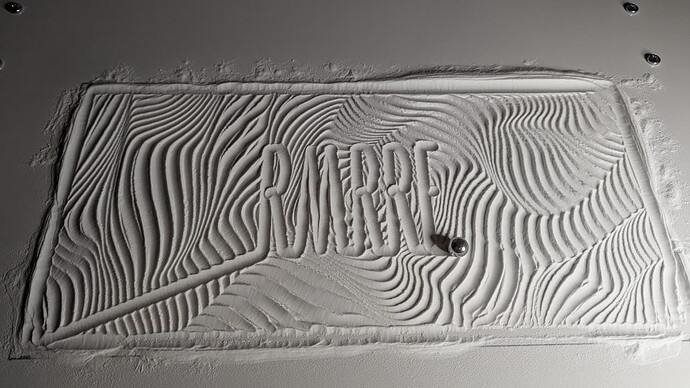

Finally building my ZenXY
It became possible to do this in the 1.0 version. Since loops and scale/rotate are now effects. I have been meaning to do this with some simple sort of logo. It has to be pretty simple in the beginning, and it helps to not have many concave features. The V1 logo is perfect, but it is already built in. I was thinking of doing a batman bat or something.

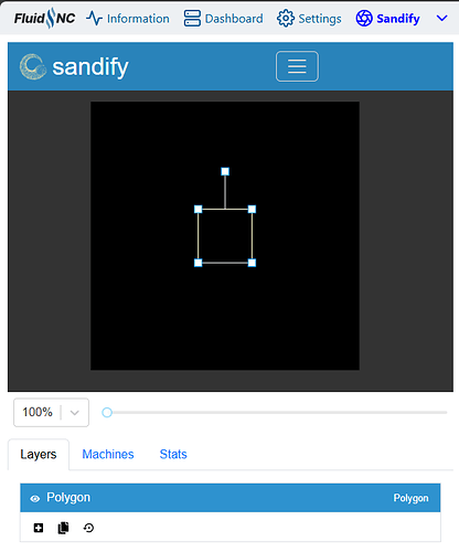

It doesn’t really do anything for you, but you can add Sandify webpage as an extension so it shows in a tab within FluidNC. I’m not sure if this requires the CORS changes that I have setup on my pen plotter. Of course, that only works if you’re using STA mode for Wifi. I’m not sure how big Sandify is (or if it compiles to a static webpage) to know if you could store it directly in flash like extensions typically are.
I suppose if Sandify was modified to be able to detect if it’s running in a FluidNC extension, and could hook into uploading the file to the SD card, maybe something is possible. It would be cool if it could see the FluidNC status info and overlay the current position on top of the image. I haven’t looked into the Sandify code.

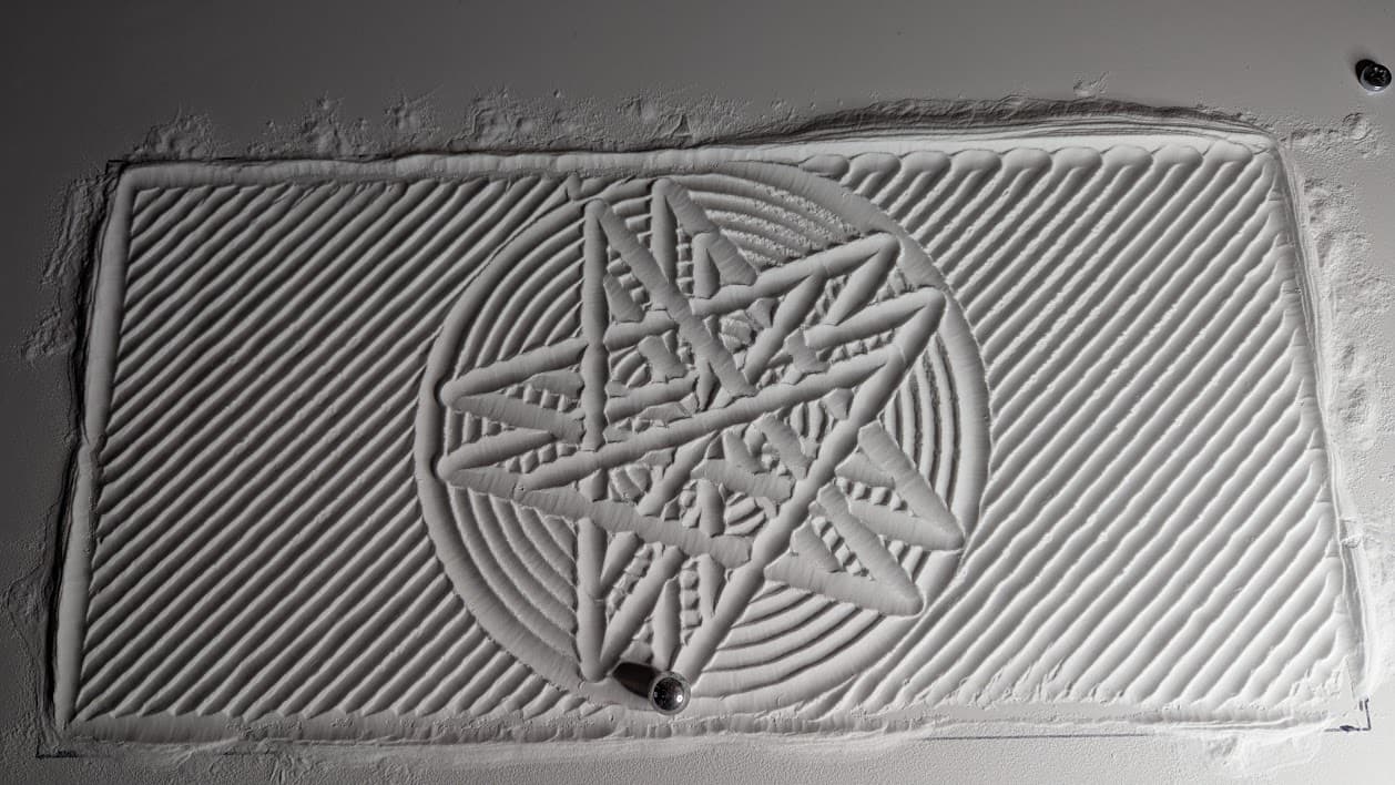

Fired up sandify and cranked out a quick test design and it ran perfect:
Well, other than the F getting a tail that makes it look like an E. But not bad for my first time trying the text tool.

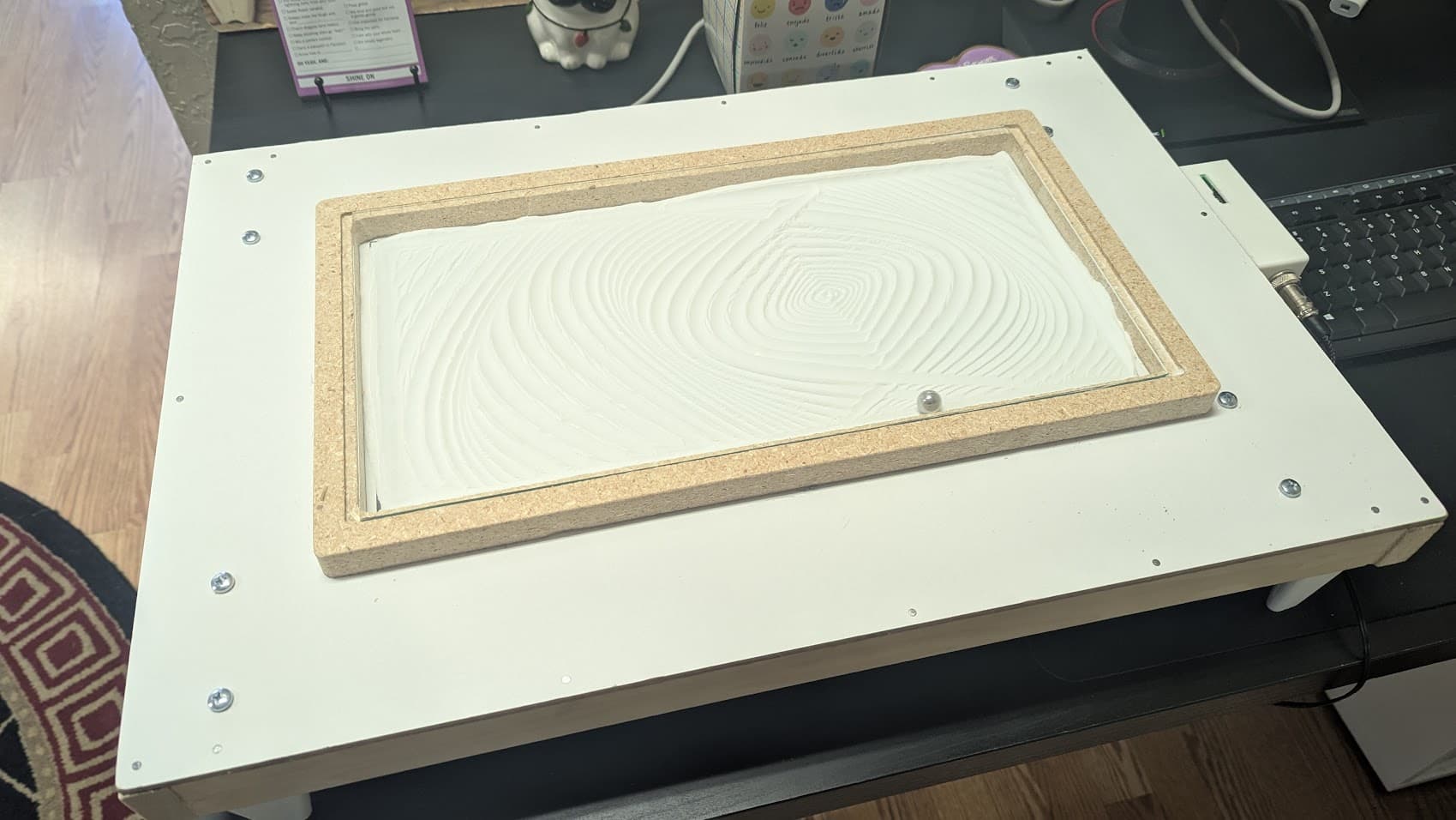

Sunday I fired up the LR4 and finally made a top-frame for the prototype table:
Of course I screwed up again. The first attempt I sized the frame to the piece of glass I bought…and it almost worked. But the inside pocket cuts were very slightly undersized so the glass didn’t quite fit. The glass wasn’t really the right size for my table but I was trying to rush and my glass cutters were still at my old house so I sized to the glass instead of to the table.
But since then I brought my glass tools over to the new house so I figured I can cut the glass down to size now and should design it to fix the actual “drawing area” instead of designing to fit the glass.
I also added some rounded corners just because I could. I was going to try and engrave a decorative bead into the top as well…but decided not to push my luck as I really wanted to bring the table into work this week and didn’t want to do that without glass over it.
The problem is I didn’t bother to check the dimensions of the glass this time. The first time I was worried that the X axis was a little tight but that was a few weeks ago so I forgot about that. As a result my glass is slightly too narrow. It still protects things enough that I felt ok bringing it to work…but looks like I’ll have to pickup a larger piece of glass to do it “right”.
