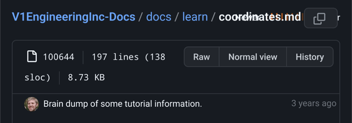

Wait when did you create that! Never saw it before.
So i also started with vinyl. It was fun and created alot of stuff for kids. Seemed easier as i didnt have a ton of deep cuts to figure out.
According to git, 3 years ago. Maybe it needs better advertisement
It was not only me either. It is a community contributed document.
