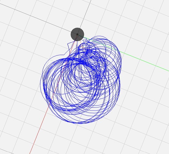

i ran my code from aspire in nc viewer and i got this picture , so now I am convinced that i digitized it correct

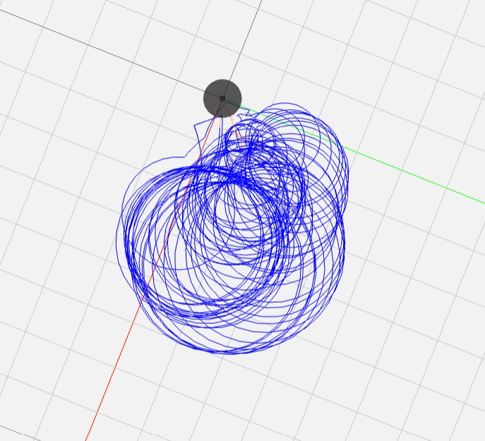

this is anisa crown on nc viewer
Can you post the first few dozen lines of the aspire code?
Nc viewer is more generic. It will be ok with gcode that won’t run on the MPCNC.

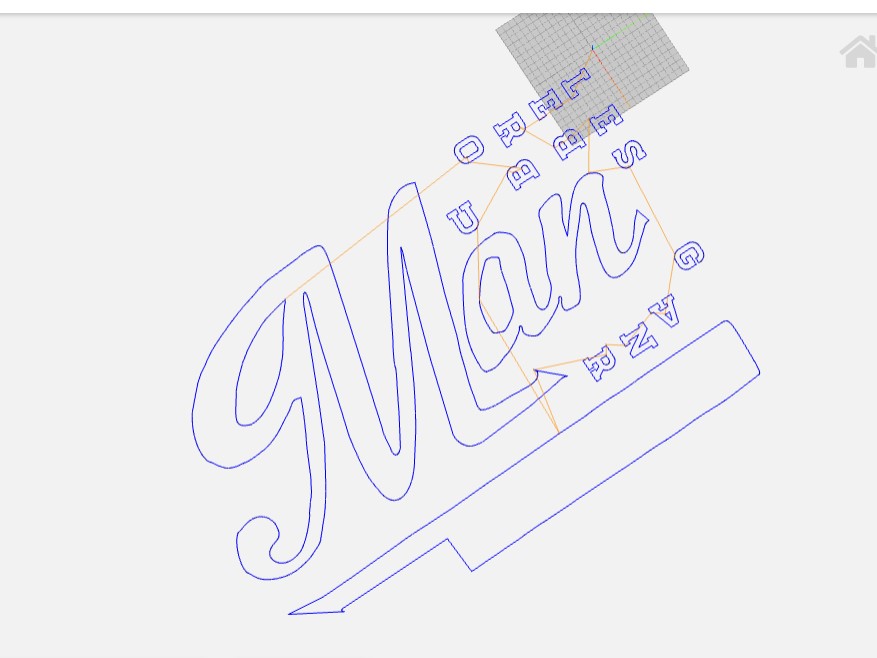

This all looks fine
There is no F on the first two lines. So they will go at whatever speed the machine was last moving at.
This is going to go to -64 in Y at 700mm/min, because that was the previous speed.
It will then plunge at 40mm/min to -6. Then start cutting in XY at 700mm/min
The G0 Z5 is going to lift the Z at 700mm/min, which is a bit fast for Z. It will then travel to Y-79 at the same previous speed and then plunge at 40mm/min and start cutting in XY at 700mm/min.
This is all ok, except the G0 moves don’t have speeds on them. In the Estlcam basics settings, we force it to put a speed command on every line, including G0 moves. That makes it force the MPCNC to go at the desired speed in all those cases.
The consequence for you is just that it may be trying to zip up and out of holes too fast. One workaround is to set the max Z speed for all moves so it won’t be possible to skip steps when climbing out of a hole. The other consequence is that there may be a move where the Z is moved slowly, and then the XY is moved without changing the speed. In that case, the XY travel move will be at plunging speed. Something like making a bunch of drilled holes would cause that.
I saw in your video that you reset the XYZ to 000 before starting. If you want to skip that step, you can add G92 X0 Y0 Z0 to the top of the aspire file. The first thing it will do is the same as that reset coordinates button.
Otherwise, I think this file should work.

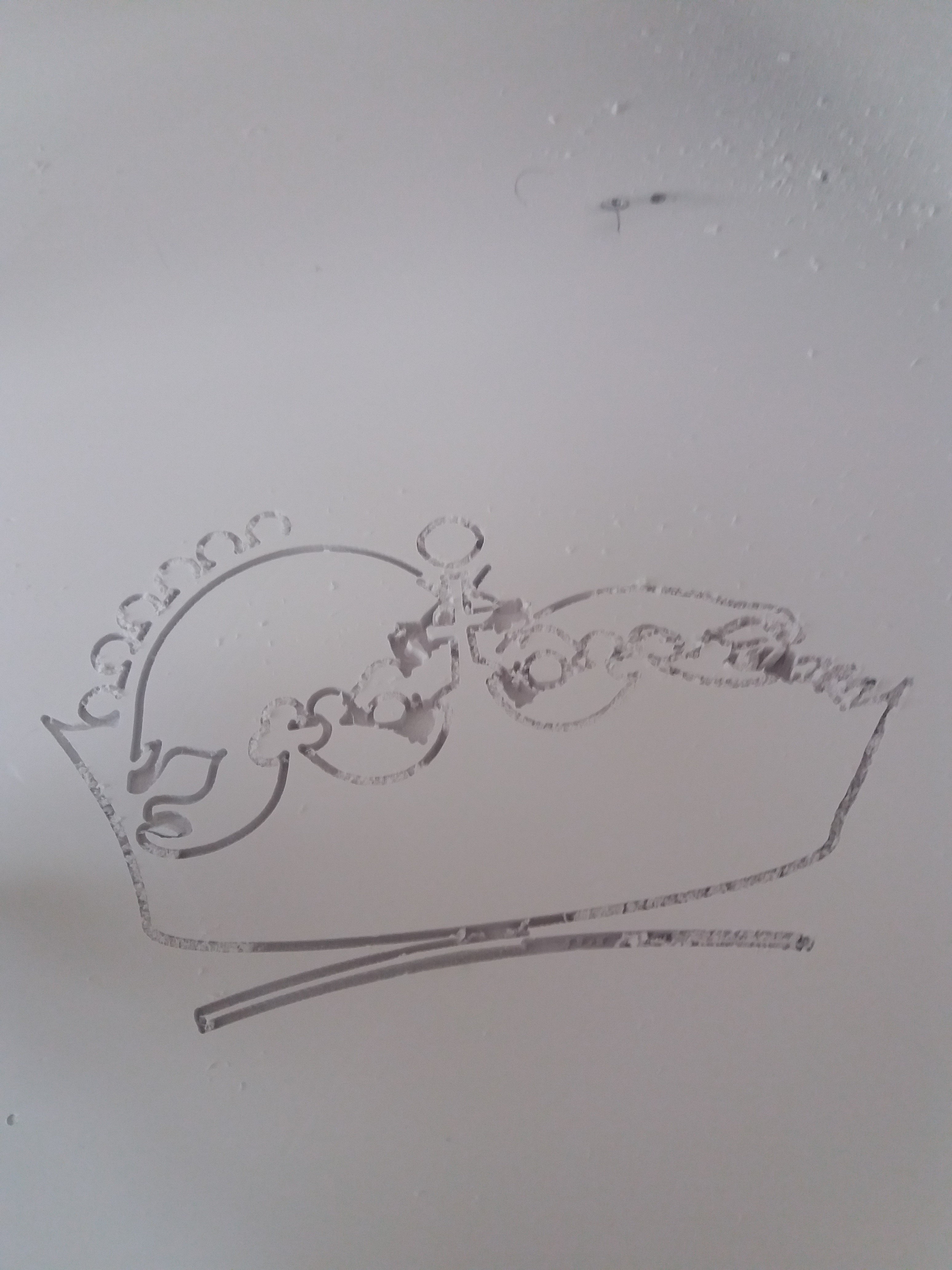

@jeffeb3 this is the code with the router on
It went deeper than 1mm but the LCD said -1 on the Z axis
it went 4.2 mm deep for the crown in the last picture

It looks like the crown was working fine, what happened when it went bad?
As for the depth, when you tell it to move 10mm in the z direction, does it move exactly 10mm?
Yes it moves exactly what I ask it to move with the LCD screen . @vicious1
