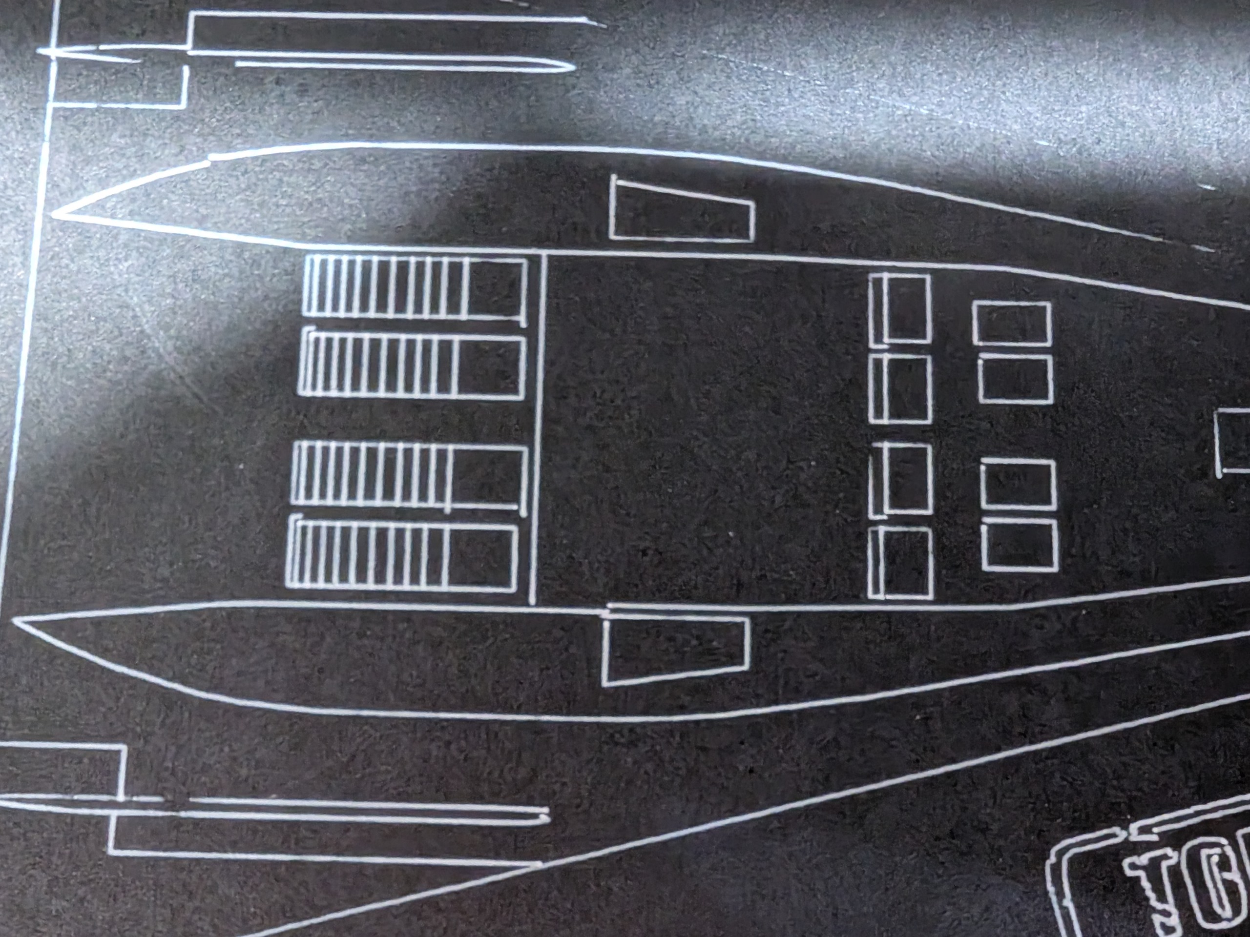

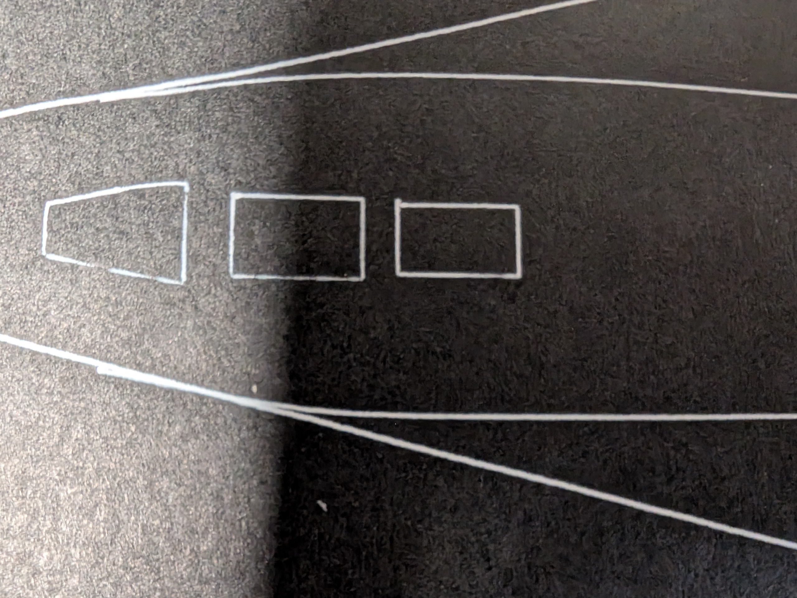

There’s still some imperfections. The V1E mount is the best of the bunch but still not really completing trapezoids and squares.
At this point I’m wondering if there’s something I’m doing wrong in Inkscape to cause the path to have problems in the first place. I’m happy to try any further troubleshooting/testing on the Primo if anything else exists to try.
Ignore the skips in the ink, that’s known to be the pen’s fault. Also ignore the curves being off, I’m just using Estlcam to move them to just right rather than keep chasing that particular dragon.

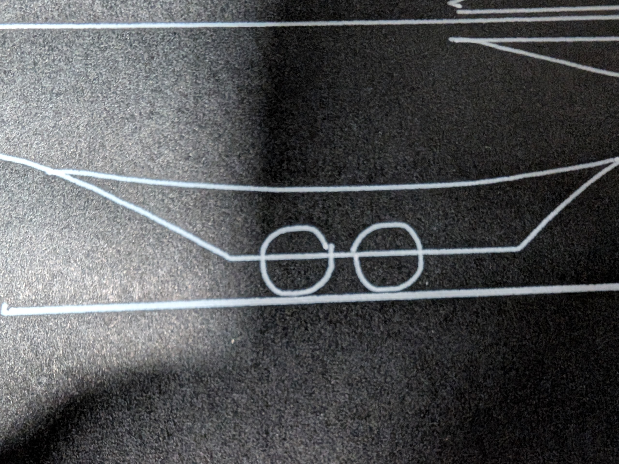

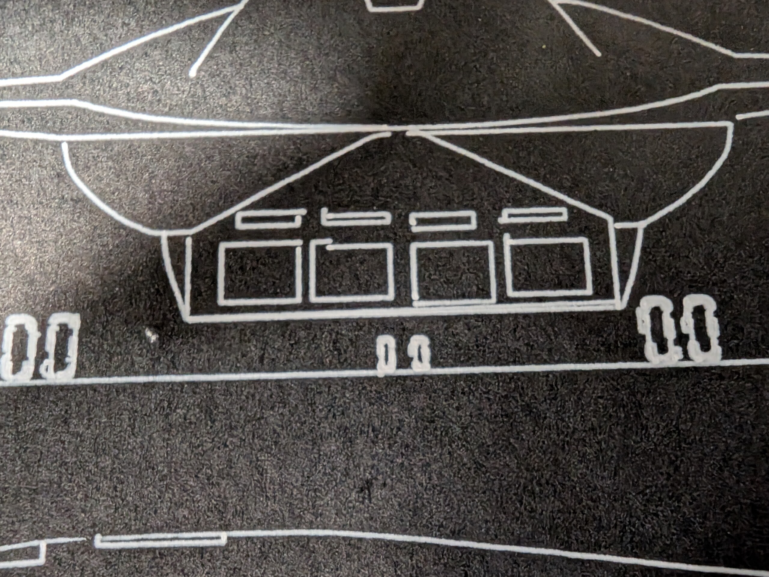

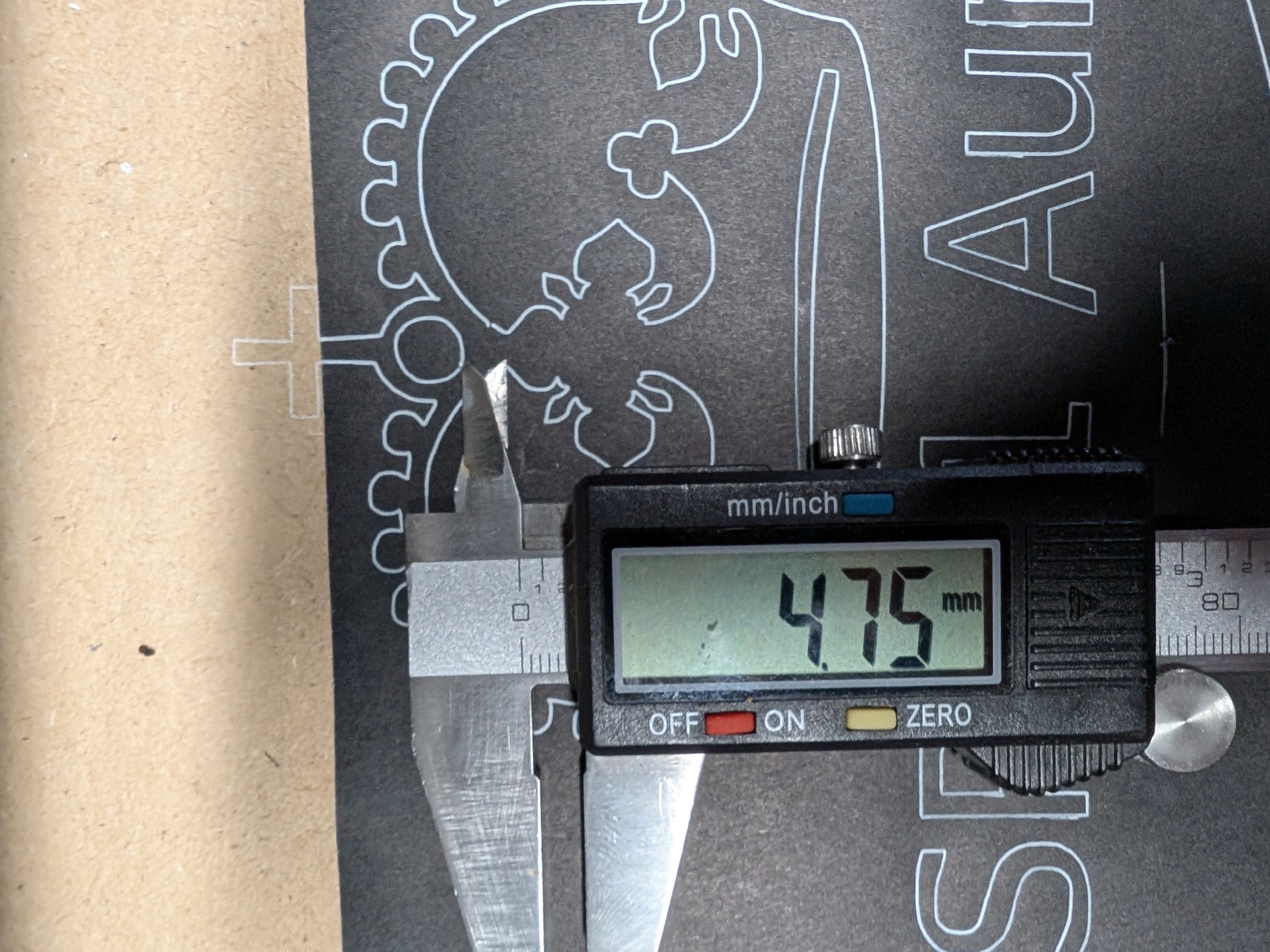

The crown itself does not come out evenly. I plotted it and observed the pen through the entire process. As far as I could tell, the pen didn’t skip. I think I heard the right hand Y stepper thunk at some point, sort of like the sound it makes when I try to move it past the limit, but not a long grind - just one thunk of a grind. I’m not even sure it was the Primo, it could have been something else in the house.

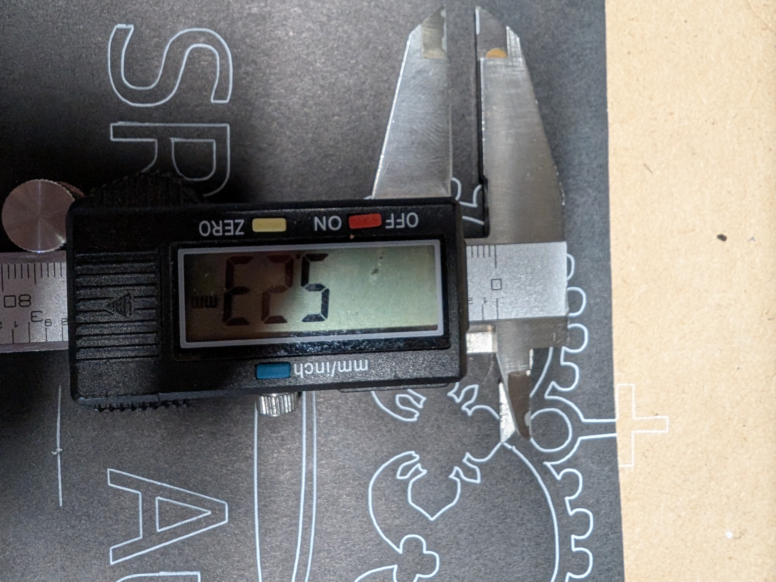

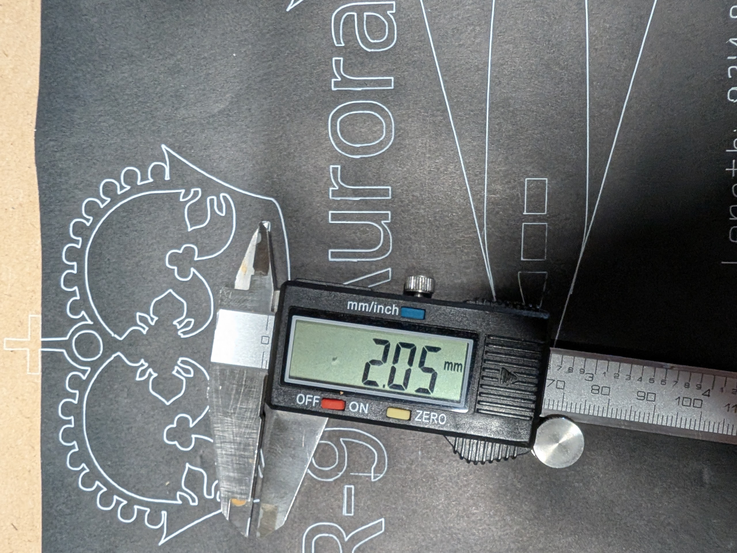

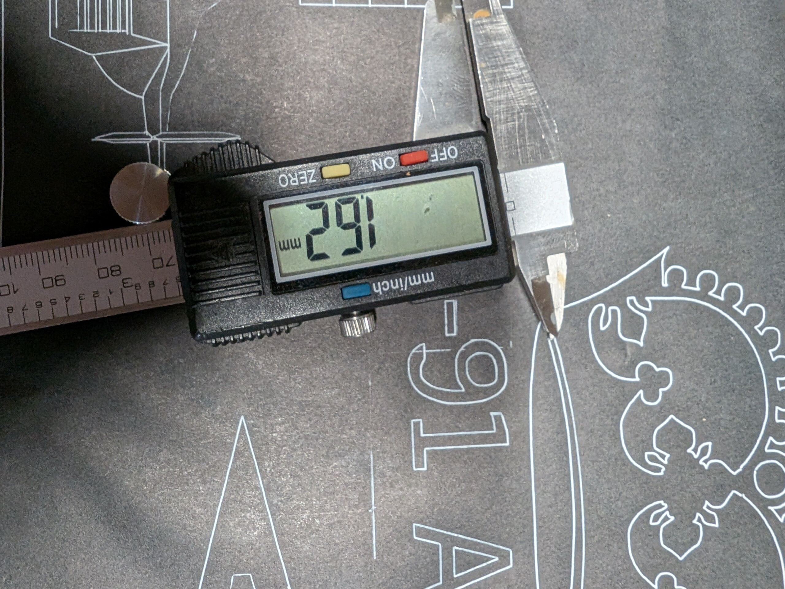

There is a mismatch in sizes on parts of the crown. The circles look like they’re flattened across the top a little, and the central parts are misaligned as is the bottom long part:
I can assure you that is not a skipped step. skipped steps are drastic and accumulative, they don’t fix themselves.

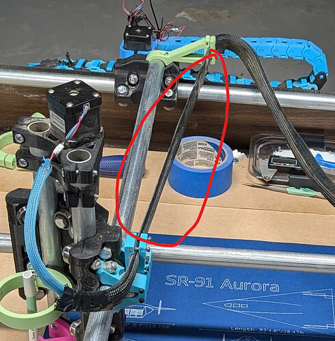

At this point I am fairly certain your z wiring or gantry drag chains are causing the issue.
I took off all the X and Y drag chains and just enough Z drag chain mounts to ensure it’s pretty much zero tension on anything. I basically babied them through a plotting session. No real change.

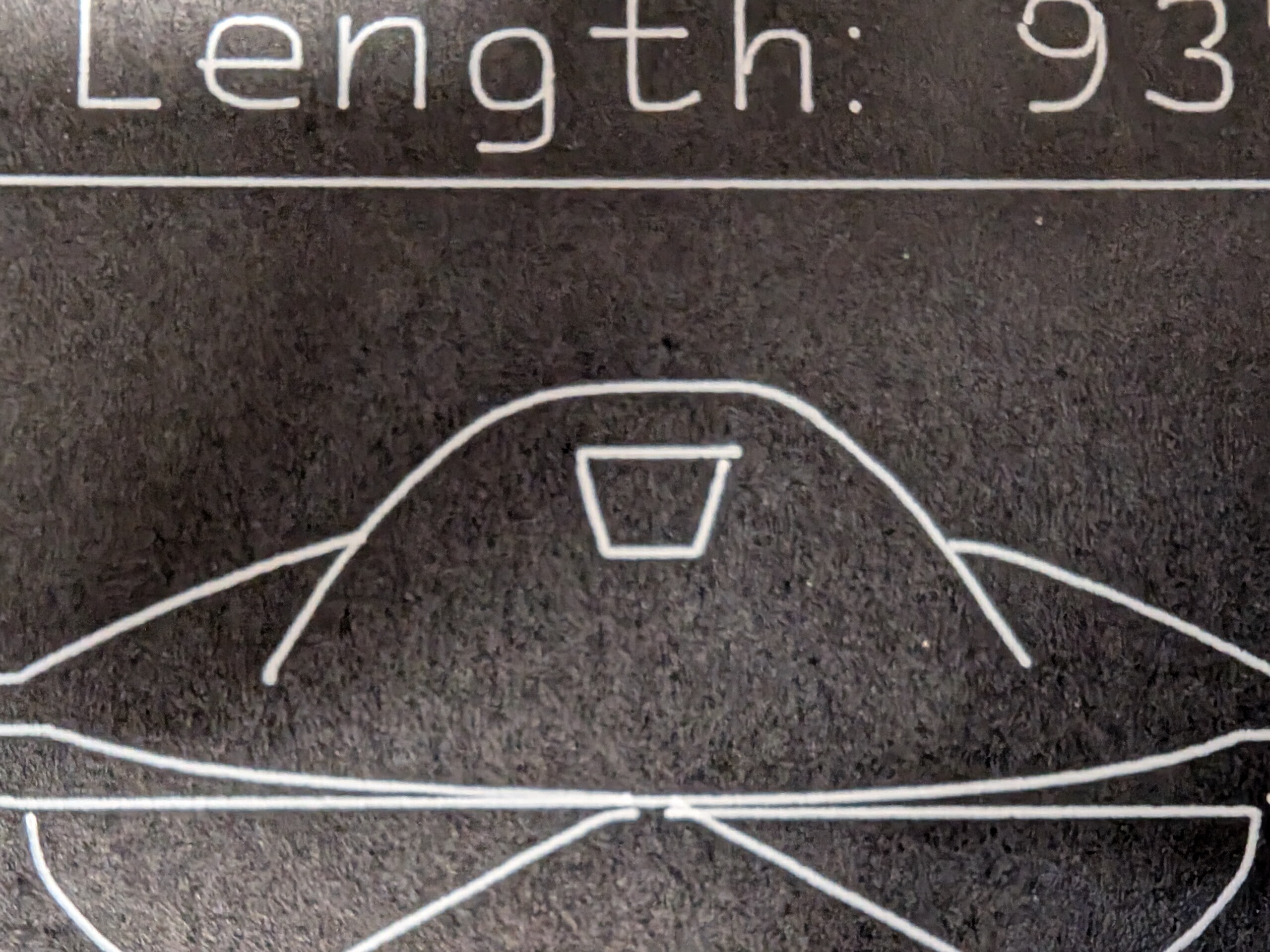

In the interest of making sure it’s not my amateurish Inkscape skills, I put together a quick SVG of a completely new blueprint. I took serious care to ensure all the paths were snapping to cusps, lines, etc. It still occurs, this time I caught it on video: https://imgur.com/Uapdk42
The issue happened at a few points before I started recording but you can see what happens from 0:45-0:36 on the countdown timer in the video; it deviates by a mm or two when it finishes the shape. Same thing from 0:36-0:25 and 0:14-0:09.

This picture right here, you have removed this section of constraint that goes tight?, all wires should have a large loop in them.

I agree, it looks to me like the pen is moving in the holder. The tip of the pen doesn’t always make it to the end of the path and some (many?) of the path start and/or end points are shifted. This implies that there are places where the pens forward movement encounters enough drag to shift the tip backwards a bit in the holder. Based on where that would need to happen to explain the shifted start/end points, it looks like the pen stays shifted until there is enough drag to cause another shift (relative to whatever direction the pen was moving in).
It looks like it has the same issues, lots of lines that don’t make it to/are offset from an intersection point.
