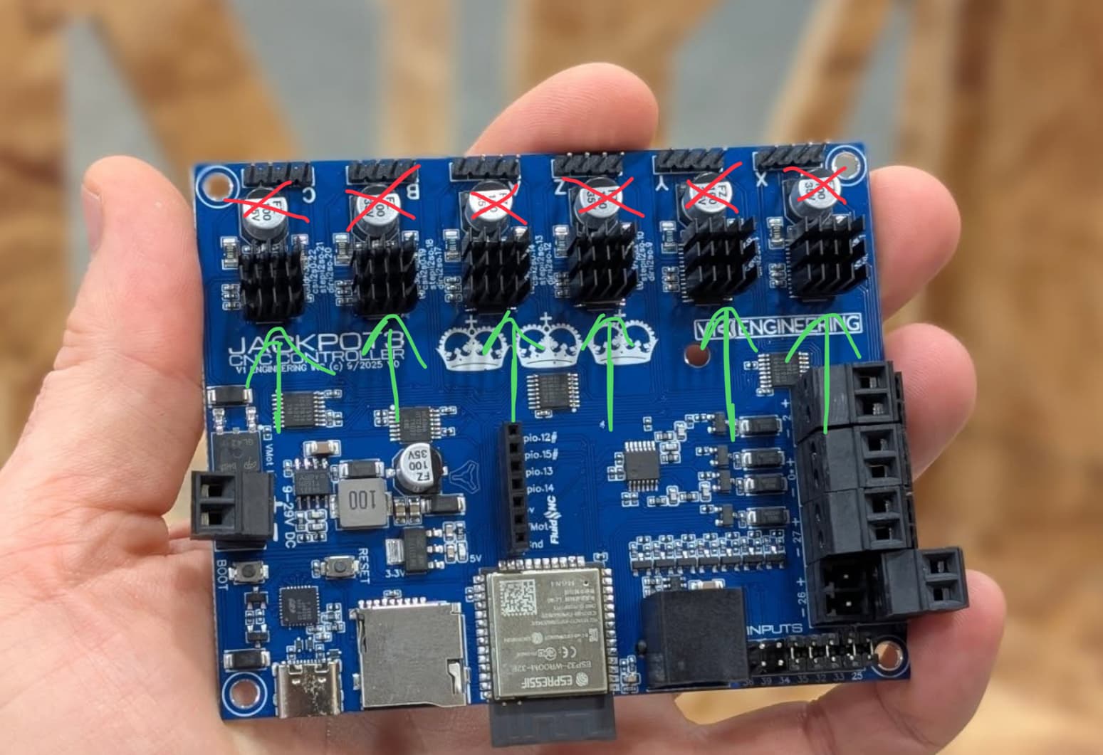

OK, I went back to the Primo after dinner with my iPhone and, of course, could not get Error 14 no matter how I tried to reproduce the actions I took during the afternoon. But I do have the data a from the $SS command, a picture of the board, and a couple of files that caused the error. Hard to tell how the unit is wired up from the picture but it is exactly according to V1 documentation for the Jackpot 2 board and using all cable and hardware purchased from V1. Except for Error 14 the unit, which has the duel stops on X and Y, is running perfectly.

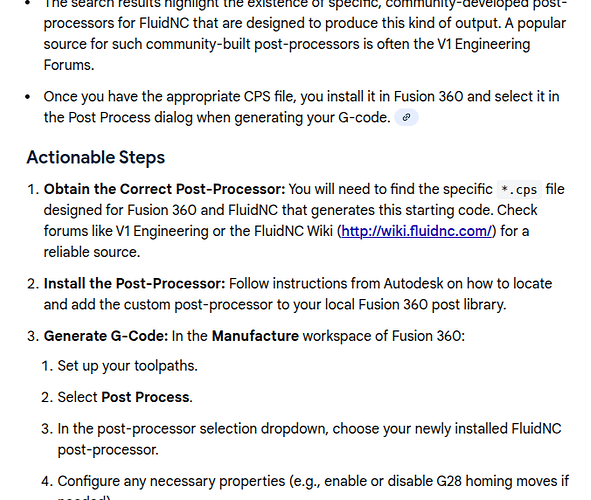

Are you using the correct post processor? my search suggests fluidnc may have problems with that%
also guys look a.I. Is suggesting v1e
After consulting the forums on V1 regarding Fusion, i am using MPCNC v3.0 (Beta 3).cps as the PP – which I think is the latest. Of course it is a beta. I use Fusion for most of my design work and I like it because I often design complex devices which consist of both 3d printed and CNC parts. Some have suggested I use Estlcam and I could import STL files into it from fusion if I don’t want to design in Estlcam. I may do that if I have other problems with fusion.

Just a heads up about your board. The drivers heat sinks should look like this:
There arent any levels of FluidNC. Any one of the Jackpot boards all run the exact same firmware. You are good on the JP2.
You cant do any design work in Estlcam. It is strictly CAM work. You can import STL’s if you are wanting to do a 3d carve. But if you are doing flat parts I would suggest exporting a DXF of the part from fusion. That will be much easier to work with in estlcam.
Thanks for confirming my firmware level. I will move my heat sinks. I thought they were awkward on top of the cans. I will fiddle with the Error 14 issue but it is not stoping my work. In fact I finished my first project yesterday and the Primo performed well. I can always go the Estlcam route if I have issues with Fusion. Thanks
