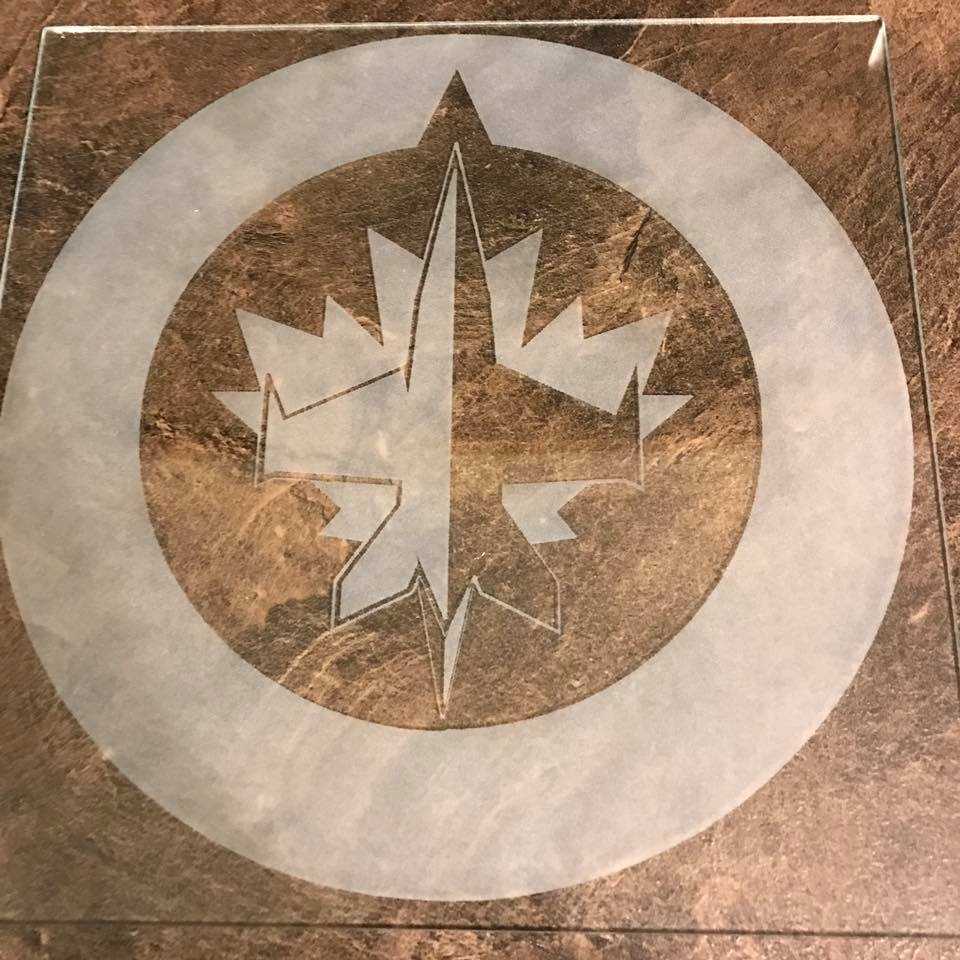

Well we are morphing our mirror process slightly. It taking 12-20 hours to do a mirror is getting a little tedious and now that I have the vinyl cutter working sorta… I will be switching to sandblasting mirrors. That will take my time spent per mirror to about 15 minutes.
This was my first attempt on just regular glass.

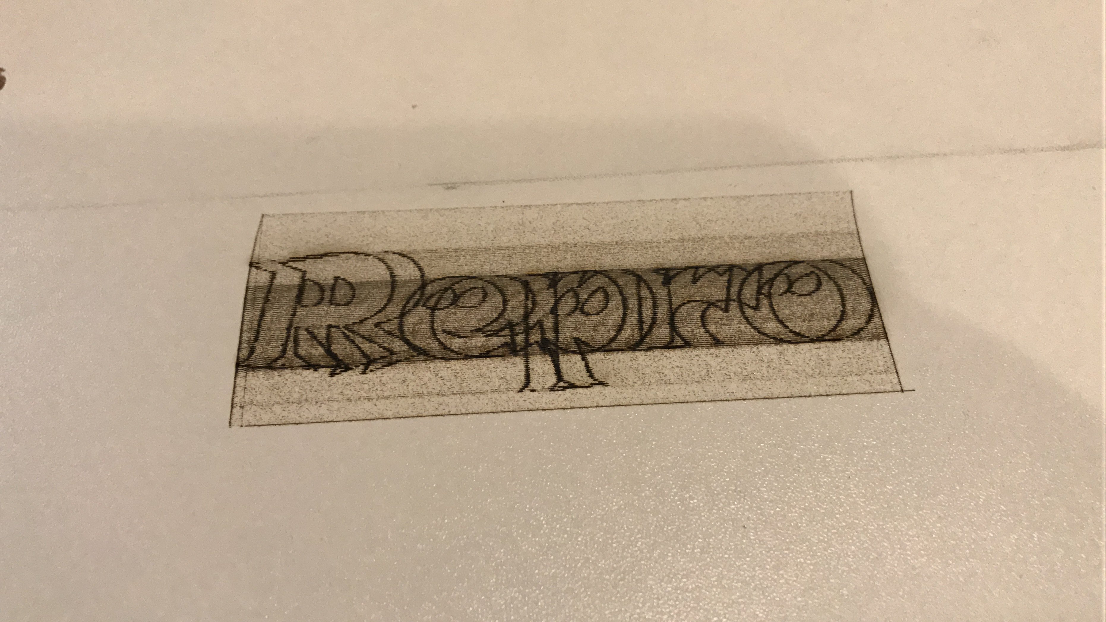

I got a realy strange thing.

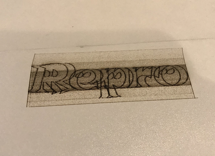

When i create something with ESTLCAM or with Inkscape it works fine but when I want to convert a picture and engrave it i got everything twice, as it seems in a shift to right … (See image)
I tried an other laptop, also changed the driver board. Same results.
Someone had this before? And how to solve this?
make sure you don’t have a hidden layer in inkscape.
I’m not using inkscape.I was talking about the img2gcode converter.

Check all your layers. Might have one that is offset that you don’t see. I also see an issue when converting multiple layers to geode, layers are replicated. I haven’t figured it out yet, but layer one is fine, layer two is layer one and two, layer 3 is layer one, two and three… etc. I go in and clean up the replicated layers. Typically, the designs are standardized, so I only have to clean up the files once.
