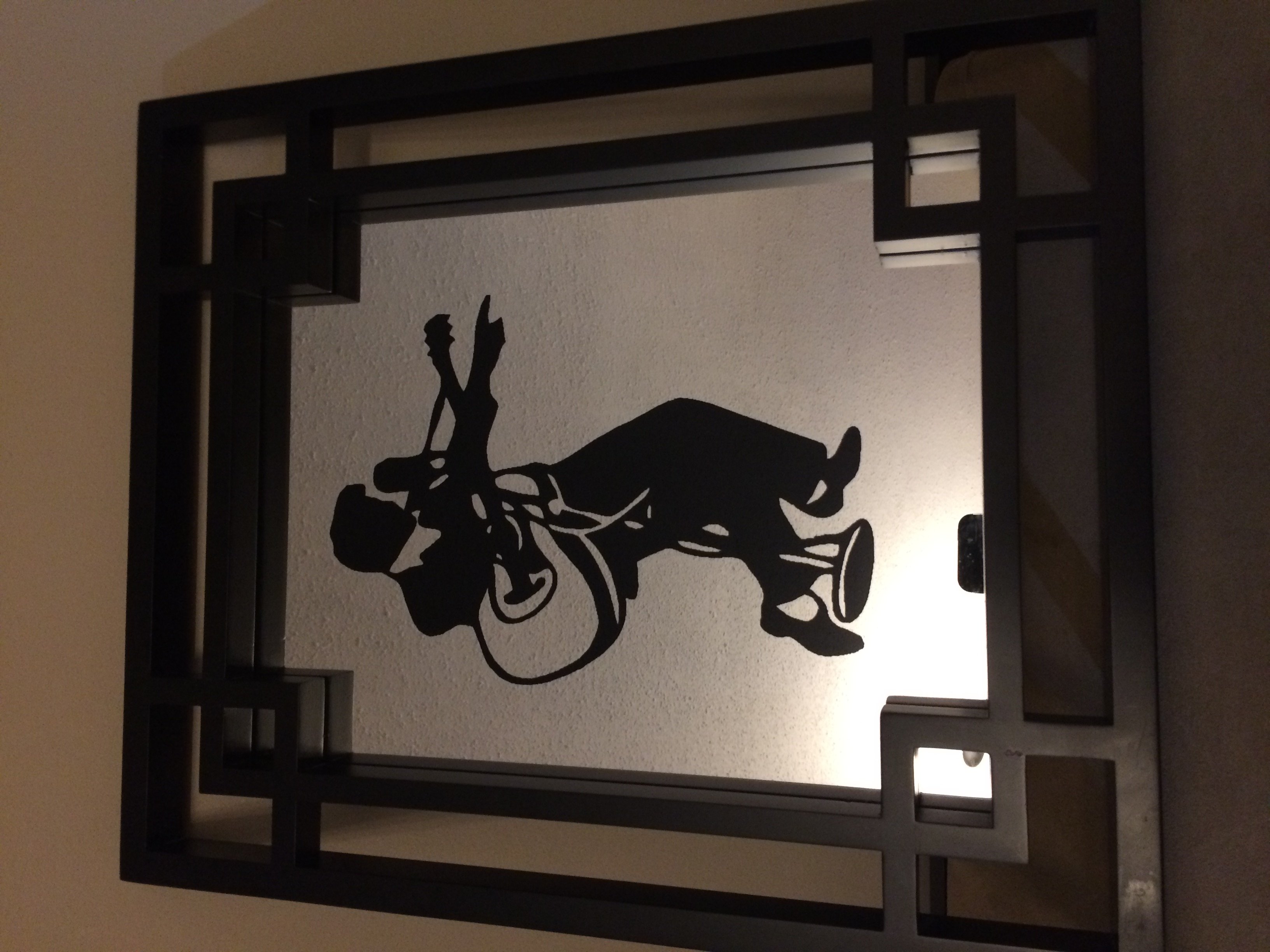

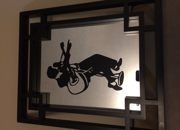

Well my Mom wanted in on the engraving too… So I made her an Elvis mirror. This one was run twice. The mirror coating was totally removed then sprayed heavily with gloss black paint. The mirror is an 11x17

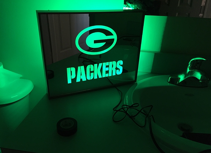

Here is the latest back lit creations for customers.
Each unit uses 1 meter of 5050 LED strip. I have the boxes custom made from 4mm dibond. The boxes get screwed to the back of the mirror frame.

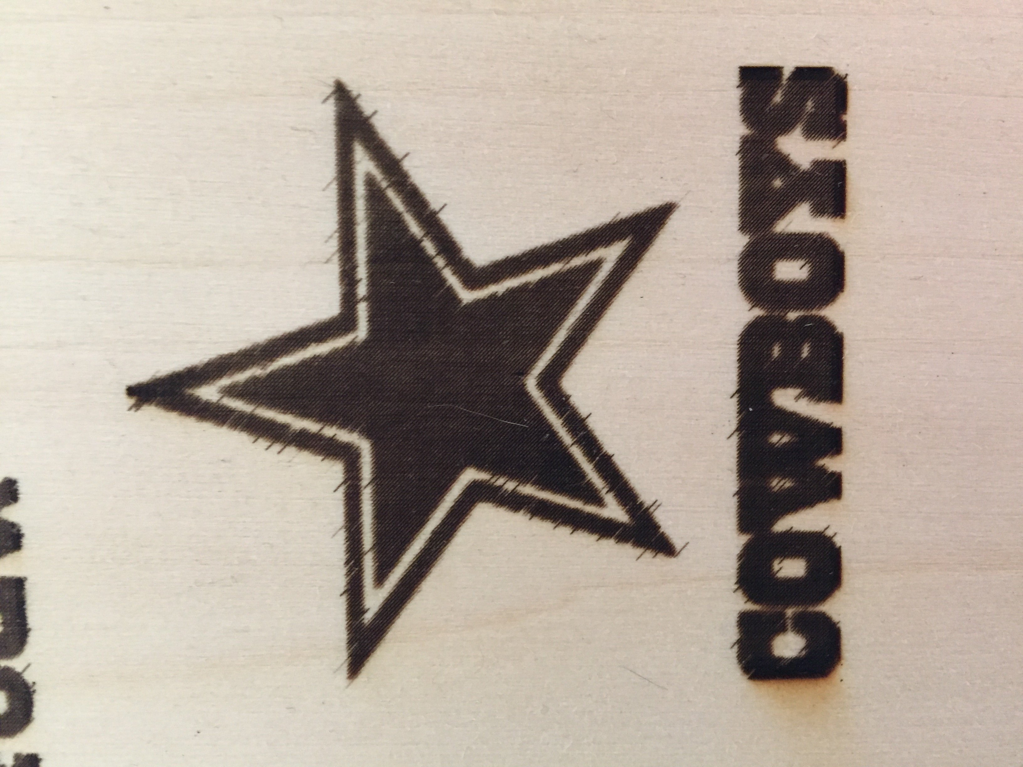

Trying to do some images with white space but I’m getting burnt smeared lines across the image. See my attachment and you’ll see what I’m talking about.

That info is set in the header. And speed is set in feedrate.
I would say try slowing it down or turning down the acceleration… I would start with the accel.
Mirrors and quality of image is very dependent on their coating on the back. If it is not dark spray it flat black.
I find I get the best quality if I use a pixel resolution of 0.1mm
Let me know how that works
Hey thanks for the tips! Slowing it down has helped a lot with improving quality. Btw. What feedrate and accel rate do you usually use?
I use those settings typically. Some stubborn mirrors or real high detail I will slow it down to 1200mm/min.
