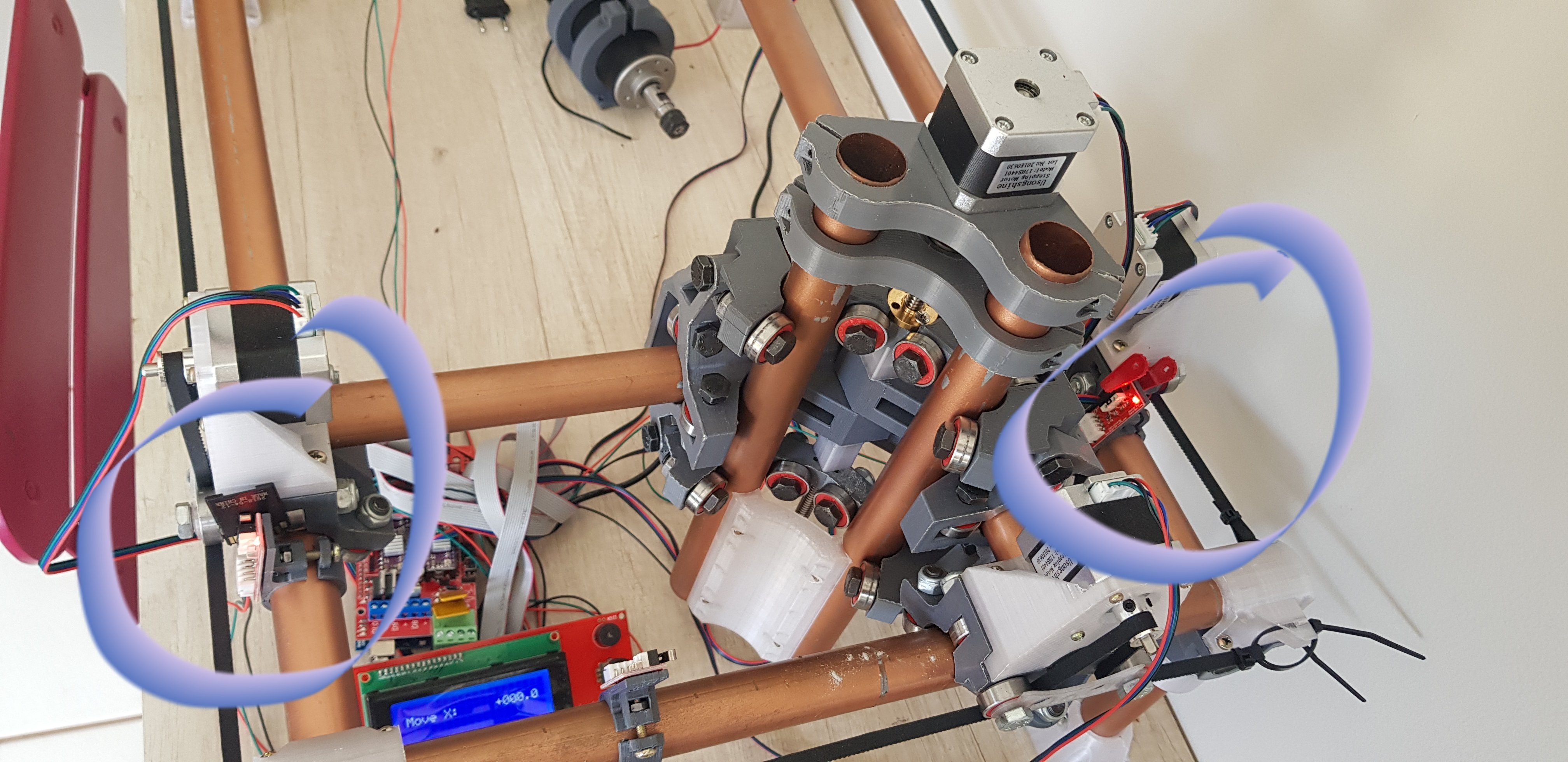

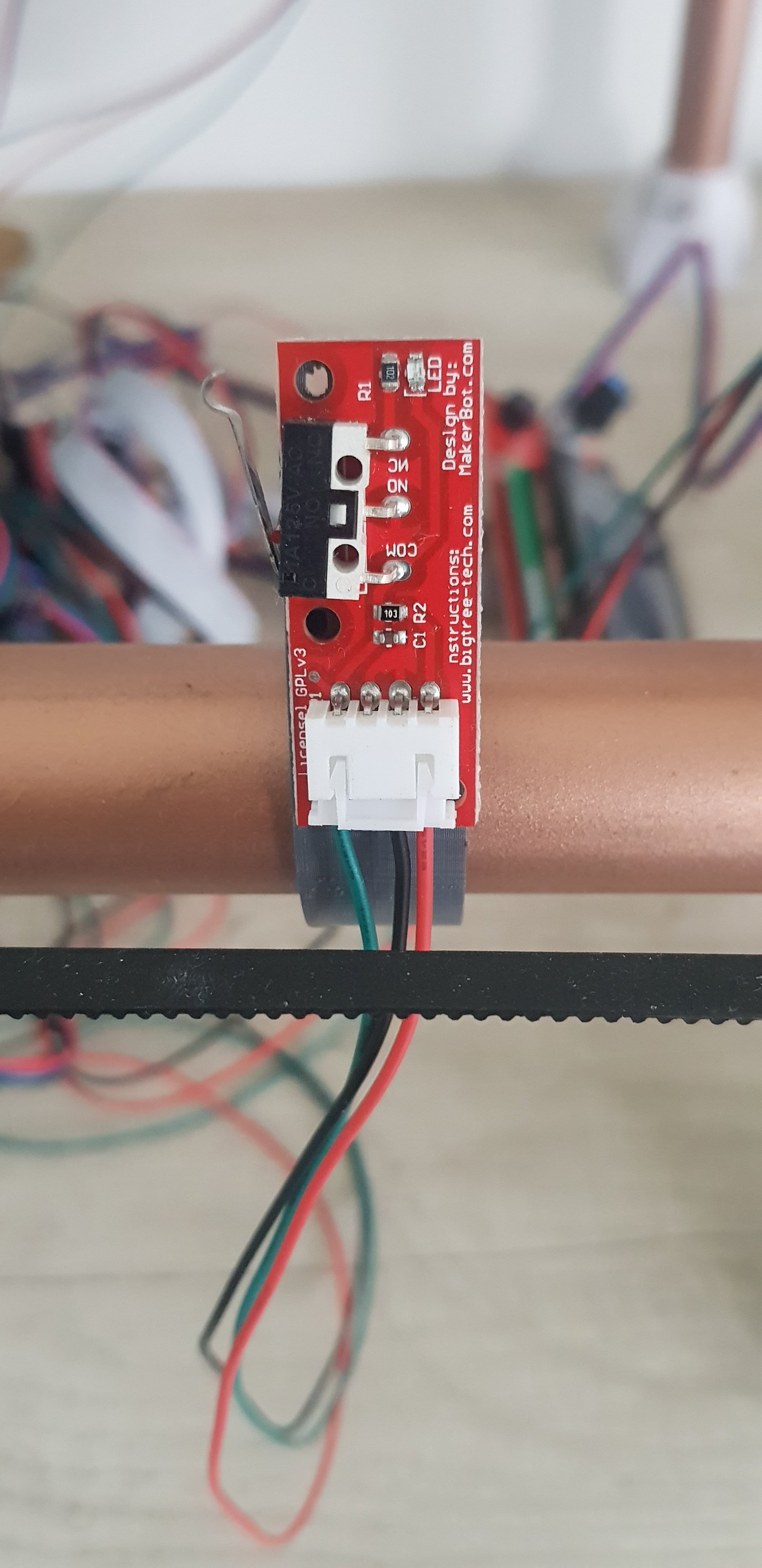

I have assembled the endstop version of MPCNC , and tested each endstop in repetier and I get the TRIGGERED status when pushing by hand and checking m119. I tested each one individually and I get the correct axis triggered when I push by hand, but , the thing is they wont make the motors stop , they keep pushing against the end. I tried to activate all 4 endstops manualy and still they wont stop the motors.
Why I get the repetier to identify endstops correctly , but not to stop the machine?
I have attached a pic of my firmware endstop config , and the endstop itself.

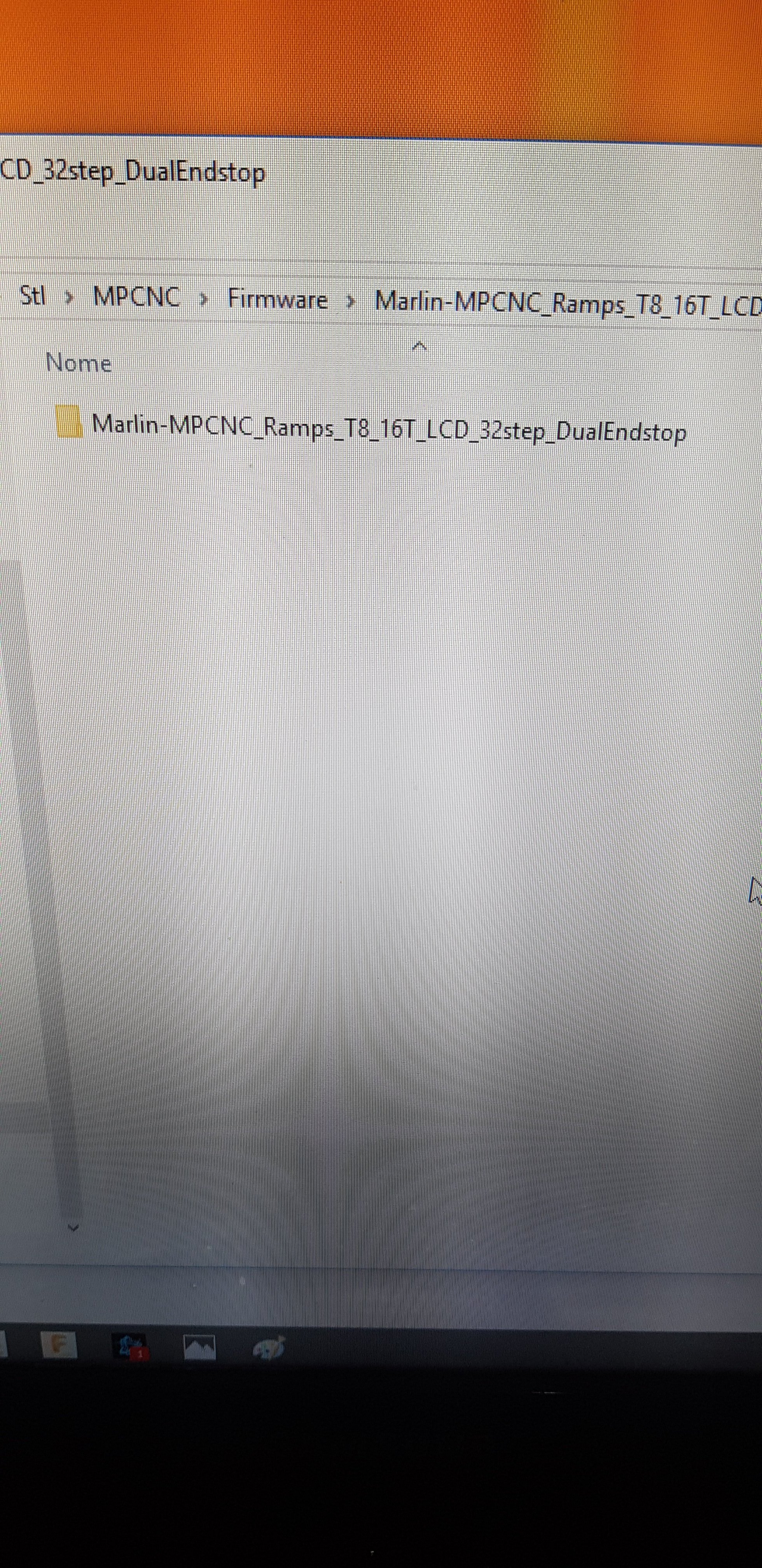

Are you using the dual endstop firmware?
Yes. As in the attached picture

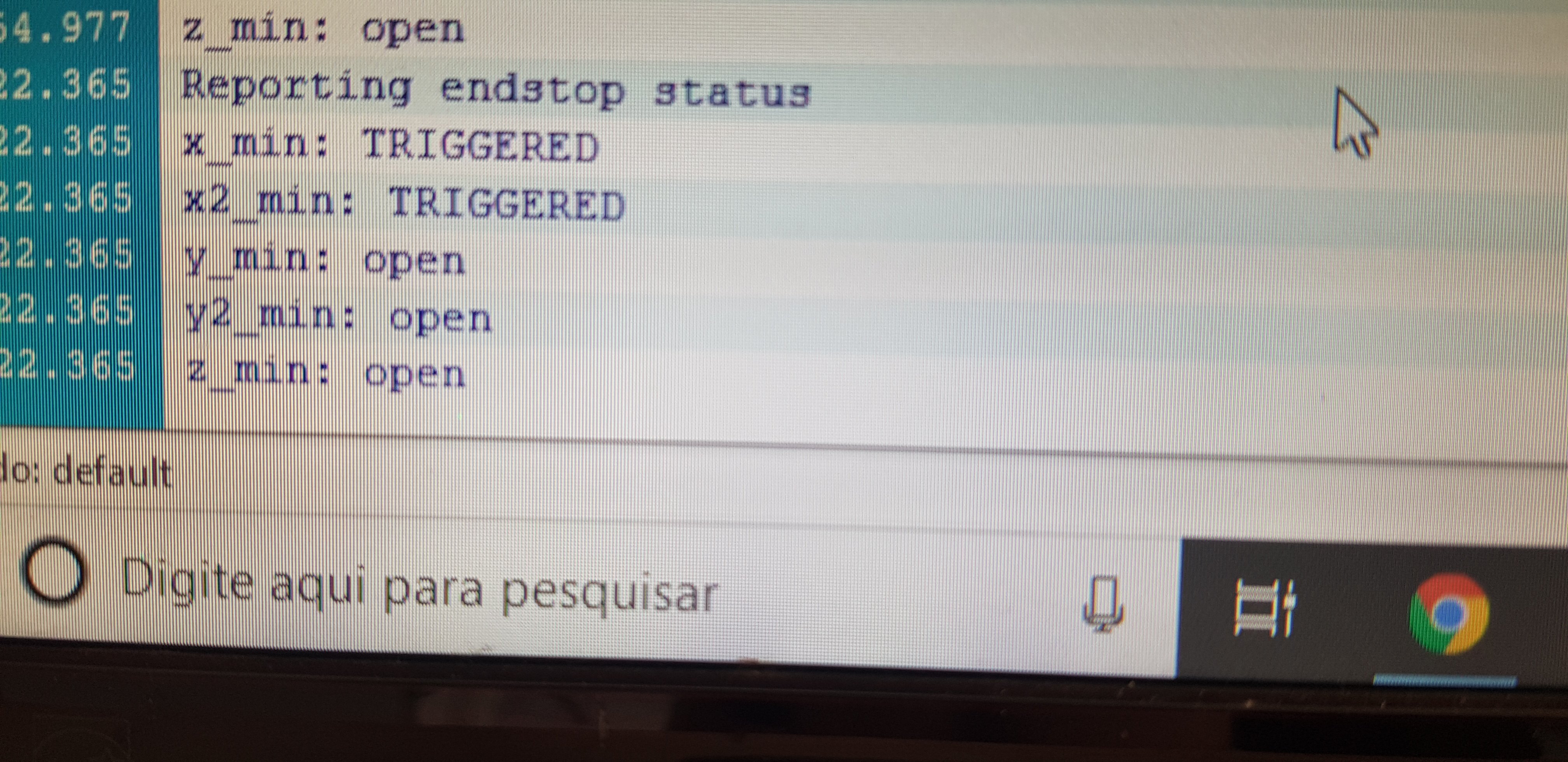

What does M119 say?
I tried g28 over repetier and still try to go over the endstop. its not stopping :frowning:
Here you can see the lights for x endstops are on, the m119 status says x are triggered …
Using G28 when both are triggered they do not back up and touch again slowly? Do thy move in the correct direction? Are you sure they are on the correct axis and correct side (extremely common to get that wrong)?
If that is not the case I am at a loss, no one has ever had that issue before.
