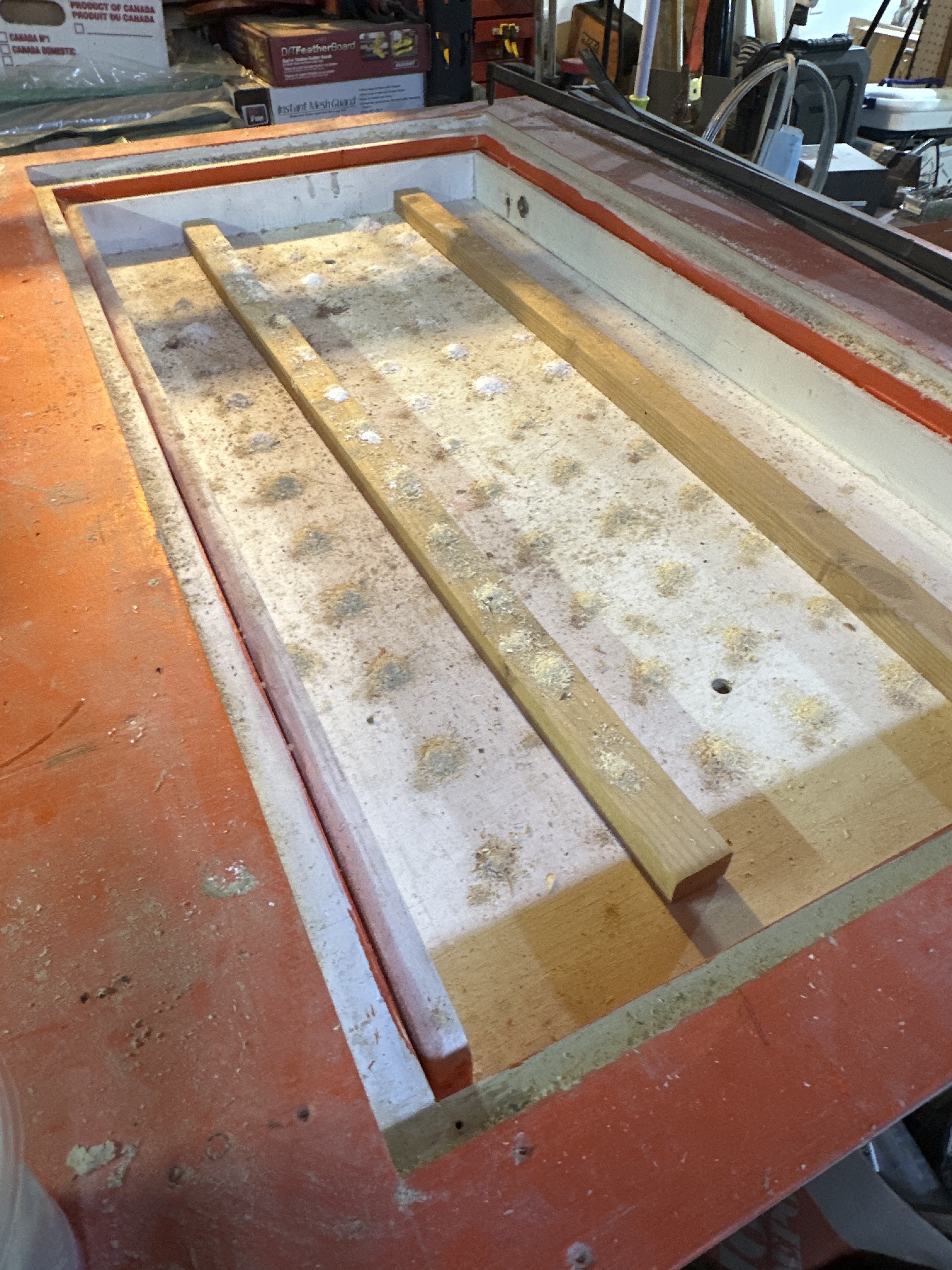

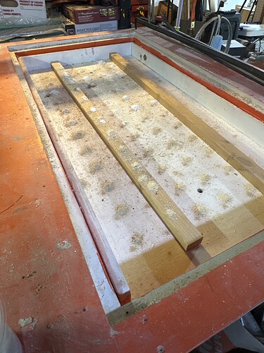

Odd how memories get formed. So many memories from this crazy grey and orange table…pulled all the nutserts so they can live on another day.
