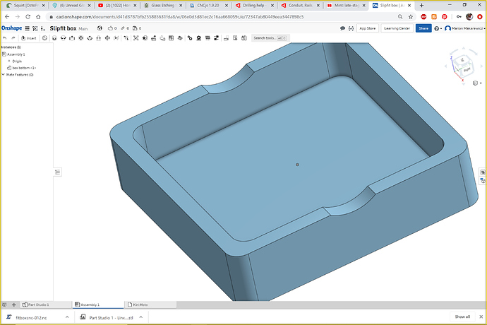

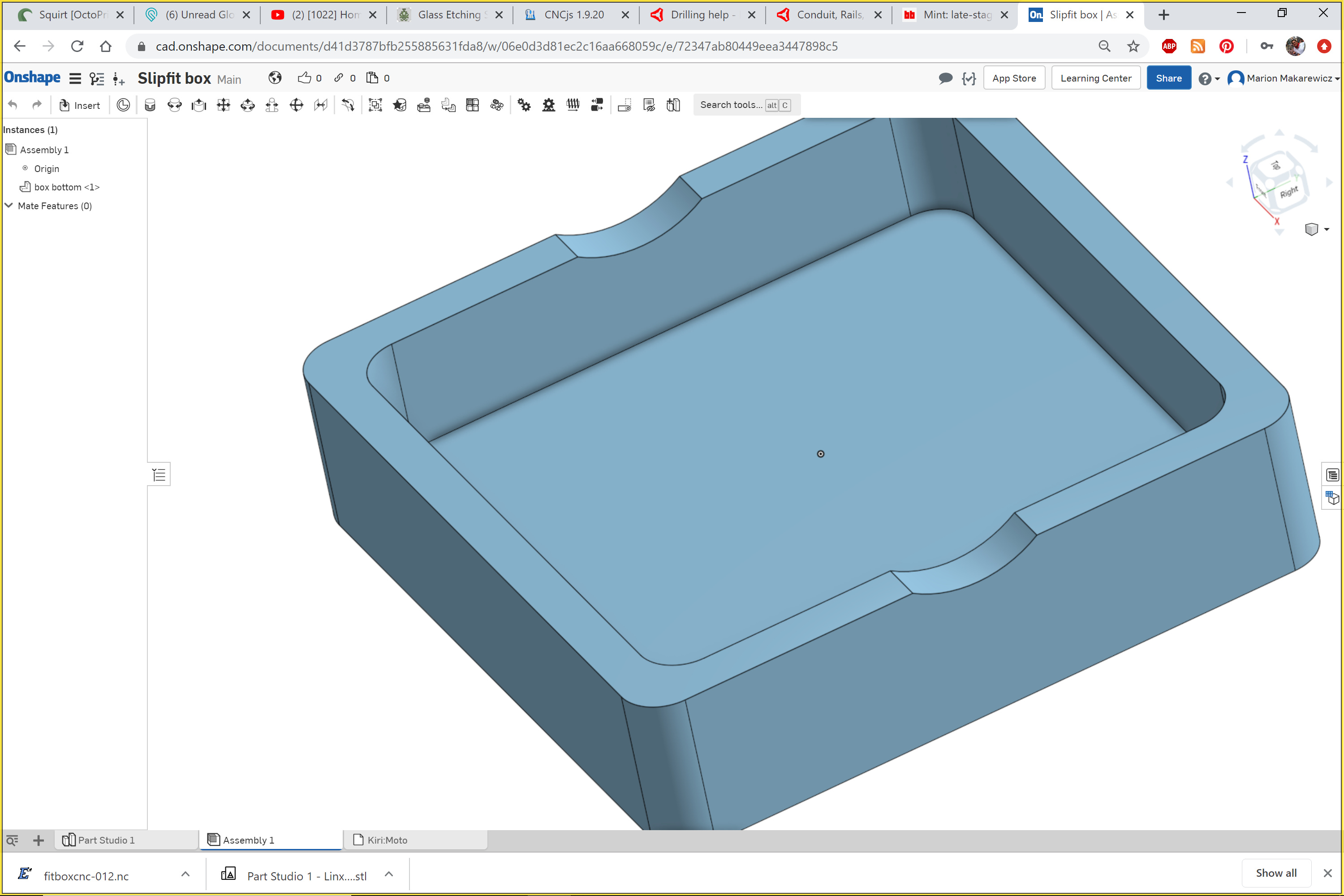

I bought it when my wait got over a minute. IGoing from Inkscape to EstlCAM for simple surface stuff isn’t bad at all. But I wanted to mill some curved slots in the tops of my slip fit boxes to make a finger hold for pulling them apart. Threw the STL in and it crabbed at me.
Played around with in in KiriMoto since I drew it up in Onshape too. Now I have to study how does one mill this part in one setup and with what bits or do I just make is a square pocket. It’s a dead simple part to make in Inkscape and to do the CAM in EstlCAM. But just adding that curve changes everything.

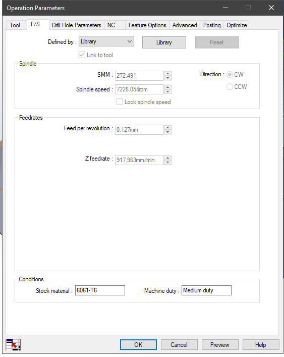

It looks like your example peck operation is running at 918mm/min => 15 mm/s, no?
Yes, 917.xx and that I saw on the bit info. Of course the M20x commands have Z hard set to 3mm/s in the above example.
To change that speed I would have to go into the library to mess with that or tell it Defined by Operation and I can change that Z Feedrate that way (much better that way I think).
