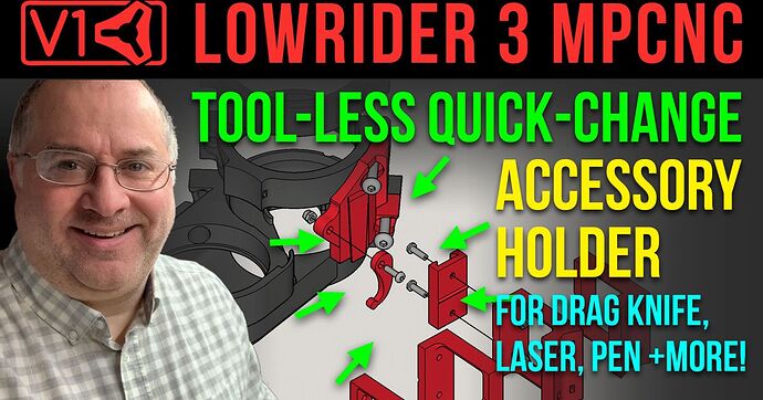

Here it is!
LowRider v3 CNC - Tool-less Quick-Change Accessory Holder (v3.0)
Take note that I’ve now made available a Tool-less Quick-Change Tool Holder for LowRider v3: [LowRider v3 CNC - Tool-less Quick-Change Accessory Holder] Download files are here: LowRider v3 CNC - Tool-less Quick-Change Accessory Holder - supports laser, drag knife, pen, etc (v3.0 and v3.1) by Doug Joseph (design8studio) | Download free STL model | Printables.com Pasted from Printables description: For understanding of how it works and assembly steps, just watch the 1-minute video…
https://www.printables.com/model/420517-lowrider-v3-cnc-tool-less-quick-change-accessory-h
