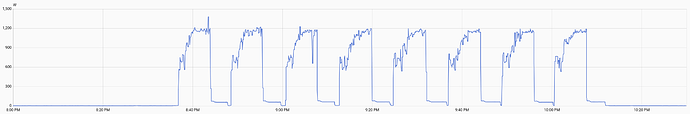

That’s the 8 batches I did on Thursday night. 5 batches of what we’ll be drinking shortly and then another 3 different decaf options to take to work as a gift for a colleague. 7 minutes averaging around 900W so ~110Wh per batch, pretty much 1kWh/kg, so an extra 8c/kg to 25c/kg, depending on when I"m roasting and whether the solar is on song or not.

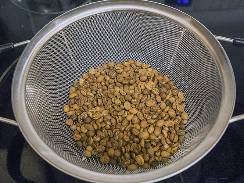

Somehow, I missed all these comments. I am getting 6.5-to-7.5-minute roasts on mine lately with 113.5 grams (4oz) of green coffee beans at a medium roast (outside temperature was about 80F). I am currently keeping a logbook and marking the temperature at every minute and also the starting outside temperature, along with 1st crack and when I pull it. This is with the flour sifter/wobble disc design.

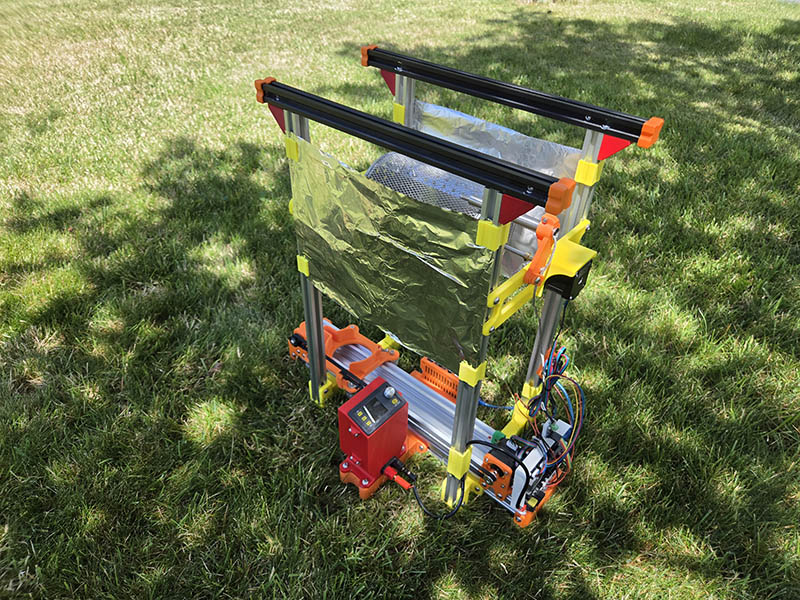

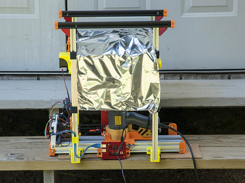

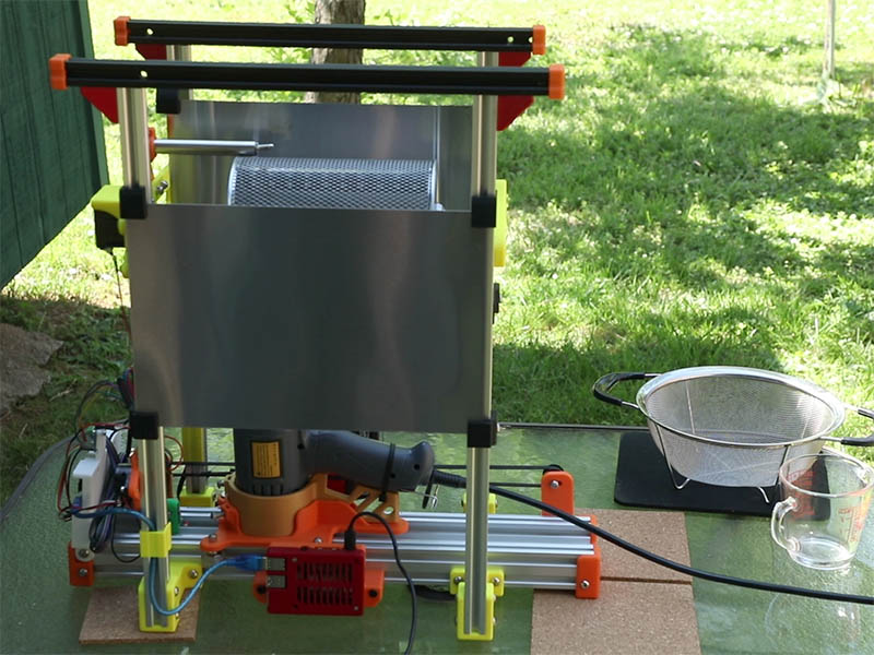

I have not tested my sliding roaster design again since my last changes as I am mostly waiting on a calm day but did come up with an idea for wind break on the sides and it should also help to keep it hotter. Here is a mockup using tin foil which might also work, but since 2 sheets of 12”x8” SS is not that much I ordered a couple of sheets. I am going to get the sheets as close to the side of rotisserie as possible. All the plastic parts are mostly away from the heat now, although the rotary motor mount and idler mount might get a little warm.

I got it pretty close to working yesterday. I did 2 test roasts. The 1st one I just had the 12x8” SS sheets on the sides and open at the top and got the thermocouple up to 190c which was 20c hotter than before. The 2nd time I wrapped aluminum foil around the top to keep the heat in better, and it did get hot enough, but I never heard 1st crack. It got to 138c (280f) in 6 minutes which is above the temperature I was getting from the other roaster. Even though the thermocouple is a similar location as other roaster with the aluminum foil in place, it makes sense that thermocouple gets hotter. Here are 3 photos. I am not sure I will proceed further from here.

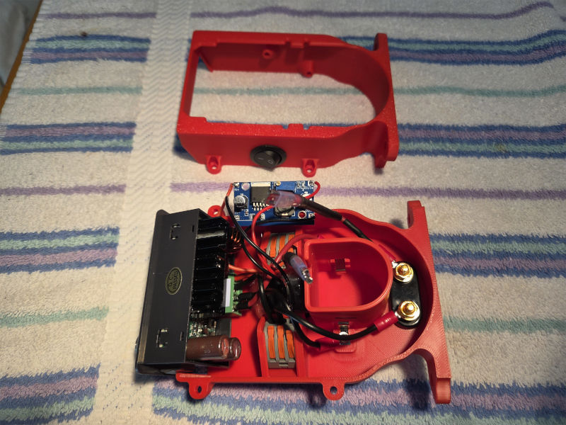

I’m going to add a USB connection to my Ryobi portable battery. I thought it was going to make my electrical connection less complicated, but the USB connection I got with the DDPS5005 Digital Control unit only allows either or connection to the USB or the 12v connection I have. It is not that big a deal to have another USB plug into the wall, but I did want to simplify the plugging for each roast. It certainly is more complicated than I first thought to wire it up, but easier setup for each roast as I can keep the USB wire connected all the time. I had to add a switch in order to cut off the 12v to the nema17 motor. I just realized I do have a button on my Arduino controller for turning the motor on/off, so that will give me 2 options to see which I like better.

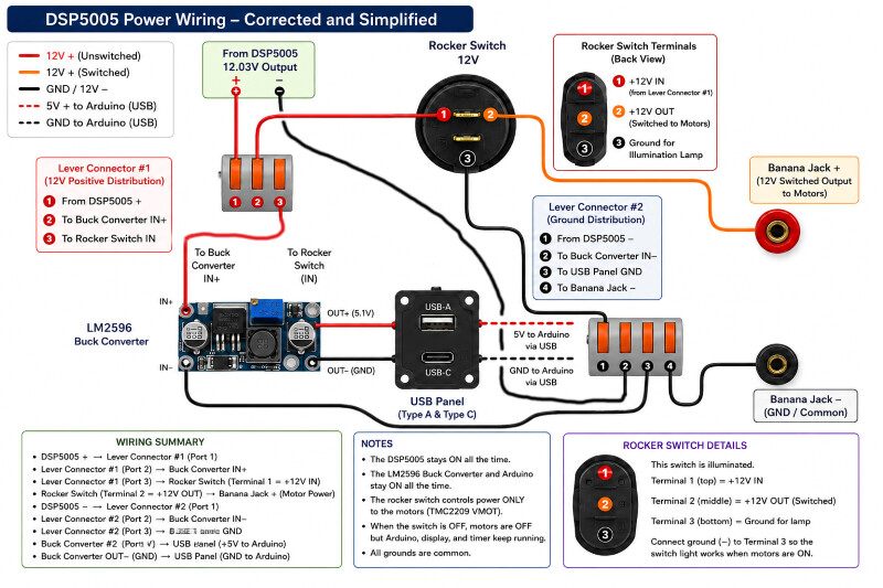

I got ChatGPT to do the wiring diagram and after 3 tries, it got it pretty close and has the correct images for the parts. I had to erase a couple of extra ground wires it put on coming off the bottom ground wire to 1 & 2 of the 4-lever connector and the ground wire from the DSP5005 to the + line. It also did not have a couple of the + lines in the right place. These errors were easy to spot and correct for my use. At least I think I have the wiring correct. I am waiting on the LM2596 and USB panel from China before putting this together. I also have to redesign the 3d printed case to allow for these extra parts.
I did see one other problem with that wiring diagram. There should be no ground wire coming from the Rocker switch. I was able to put it all together today. I had a 16-gauge wire from before for the 12v lines, so kept most of that. From what I have read 20 - 22-gauge wire should be adequate for 1 or 2 Nema 17 motors on the Arduino. If I convert my other PS, I might go to 18 - 20 gauge where the 16 gauge is to make it less crowded.

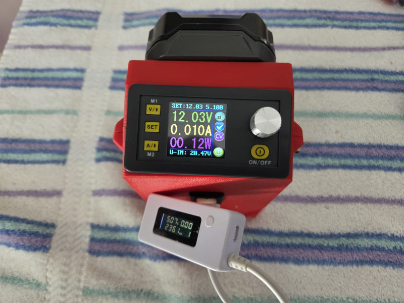

I initially set the trim pot of the buck converter to 5.05v using alligator clips off the output +/-. After I connected it to the USB panel, my little USB checker showed it around 4.7v I think. I adjusted it further with that USB display of Voltage to get it back to closer to what I wanted. Looks like it is 5.07v if that display is correct. I also checked the voltage on the banana jack with the 12.03v showing on the display and it was 13v, so I guess that display is not accurate.
[edit] Looks like there might be a calibration menu that was not in the paperwork that came with it. I will have to see if I can calibrate it to a closer value.
I used a little hot glue to secure the USB panel as I could not get a tight fit with that. I only needed 3 port lever connectors for the + and - connectors and mounted them at an angle for clearance so I did not have to increase the size of case.
It turns out the DSP5005 display was correct and my 19-year-old GreenLee DM-20 meter was off. It was way off because the meter’s 9v battery was down to 6v which is my fault for not noticing that low battery on the display. Using the multimeter I bought last fall, that measured exactly what the display had. Replacing the 9v battery it was still off about 0.8% off showing 11.95v instead of the actual 12.05v. Think I was still in the mindset of using the old meter which is why I was not using the newer one.
Yeah, that’s a common issue with cheaper multi-meters. I have a couple of Uni-T ones that I use as ghetto dataloggers and they have a habit of going a bit weird with low batteries. Inaccurate and fluctuating readings. At least in your case it was clear that the batteries were low!
I’ve never had an inaccuracy issue with my Fluke or HP/Agilent/Keysight meters, right down to the meters refusing to turn on. The batteries also last MUCH longer in them, interestingly.

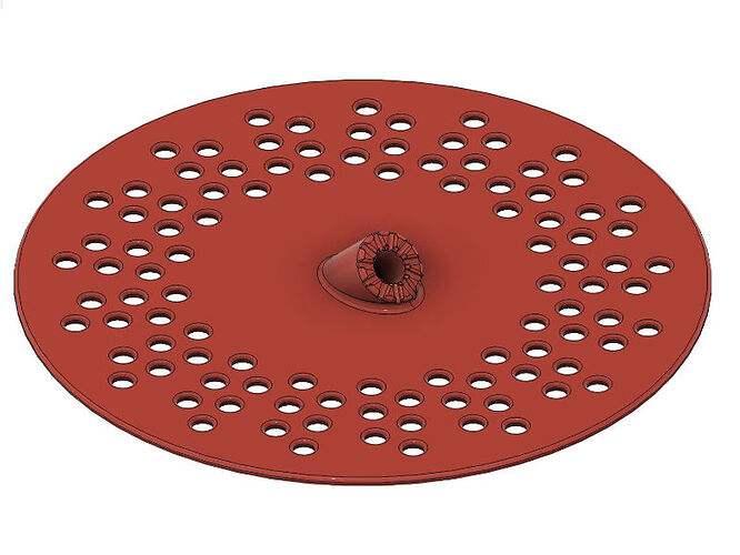

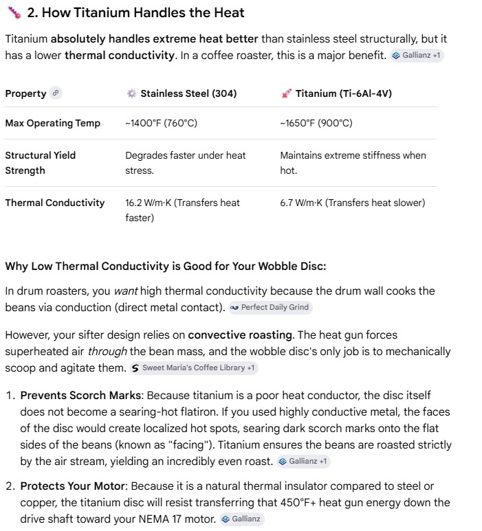

I might be going down the metal 3d printing rabbit hole some more and reprint this wobble disc in titanium. I had not thought of using titanium before, but it does seem to be food safe. It is more expensive, but the weight is about half that of the 316L SS and has some other good qualities. I have the price down to $92 before shipping. I changed my design to use M6 threaded rod and added dimples for the serrated washer to connect better. I also changed the thickness from 2.0mm to 1.9mm. Probably could go to 1.8mm.
I started down this rabbit hole when looking at flat burr coffee grinders. There is one that has an option for SS or titanium coated burrs.
Here is a screen shot of the modified wobble disc. The only visual difference is the bumps for the serrated washer to grab.

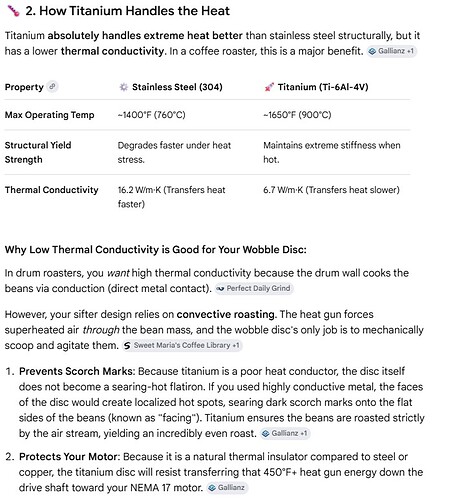

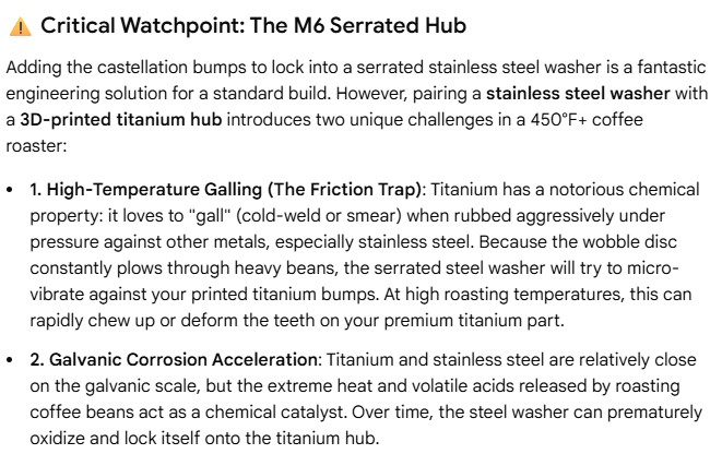

Here is what Google AI says about using titanium here.
Looks like I will need to switch to titanium nuts and washers according to Google AI. I had not thought of that being a problem.
