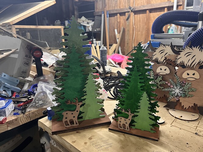

Here are just a few of the things she has made…
There is no images visible right now?
EDIT: Now they are showing and they look great!
Yeah I typed that post from my computer, then went to it from my phone to edit and add the pics. And of course any time i try to add more than one pic at a time it fails so it takes forever LOL
