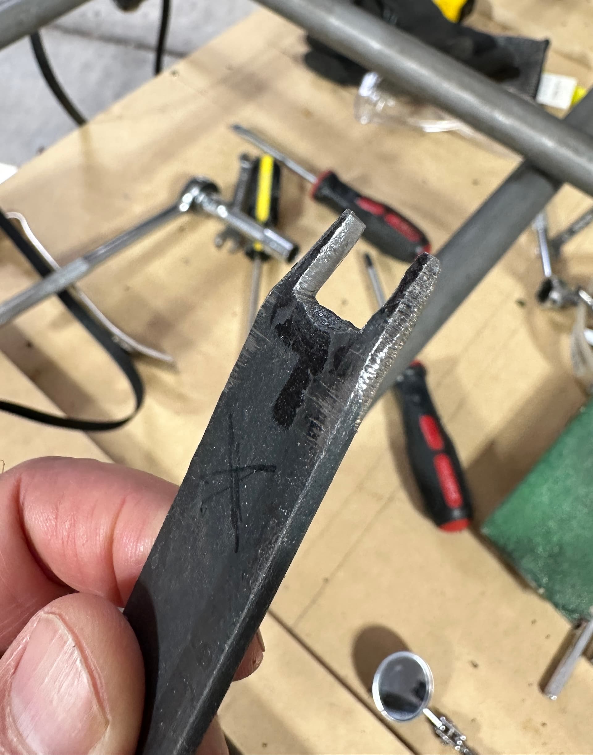

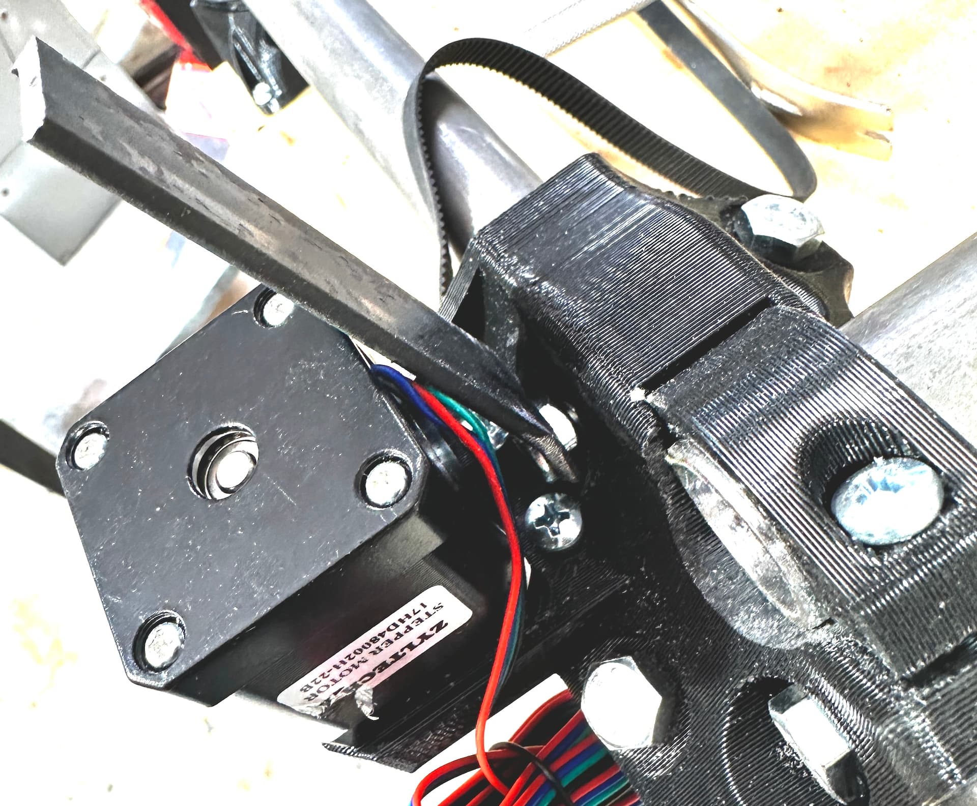

This is a little different from other squaring topics. I simply could not get my wrench on the tension bolt of the trucks because the stepper motor and heads of the bolts for the idlers are in the way. I did solve this by making a special tool out if a 1/8th inch thick, 21 mm wide piece of scrap steel. I had to drill a 1/2 inch hole in the end, square it with a saw, file it to just fit the 13mm nuts, bend it a little, file the sides a bit, and it worked but a bit of a pain. In the next redesign please provide enough room for a standard metric wrench to get a grip on the bolt. Here the tool and tool in action.
Hasn’t been a problem for me at all with a normal wrench, but it was fiddly, I’ll give you that. Since the LR is the focus at the moment, it might be a while (if ever) until a new version of the Primo will be released.

I understand and if no one else has had this problem I would also give it low priority. I think the dimensions are very close, however, so slight changes can make the task difficult. I notice my new metric wrenches are a lot chunkier than my old Imperial ones. Also, I printed all the parts with a .8mm nozzle for greater speed of printing and strength. Yes, it makes things a fraction of a mm tighter but I just drill out the holes and I had to do just a little filling to the the rail tops to fit right. Also the hexagons for nut capture are sometimes too small but I just heat them with a flat soldering iron and they slip right in.
In any case, I printed my solution in case anyone else has this problem. Thanks for the quick reply.
