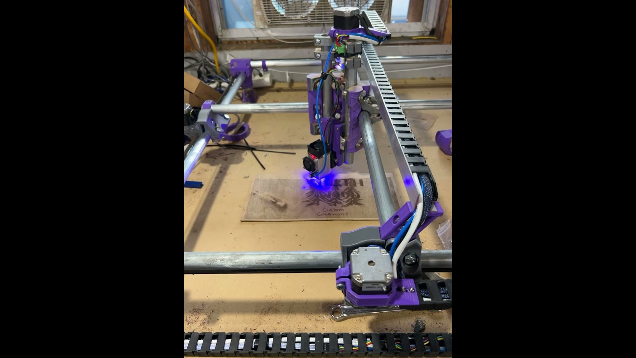

Thanks so much for the help @jamiek That was defiantly it. The laser lights up now! And now I realize I have absolutely no clue about running a laser LOL. Oh well that’s tomorrows task. All day in a 100° garage has me whooped.
Also Lightburn will only connect over WiFi. Still no USB. Not sure what to do about that one.

I will say hopefully next time I’m home I can figure out the USB. I’m running a raster image right now and its slower than running a carve with a spindle LOL

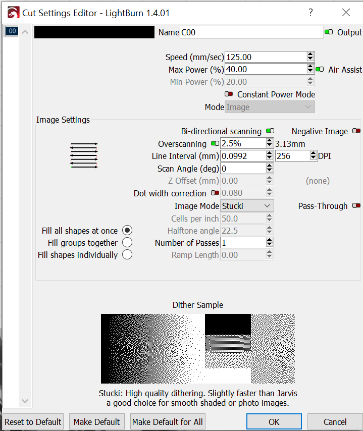

Raster (M4) worked more than 80mm/s for me with a 0.19mm dot size in AP mode. What are all the rest of your settings because you should not need a direct connection for a really really decent speed. but if you have a 0.019 dot size it will take 10x the time.
I have no idea what the dot size is. But lightburn thought it would take 1hr 10m that was an hour and a half ago and its not even half way yet…
Screenshot your lightburn settings for the burn you are doing.
Ok just figure out to see what the dot size is. .0992 or 256DPI is the default. So I guess next time I need to change that lol. I still would prefer it hooked up USB and turn off the WiFi
You can but then you run into computer issues and sleep stuff since it is actually sending commands, with wifi you just need to hit start.
The real use for a direct connection is the calibration stuff in lighburn, not actually running files. Burns are very long and I would always do that from an SD card.
This is what I should have done but didn’t think about it till after
I would get at least 5mm of overscan.
Your tops speed is probably too fast. You need to feel the steppers they should be absolutely smooth from one end to the other if it stutters in any way it is too fast. You will be at 60-90mm/s.
You are using dithering, that is probably not a good idea. that is a lot of dots you are not taking advantage of M4. Try grayscale you should get a better image and faster speeds without stuttering.
Your speed and power are odd to me, 40% at 120mm/s means you are not getting many grey values. you should run the grayscale calibration.

ok…don’t know anything about this. I see where it says it now but have no idea how to change it. I had her make it a gray scale image before I tried to do it.
I ran this from the computer in the garage. inside now where there is AC lol. I believe I set it at 70% max power. And yes I probably should run a grayscale calibration. I did not do that before. Too excited to see it working LOL
