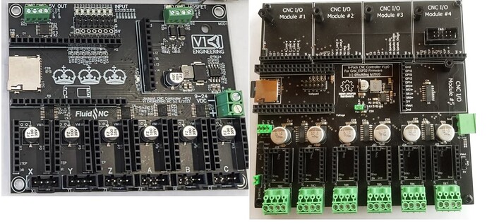

So it looks like you changed some things but not others. Any insight?
The 6 pack is a dev board so it is showcasing everything a fluidnc board can do…except 2209’s. The main difference is this is designed for 2209 drivers in UART mode (full control other than sensorless homing). From there we permanently added two endstop modules, a 5V out mosfet board, and a full voltage 2.5A mosfet out board. That is 4 modules and leaves one free to expand with things like Jamie’s Pendant module.
So it is basically a decked out 6 pack board with the things we use. That saves a ton of money and space. I hope to get these out fully loaded with everything for less than the naked 6pack board. Worth the effort.
