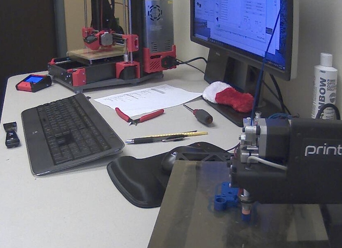

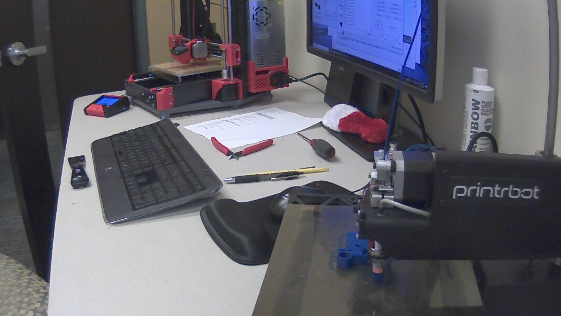

Putting the MP3DP to work. This will be my 3rd 3D printer. I’m ready for number 4…
