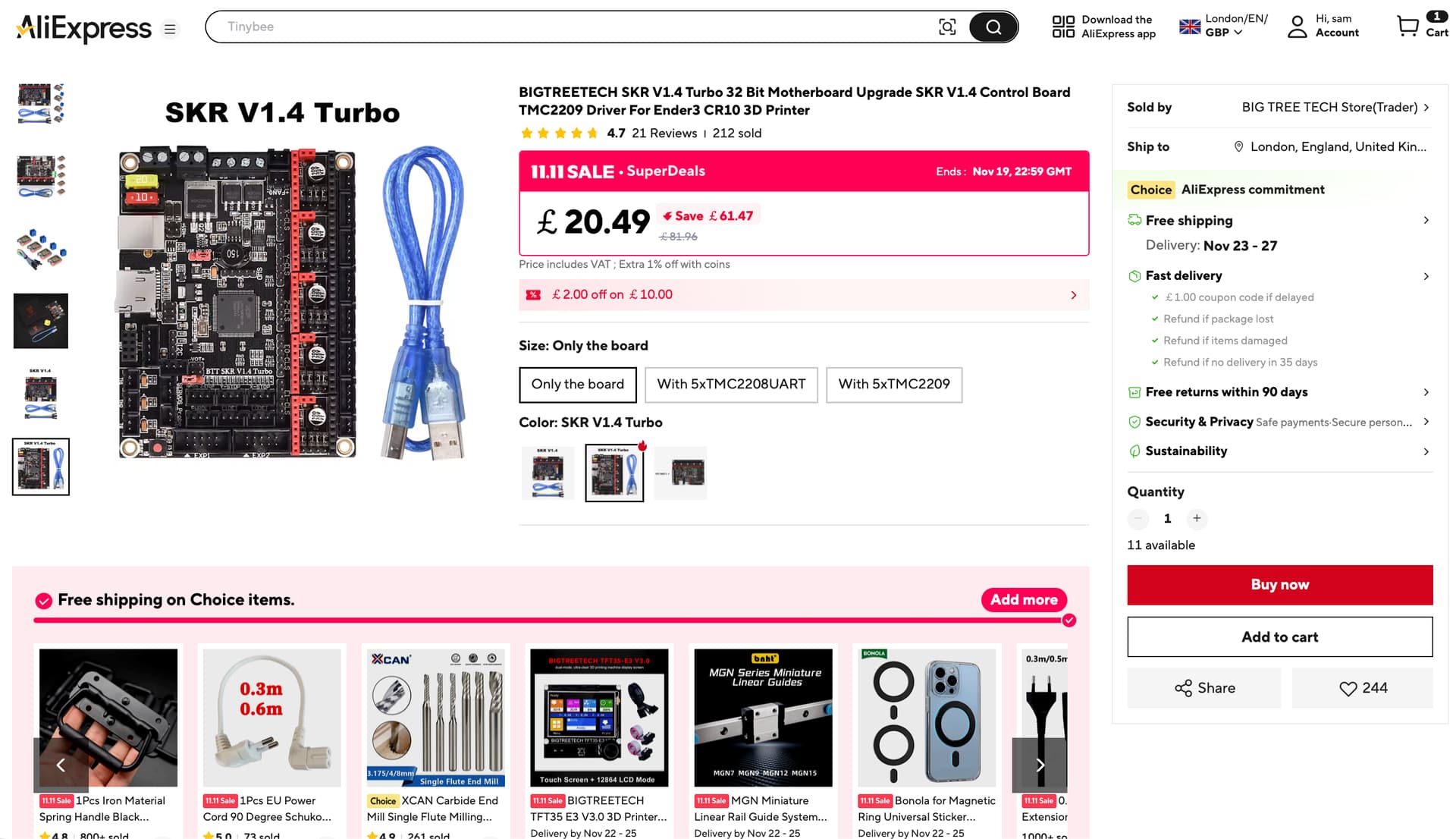

Ah - excellent - can I ask where you bought the skr turbo 1.4 for that price?

Also, as others have asked… Where’d you find the SKR Turbo 1.4 for £22 ?

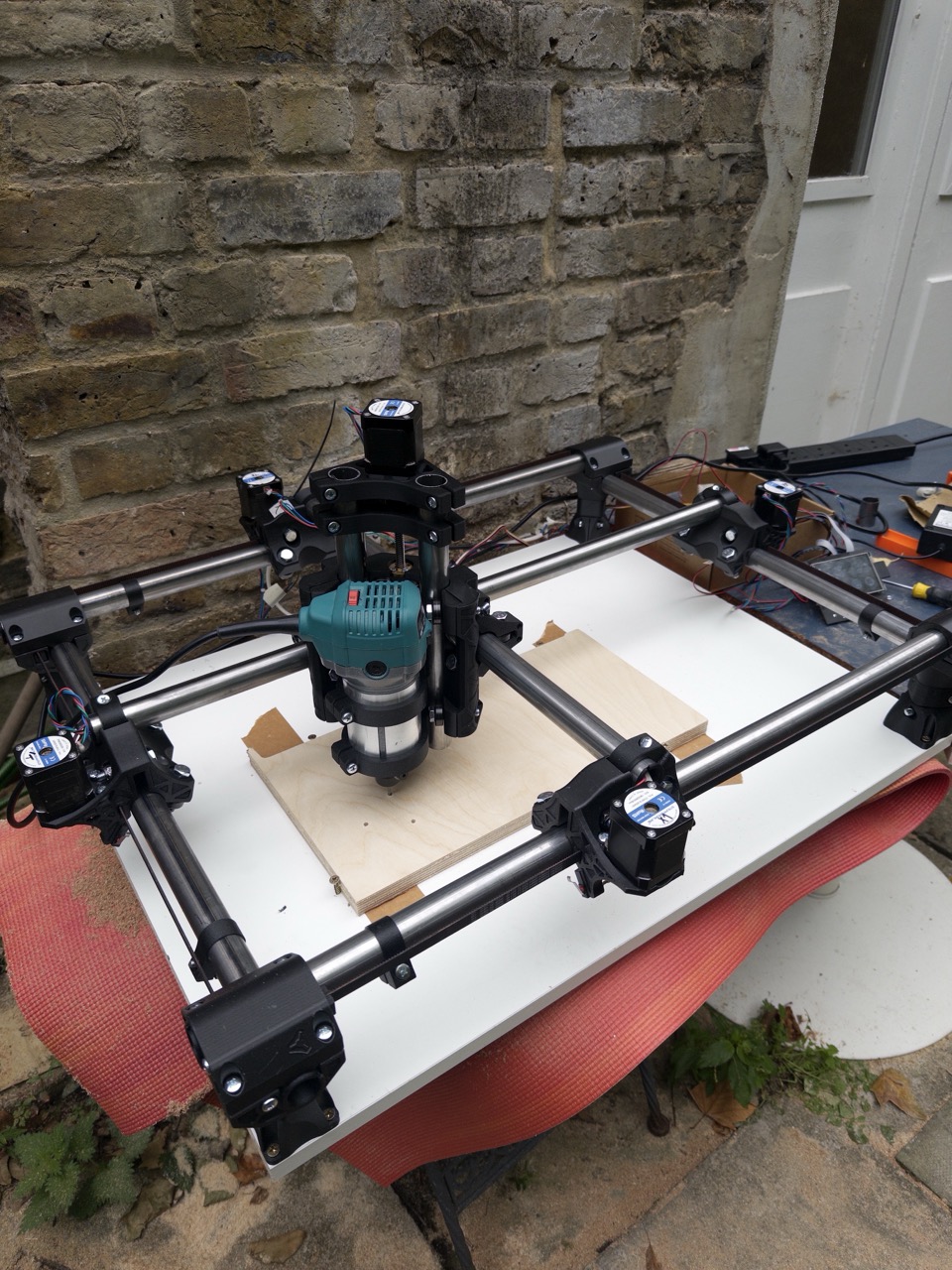

@MakerJim I’ve not kept my build thread up to date sadly.
I rebuilt my burly into a Primo about 1 month ago. But I’ve now realised Lowrider is a much newer platform and I’m planning moving to that soon. The cable management on my primo is a nightmare.
my primo, roughly 300x500mm.
I got my SKR turbo on aliexpress. if you make good use of the coupons you can get some stinking deals. It’s now the 11 11 sale so SKR is even cheaper.
