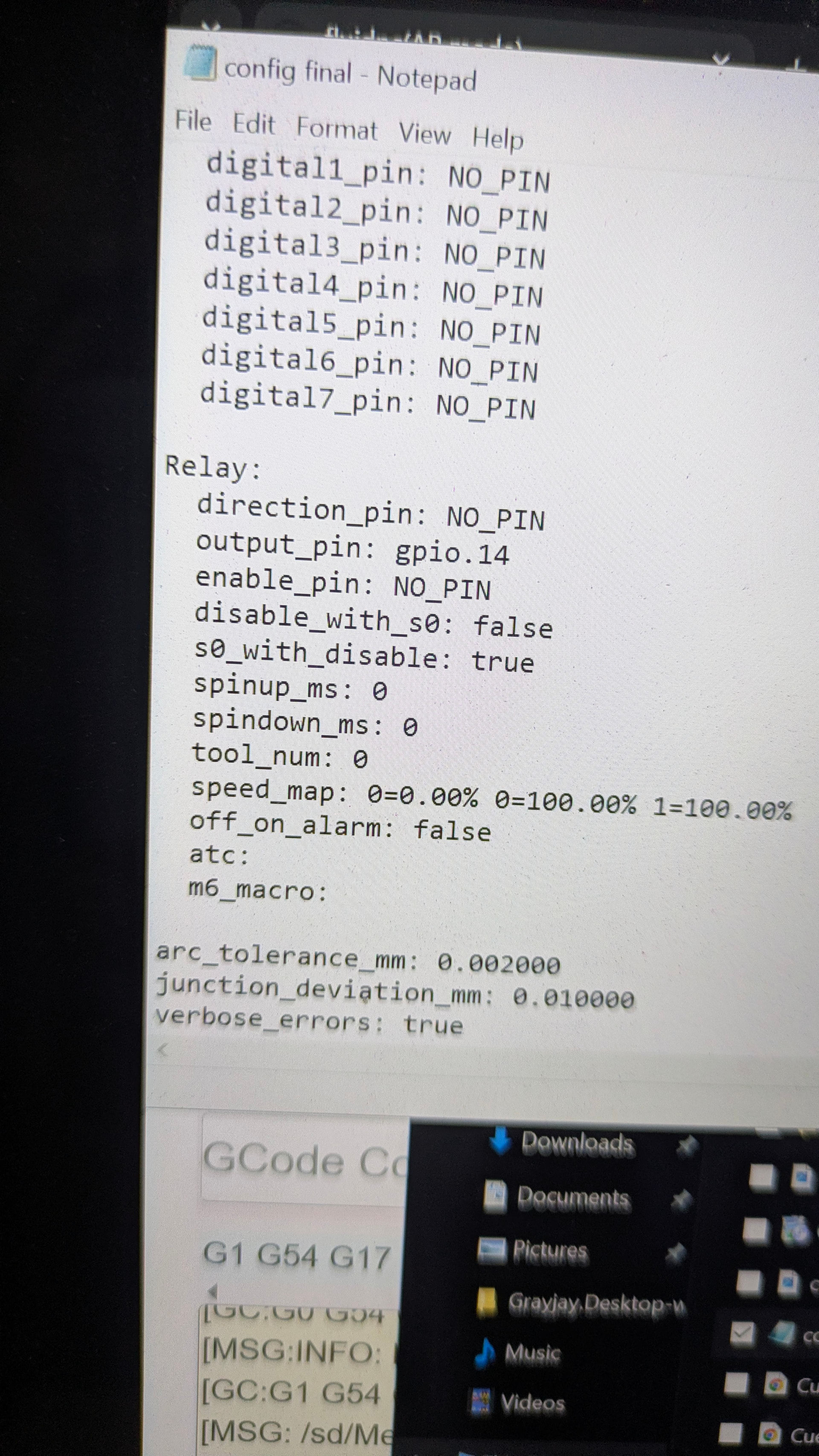

Your relay section should look like this with the gpio output with the pin you want to use. (Since that 5v pin is pwm idk if it is going to work. My jackpots are running with the official relay and rs485 modules)

What you are showing is no help to me, I don’t what I am looking at. And if I did know what file to open in Notepad, I would have no idea what to change it to.

Now you need to edit your config.yaml to make the output work with that gpio so Fluid can make your m5 commands to use that as a signal.

cesar is correct edit config.yaml
need to post yaml file
I give up. Just not going to use I/O to turn the router on/off.
Editing the config file is something you can do using the webinstaller, it isnt hard. You have to do some edits even for squaring your machine. Even the io modules that work on the expansion port needs that
At the very least, it’s not a bad Idea to familiarize yourself with the yaml file. The yaml file is, for lack of a better term, the bridge between the software and the controller’s hardware. It tells the software what hardware is available and how to use it.
I am familiar with the file. I did the edits required for squaring the machine. The difference was I had instructions to do it. After I took the measurements, I had the procedure to open the file, change a specific element to the new value, save, close, reload the new file. Yes, that was easy. But in this case, I don’t know which element needs changing and what to change it to. All the feedback that I got was, just change the file, its easy. I’m a newbie and just not that comfortable changing such an important configuration file by trial and error.
