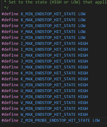

is it me or do we have the logic backwards here, with an NC switch attached I see 0V and for a pullup that is what you would expect to see with a closed switch. When I press the switch (i.e open the switch) I get 3.3V. So the pullup is working as expected, so for triggered logic they should trigger on a high signal and not a low one.
you can see here the logic is set to low
im just wondering why pronterface is reporting x2_min and y2_min, we have defined these endstops in Marlin as X_MAX and Y_MAX
in configuration.h
in pins we set the dual enstops as X_MAX and Y_MAX
this lead me to looking through configuration and configuration_adv for X_MAX
in configuartion_adv I found this snippet of code regarding dual endstops
where I underlined was commented out, I uncommented this and flashed the board with the new bin file and hey presto we now have M119 reporting each endstop correctly :grin:
so to get endstops working correctly I had to set hit states as high to work with pullups and NC switches and uncommmented these lines and there we go, all is well with the world. I can now set this up with the MPCNC and start squaring. Thanks for all the help lads, hopefully this will help someone else down the line
