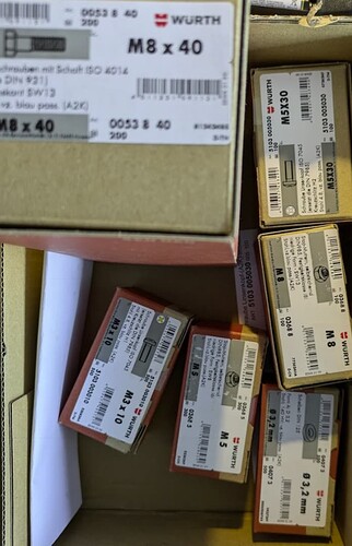

I think i make a few builds :slight_smile:
