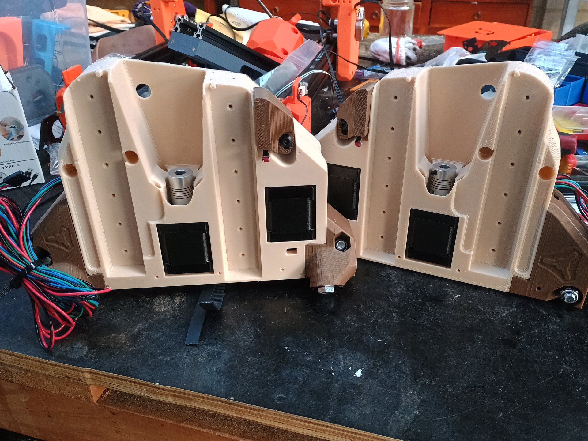

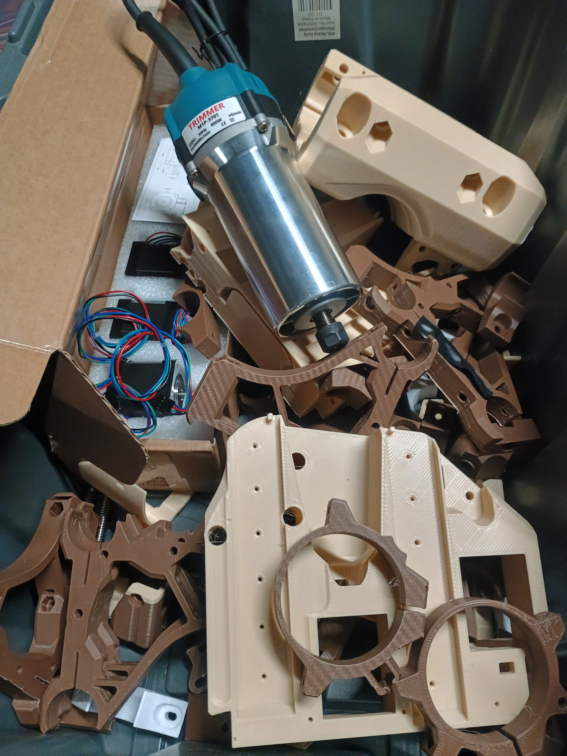

Finally got all main parts printed for my LR4 build. I am calling this colour scheme ‘Chocolate and Caramilk’. Final work area will be in the realm of 2000-2200 x 850. Its going on my existing work bench and I guess I will have to build a new work bench. At least I can CNC some cabinetry to go underneath.

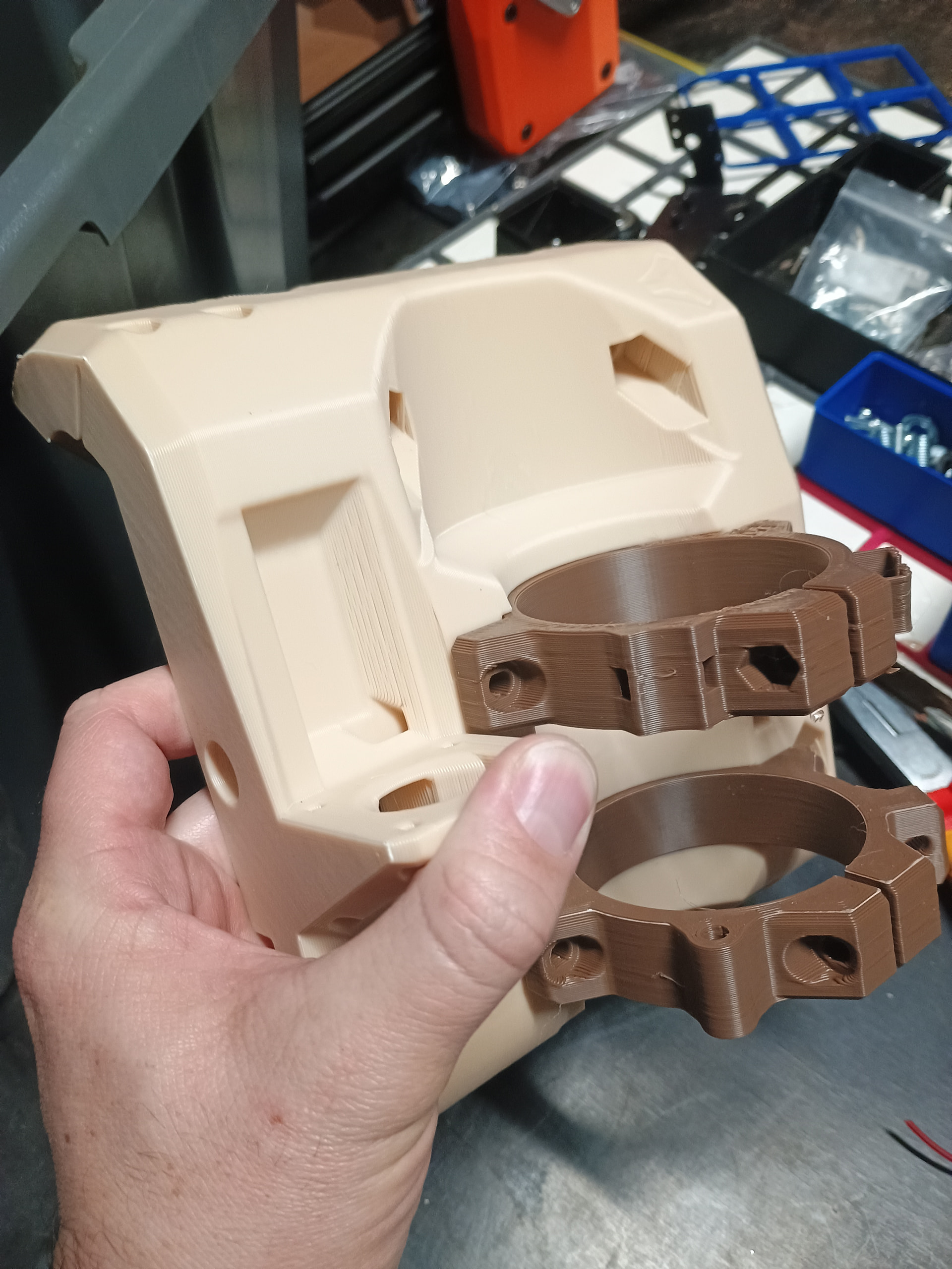

For those who don’t know, Caramilk is a caramelised white chocolate we have here in Australia (Not sure if it is popular elsewhere) and its colour is very similar to the beige I am using. Both filaments are Jaycar’s own ‘Slic3d’ brand of filament. My steppers are here as is my TwoTrees 800W router (which appears to fit the Makita mounts perfectly in case anyone is searching this forum for an answer). I am waiting on jackpot v3 board, belts, pulleys and bolts. Hoping to have the build together in the next month or so if everything arrives and goes to plan. I have ordered an aluminium sheet to make the xy plates myself.

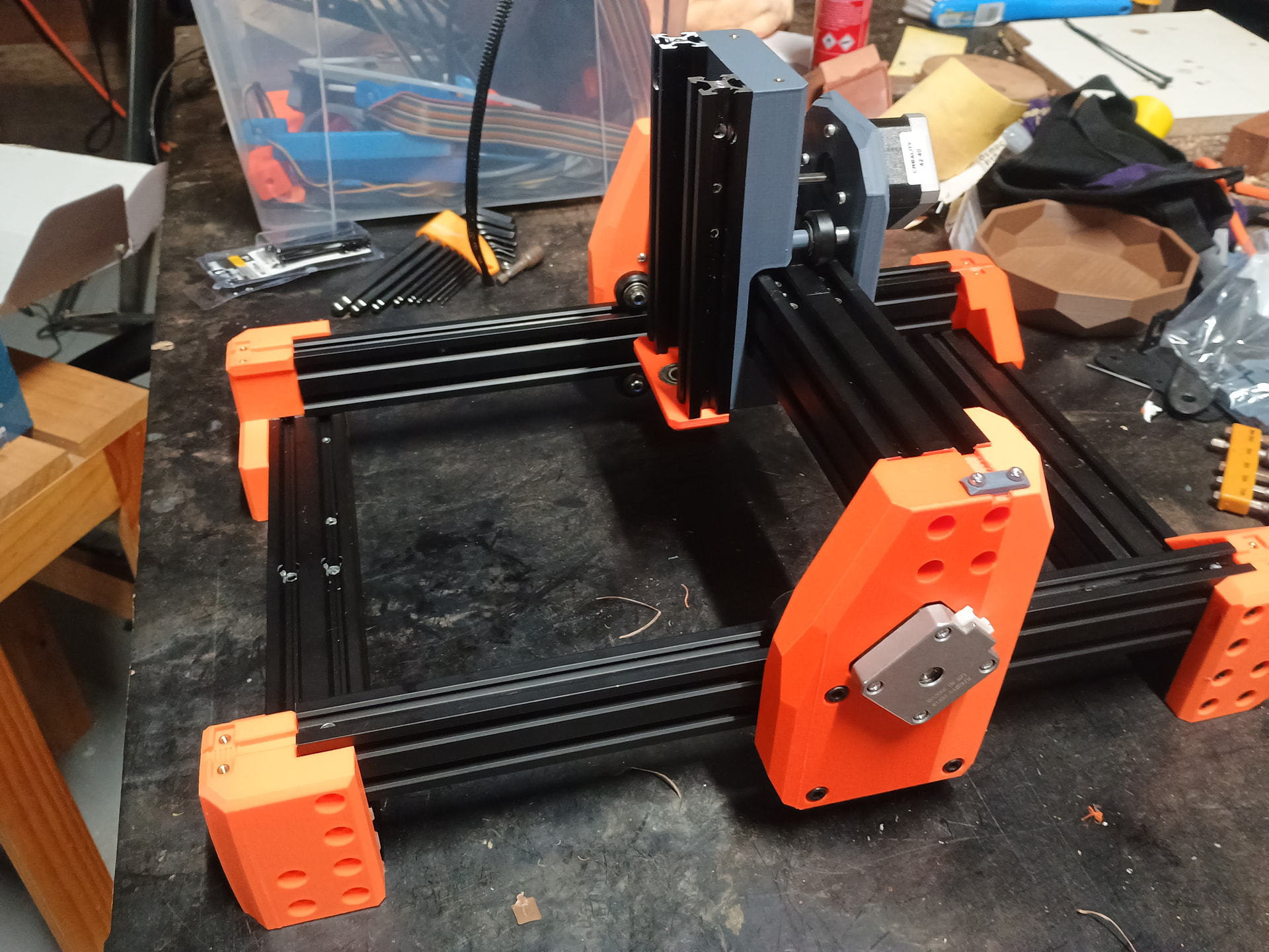

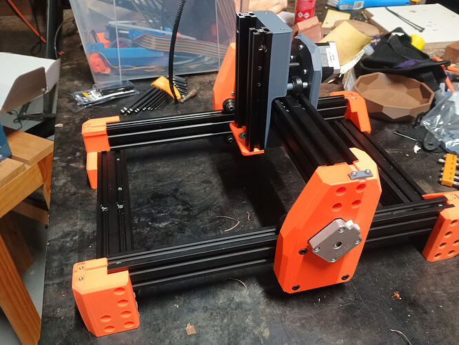

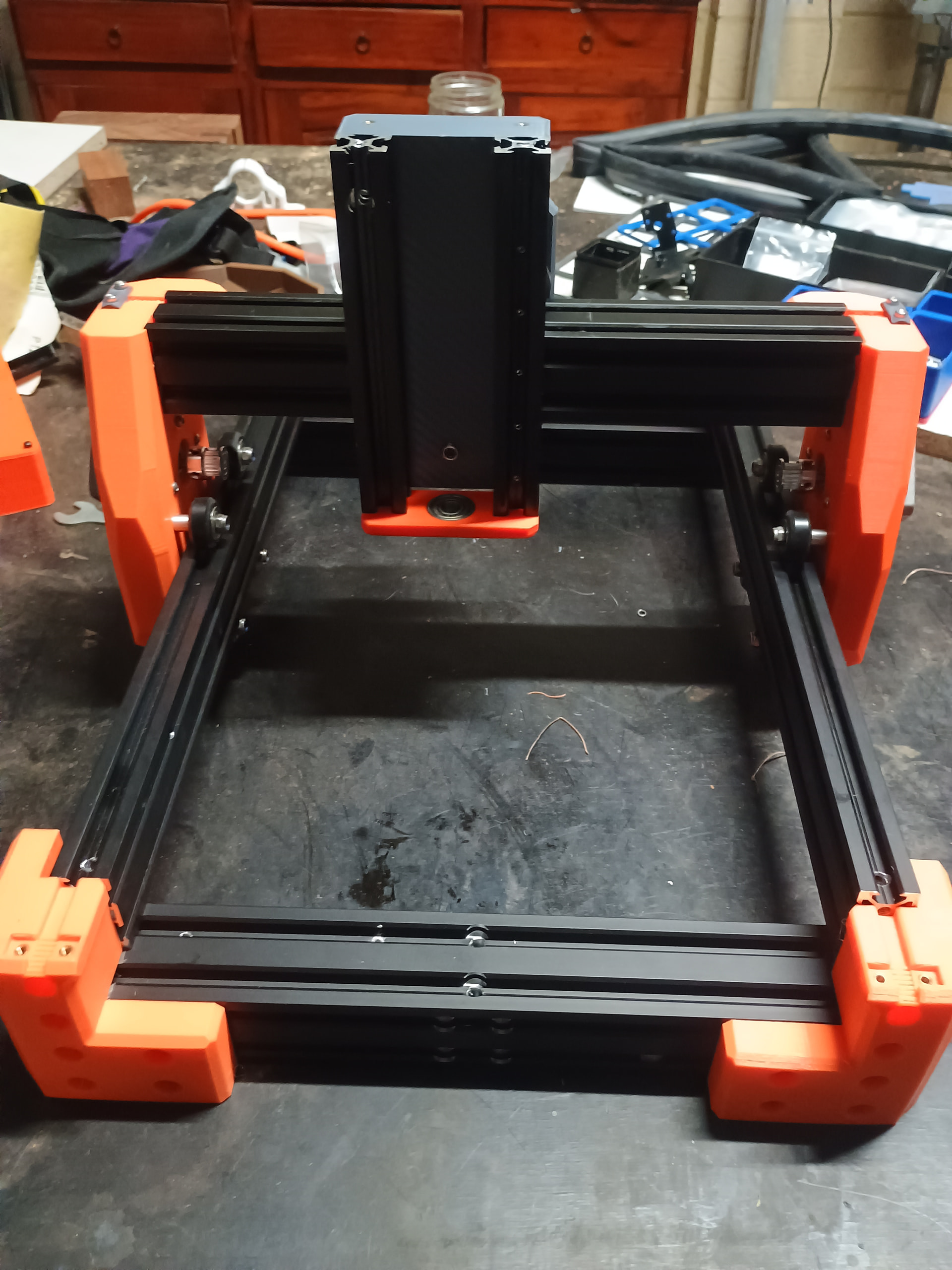

I am actually also in the process of converting my Ender 3 V2 into a CNC machine following the E3CNC builds that are available online. Much smaller work area and I intended to build it then build the LR4 if I made use of this one but I got stuck waiting for parts for this and ended up ordering my LR4 parts before this was even complete. Hoping this can machine the aluminium plates for me, otherwise I will use the Makera Carvera at work but its going to be a slow process I think. Pics of the E3CNC below
I have no real need or use for either of these CNC machines but building is half the fun, then figuring out what to make so I can justify it is the other half right?
Looking pretty good. need to paint that router to match now.
Yeah I might need to print a cover plate for it haha, it’s going to stick out like a sore thumb. Side note, there’s an Aussie owned filament supplier that has specific colours to match makita, dewalt, ryobi and Milwauke tools which I thought was a pretty smart idea given the prevalence of 3d printed tool accessories these days.

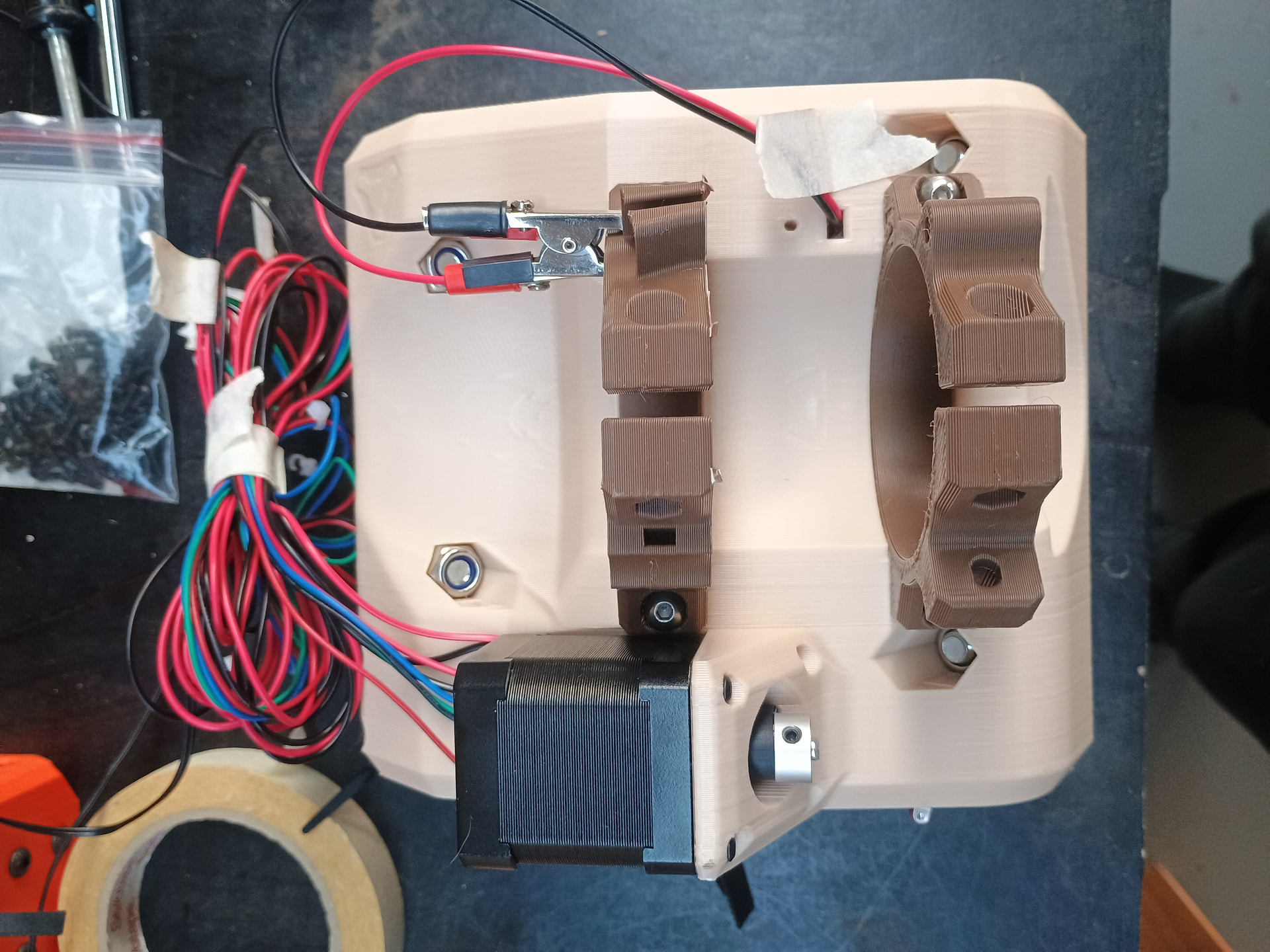

Well I have gotten about as far as I can for now. Waiting on linear rails, which I also need to finish the small E3CNC so I can mill the plates for the LR4. I have enough spoil board to cover 2/3 of my table for now and will probably just stick with that for now. Will collect my steel tube and MDF for the struts this week so I can at least continue with the bench while I wait for parts.
I have to say, very impressed with the way everything has been designed. You can tell a lot of thought has gone into to with the cable routing, mounting pockets etc. Its been very enjoyable building it and not wondering why the hell a certain design choice was made. Everything seems very logical and well thought out!

please tell us about your touch plate?
I haven’t got a touch plate sorted yet so just ran some wires and connected to alligator clips. I was thinking of making an aluminium xyz plate I could clip to for accurate origin point. Otherwise I’ll just go with a feeler gauge or something similar like I’ve seen on the forum.
