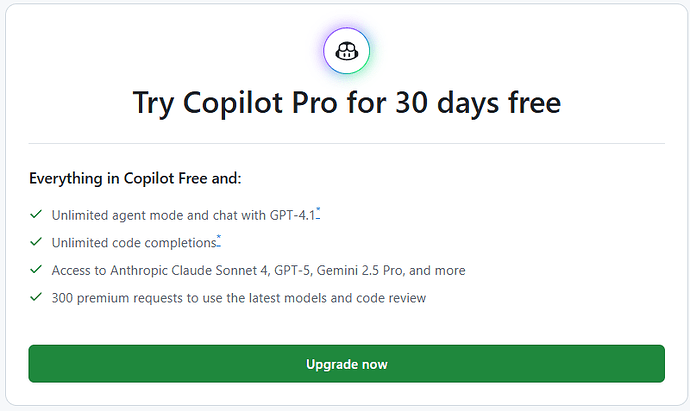

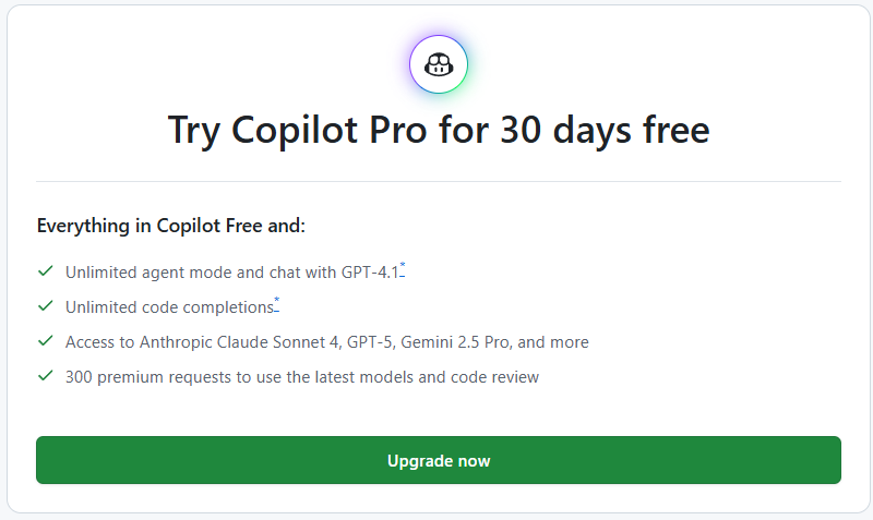

OK, so ANOTHER awesome option was sitting under my nose!
When you fire up VS Code, there is a thing sitting over on the right called Co-Pilot or some such. It’s a code writing agent that is amazing, and just works. I just now started using it, and I’m very impressed. I did not have to register, sign in, create an account, give a credit card number etc. I’m scratching my head. Maybe I will hit some usage limit and would have to pay to continue? Or is this just free all the time?
Well… I asked Gemini AI about it, and this is the reply:
The tool you’re using is GitHub Copilot, and you’re right, it is an incredibly powerful AI coding assistant from Microsoft and GitHub.
To answer your main question about why it seems free:
GitHub Copilot is a paid, subscription-based service. The reason it “just worked” without any friction is almost certainly because you have automatically started its one-time free trial.
Here’s a breakdown of what’s happening:
1. The Free Trial
Microsoft knows that the best way to get people to see the value of Copilot is to let them use it. They typically offer a 30-day free trial for new users. During this period, you get full, unrestricted access to the service to see how it fits into your workflow.
2. Why It Was So Seamless (No Login, No CC)
VS Code is a Microsoft product, and it has extremely tight integration with GitHub (which is also owned by Microsoft). It’s very likely that:
  • You were already logged into your GitHub account within VS Code for some other feature (like managing source control or syncing your settings).
  • When you used a feature that triggered Copilot, it used your existing, authenticated GitHub account to silently activate your free trial in the background.
This is a deliberate and very effective user onboarding strategy. They remove all the barriers to let you experience the magic first, and then ask for payment later.
What Happens Next?
Enjoy it while it lasts! You have the full, premium version of the tool right now. In about a month, Copilot will stop providing suggestions. At that point, VS Code will show you a notification prompting you to subscribe to a paid plan to continue using it.
GitHub Copilot Pricing (as of late 2025)
  • Copilot Individual: The standard plan for personal use is typically around $10 per month or $100 per year.
  • Copilot Business: A more expensive plan for organizations with additional management features.
  • Free for Students and Open Source: It’s worth noting that GitHub Copilot is completely free for verified students, teachers, and maintainers of popular open-source projects.
So, you’re currently in the best phase—the trial period. Use it extensively to see if the productivity boost is worth the $10/month for your needs.

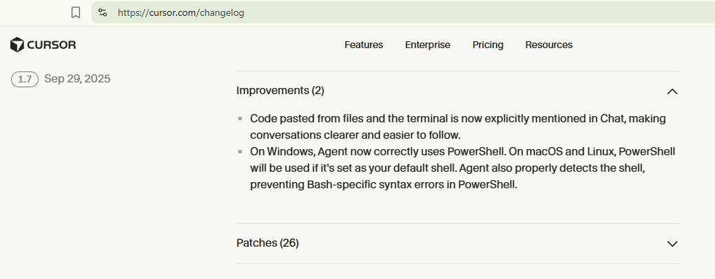

If the model struggles with performing actions, then it’s usually the tool layer, or a mismatch between the tool layer and what the model is trying to do.
For example, in Cursor on Windows the shell is PowerShell so commands need to be formatted accordingly. Trying cd bin/x64/Debug && myTestHarness.exe (bash style) does not work, but cd bin/x64/Debug; myTestHarness.exe does work. It keeps tripping over the difference. Cursor should know that it’s on Windows and tell Claude to format the commands as PowerShell commands, and this wouldn’t happen. So I blame Cursor for this.
In general Cursor could tweak the tools for each model, because for example if OpenAI were to produce PowerShell commands by default while Anthropic produces bash commands, then the request to OpenAI would not need any mention of PowerShell while requests to Anthropic need a reminder to produce PowerShell commands. Then when Cursor runs on Linux it would be reversed.
So when Copilot + Claude 4.1 fails to achieve your goal with listing files, I’m guessing it’s probably Copilot “helpfully reformatting” the directory listing when it sends the results back to Claude, and Claude can’t give the right response. Maybe you could tell Claude to use the command line “dir” command instead of the built-in file listing tool. If it does it that way, it would get the listing text directly and bypass the Copilot helpful reformatting and it could probably achieve the goal.
This would be a user-space workaround to a weakness in the application (Copilot), which is analogous to me having to remind the model to use PowerShell instead of bash format.

As I was saying, it’s Cursor’s fault for not using PowerShell properly. Not really Claude’s fault.
Then Cursor released an update that fixes it.
