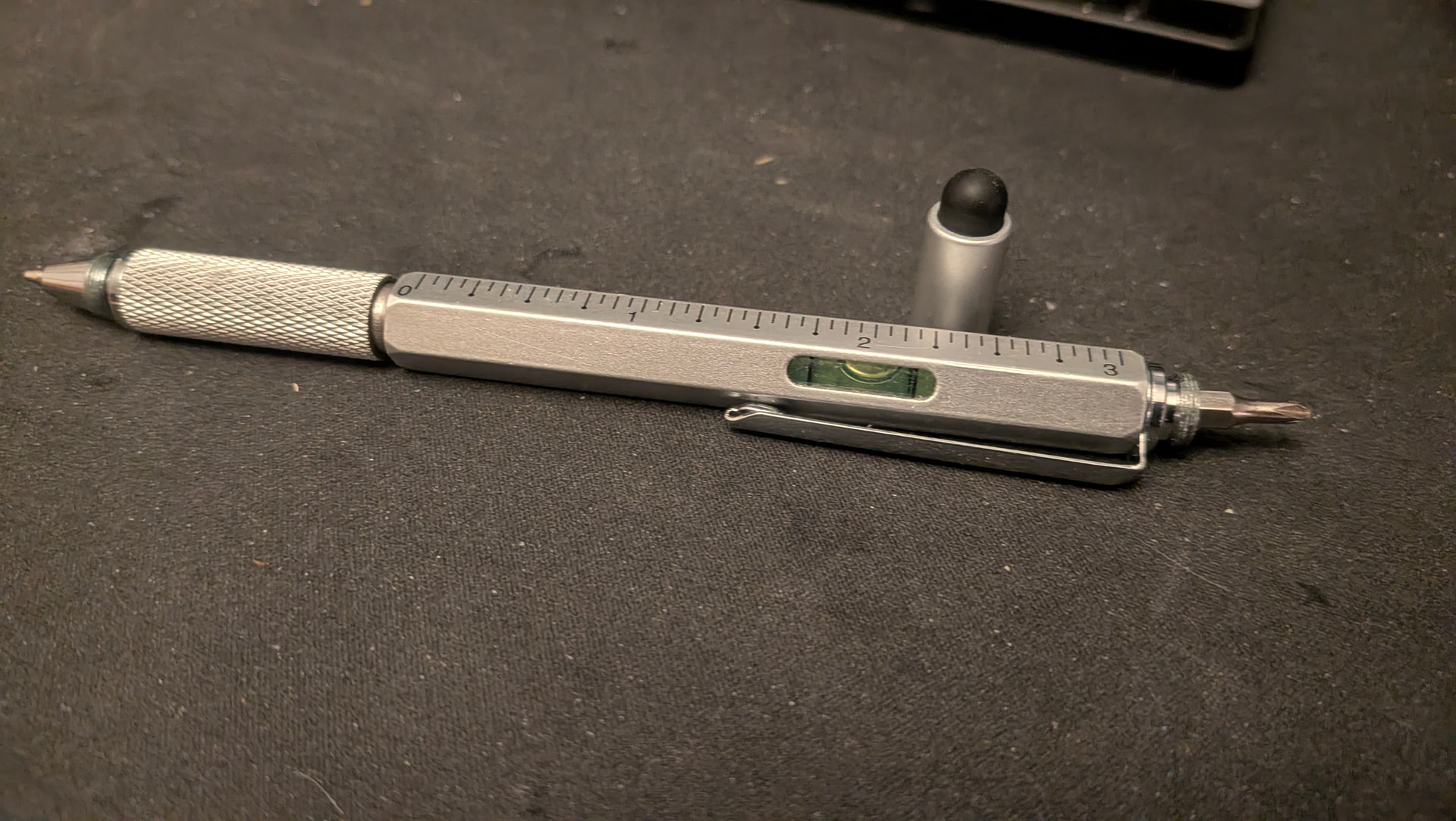

A gift from my 7y.o.
Pen, flat/philips screwdriver, spirit level and even has a touchscreen compatible cap very handy for the lowrider control tablet
