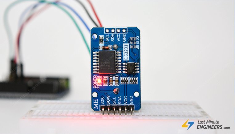

I have a BTT Kraken that I’m working on.
It seems to work OK, I can upload programs via the Arduino IDE.
I have a DS3231 RTC with EEPROM connected to the I2C pins (PB11 and PB10) on the board, but I’m unable to detect it.
I’m using the Arduino I2C Scanner sketch. It runs, but it can’t find anything.

I can run this on a BTT SKR 1.2 PRO board (just Wire instead of Wire2), and it finds the device OK.
Do I have a hardware problem like a bad board or is this a software / programming problem?
id you try to switch rx and tx? the discription on some boards is the pins of the board, some the description is of the device pins
