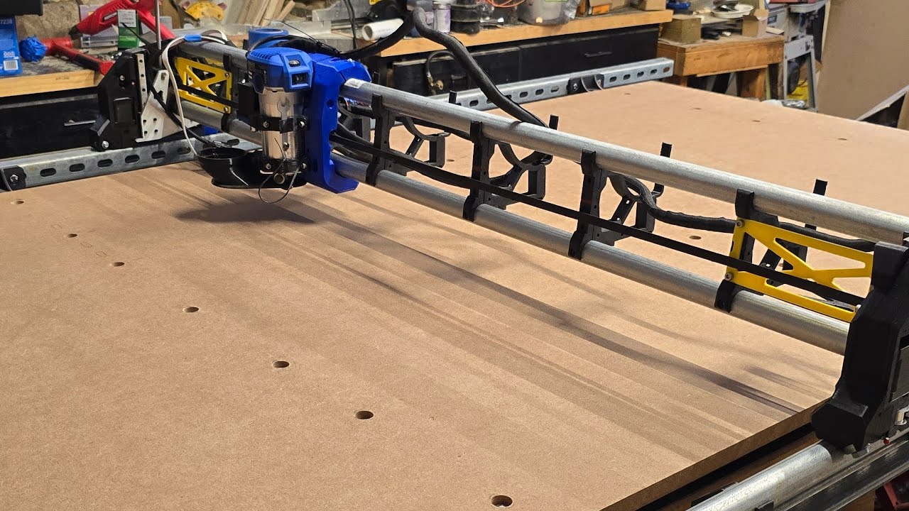

Can not get machine to lr4 to work
its off my pc i just copied it and pasted it
i did notice that the yaml file i uploaded didnt have as much information as when i looked at the raw file on github
Well, that’s an important bit of information. What did you change?
I would start over with a fresh config.yaml file.
thanks i will try yours i was just changing the file for the probe nothing with the wires
The yaml linked in the instructions already has the probe enabled, you should not have to do anything.
The config is set up, but you may need to go into the webui, three line menu on the top right, preferences, enable the probe tab,
ahh ok i will do that when i get the new board ordered a new one because i have tried everything with this double checked the wiring and stepper motors endstops all are working except it acts like it working processes code as if it was moving but it is not
Not for nothing but i was at that point 3 or 4 days ago. I posted a video in my thread showing each step of the troubleshooting process and my machine works now without a new board. This forum has amazing resources for support if you can just give them the right info and enough time to see it. My issue turned out to be an input getting to the board but not the processor.
You don’t need to do all the captions and stuff just a simple video would be fine. But here is what i shared. It’s really 5 videos that i put together in one so anyone searching would have it all in one place.
Okay so you are good to go now? You swapped io32 for the open one in the yaml file and all is well?
