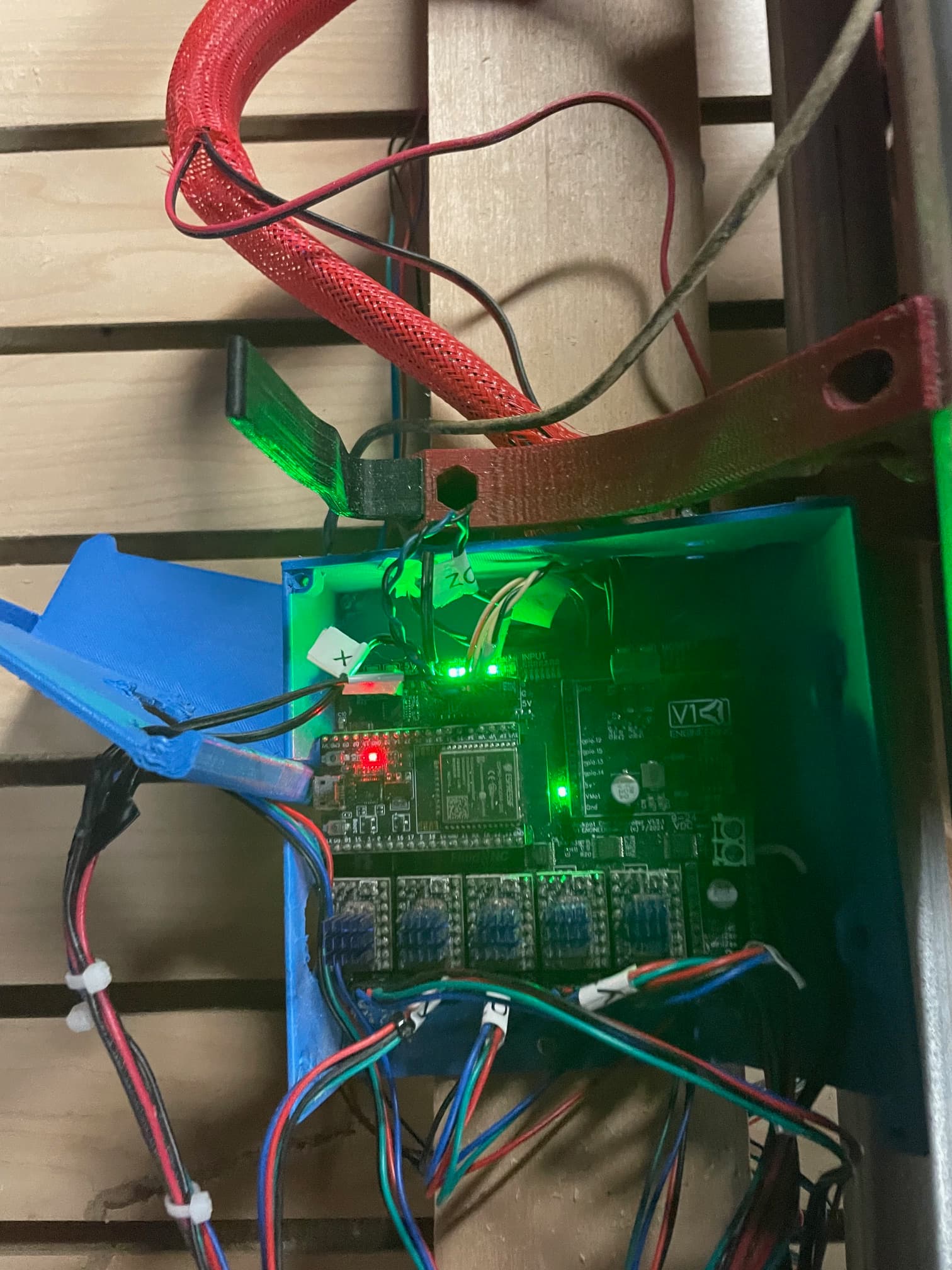

was working fine except for probe would not work so i messed with that trying to get it to work and now it acts like it is running the machine but i get no movement can you please help

That looks ok. Can you go into detail on what doesn’t work? What have you tried?

nothing works it reports that it is jogging and changing position but none of the motors move
jeyeager
(Jason Yeager)
March 9, 2025, 3:00am
6
Ok, how are you jogging? Via the WebUI?
We’re also going to need to see some pictures of the board so we can take a look at your wiring.
Do you have a USB cable connected? (You should not.) If a USB cable is connected when powering it on, it won’t pull power from the power supply.

I’ll need to see pictures of your wiring. How do you have this powered? Is a USB cable connected?

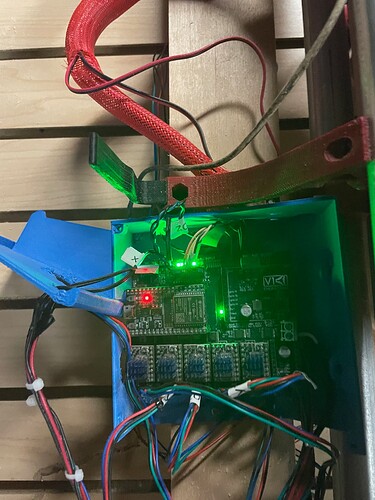

no i only used the usb when i was using web ui but i will get you a picture

all endstop light are on except for the probe but it lights up when you touch the pad
