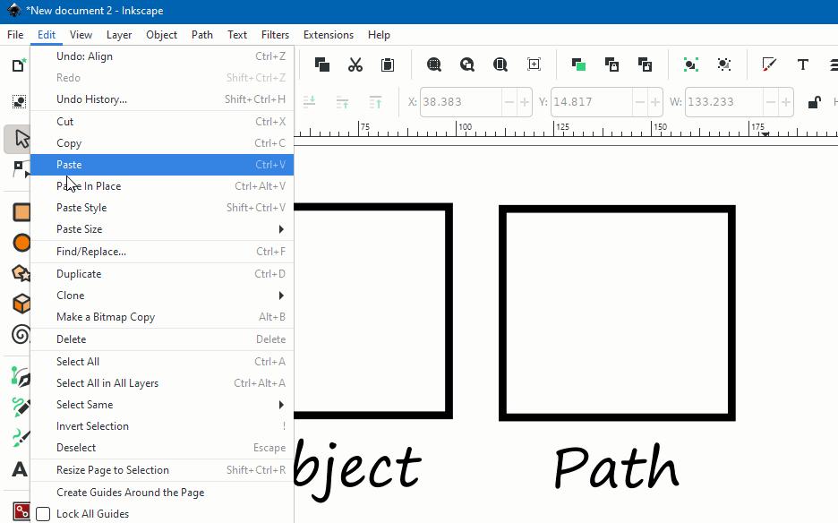

@turbinbjorn, to be brutally honest I am replying to try using an animated gif. Not sure if people find that irritating or not.
I don’t disagree with or comment. However, I find once you discover a “technique” to do something its not so bad. What you see below is the following:
  1. Two squares. One is an object, on has been converted to a path.
  2. I have already zoomed into the objects I care about.
  3. I Select All for simplicity.
  4. OPTIONAL: This is optional but useful, switch to Outline View
  5. Switch to the node edit mode.
  6. I would suggest that the item that is an object is pretty clear versus the item that is a path (red lines) and nodes (diamonds).
screen_test
Now i want to makes gifs too. Lol
What program are you using?
Ya done good, the animation works!
