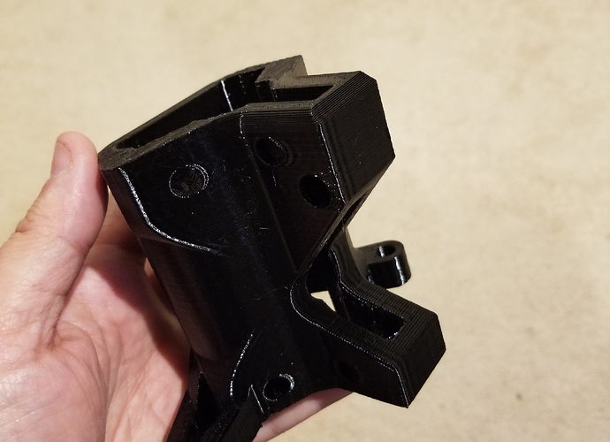

So just the center section is different, correct? I’m gonna start printing soon.
Pretty much, I have a little update break down on the home page.

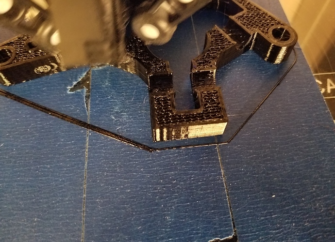

Forgot 50% with the gyroid infill is a little high. Resliced with 30% for the other part.[attachment file=72169]

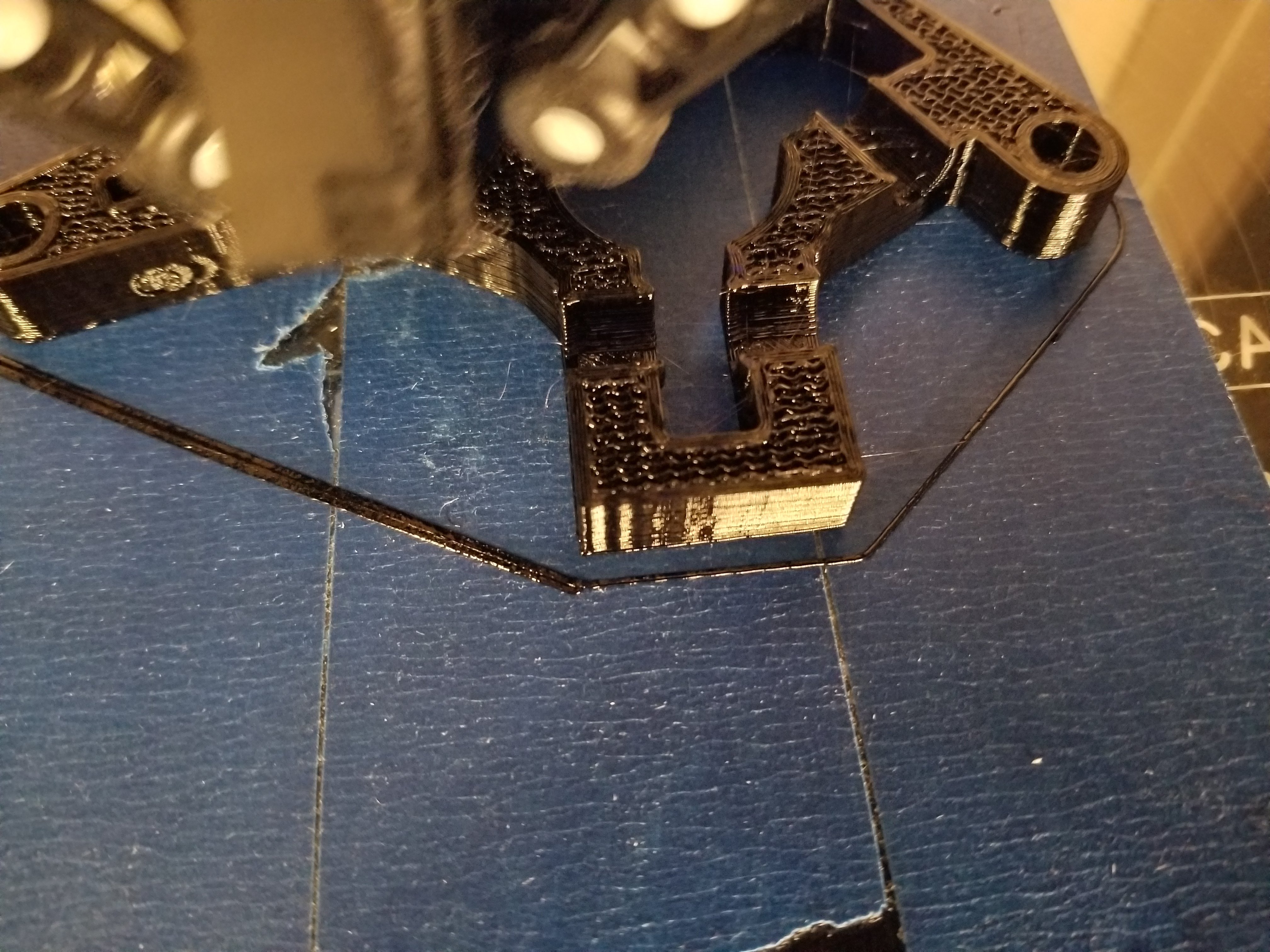

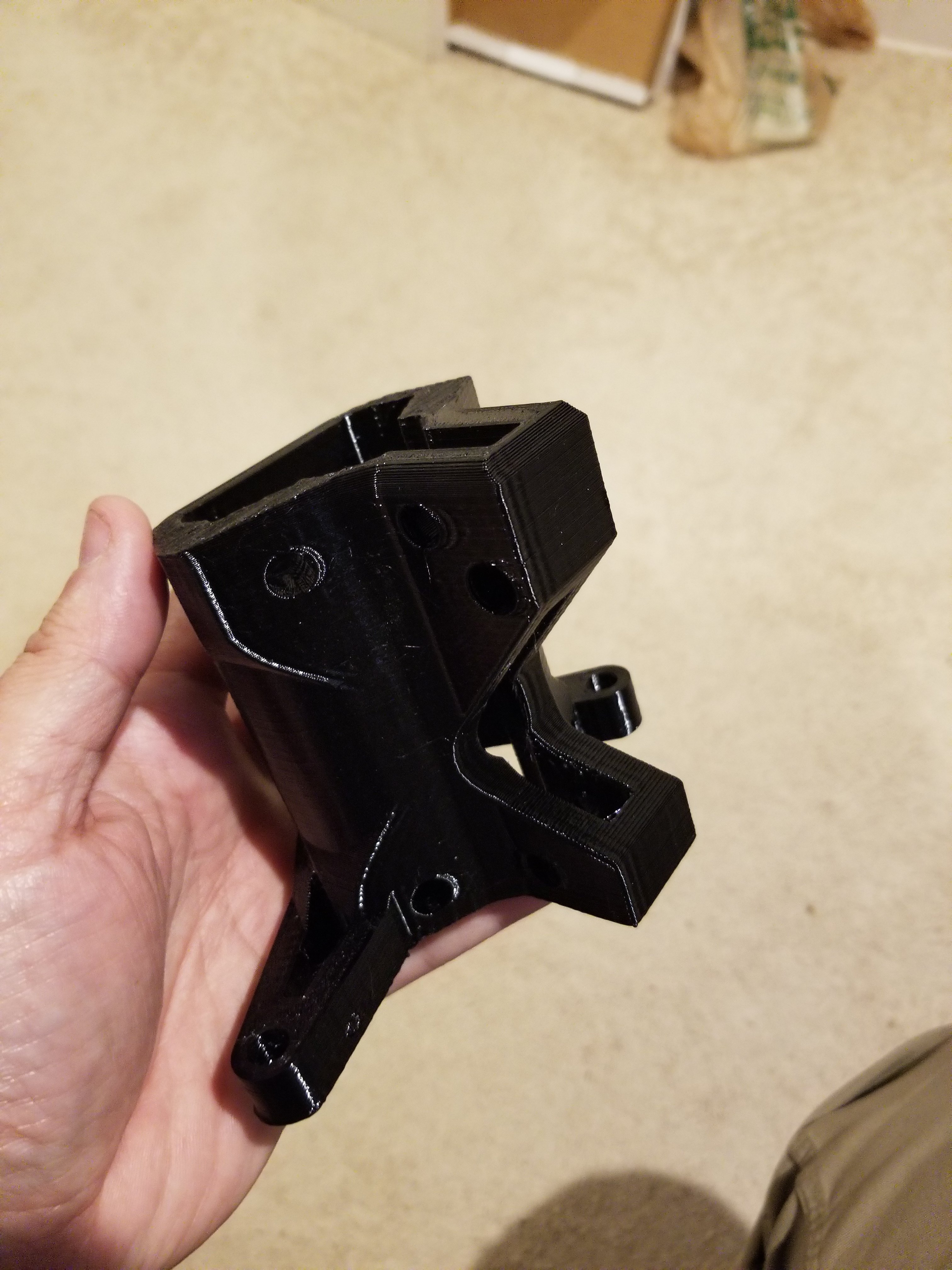

How I’m doing?
[attachment file=72178]

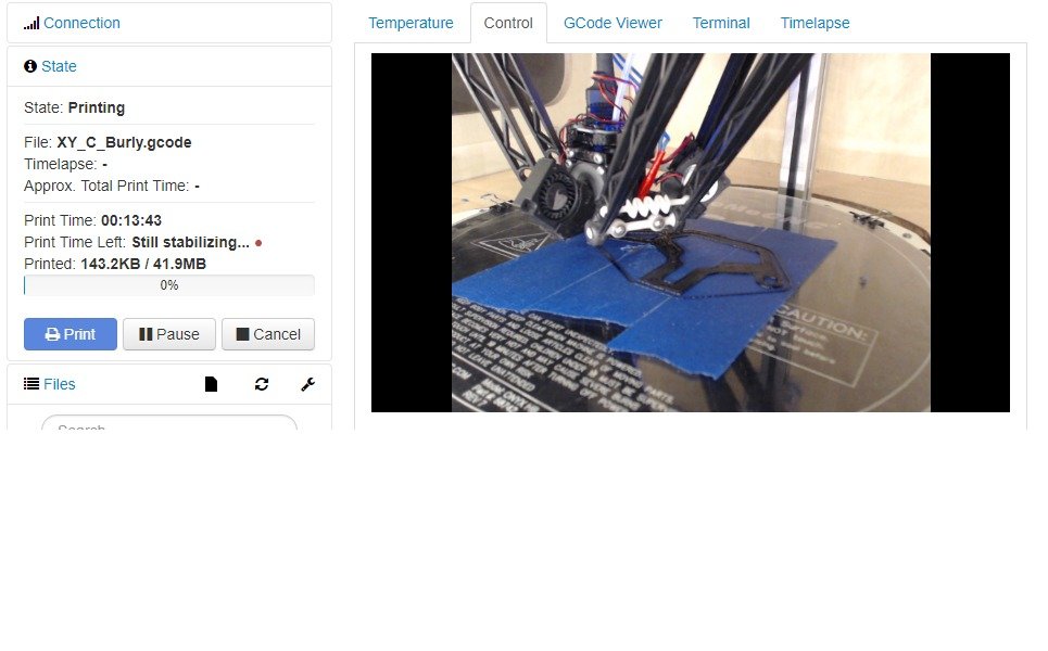

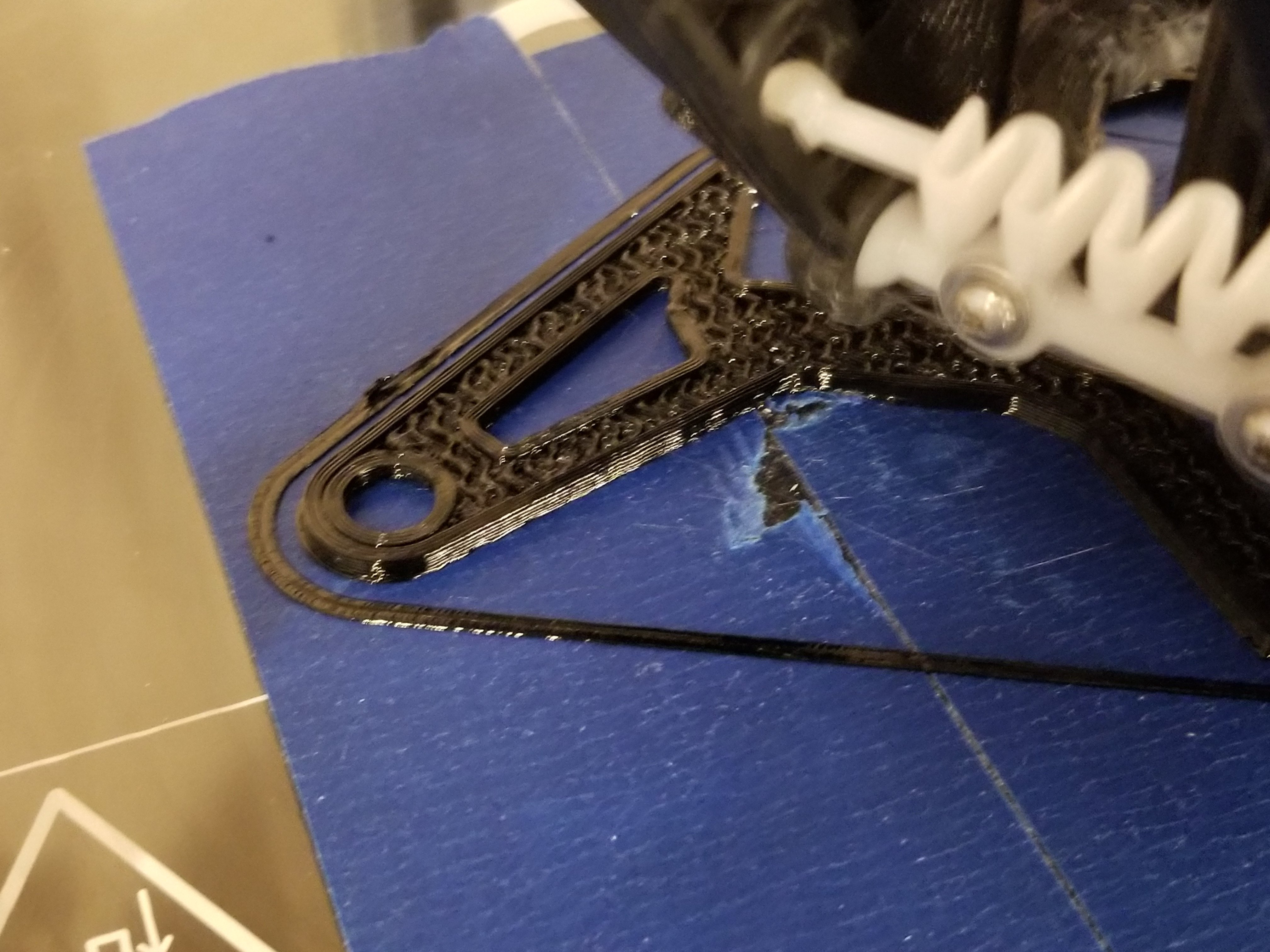

Woo![attachment file=72197]

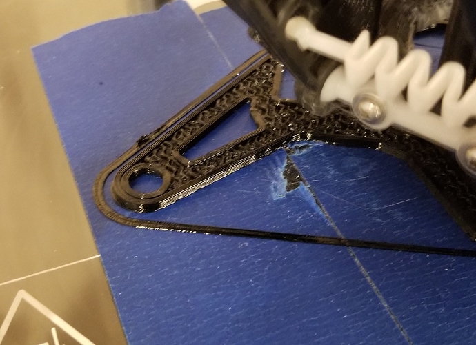

Also, 30%[attachment file=72200]
I use a .4mm nozzle, and it works great. .3mm layers with 4 perimeters, but I’m printing in pet-g, pla works well with 3 perimeters. Infill percentage depends on the infill pattern. When I used cubic, I used 50%, but with the gyroid, I’m still looking for a decent percentage, 50 is waaaay to high.
I printed the previous versions a month ago at 55% gyroid & did not have a problem. I am using klipper firmware on my printer though. I was starting to think about printing them at 30% gyroid after your previous comment, but might go at 50%.
Let me know what gyroid % you come up with & perimeters. I am using the variable level height, using .4mm nozzle & setting .3mm layers for all but where the horizontal holes are. Those layers I set at .2mm layer height because the tops of those holes look a little knarly at .3mm for me. I am currently thinking of printing the “XYZ_C_Burly.STL” with 4 perimeters at 50% gyroid. I might start printing these today.
Use as high of infill as you are comfortable with for the XYZ part, all the rest not such a big deal, that one…pack it.
