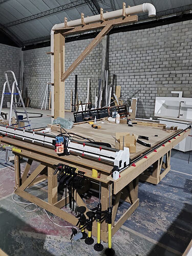

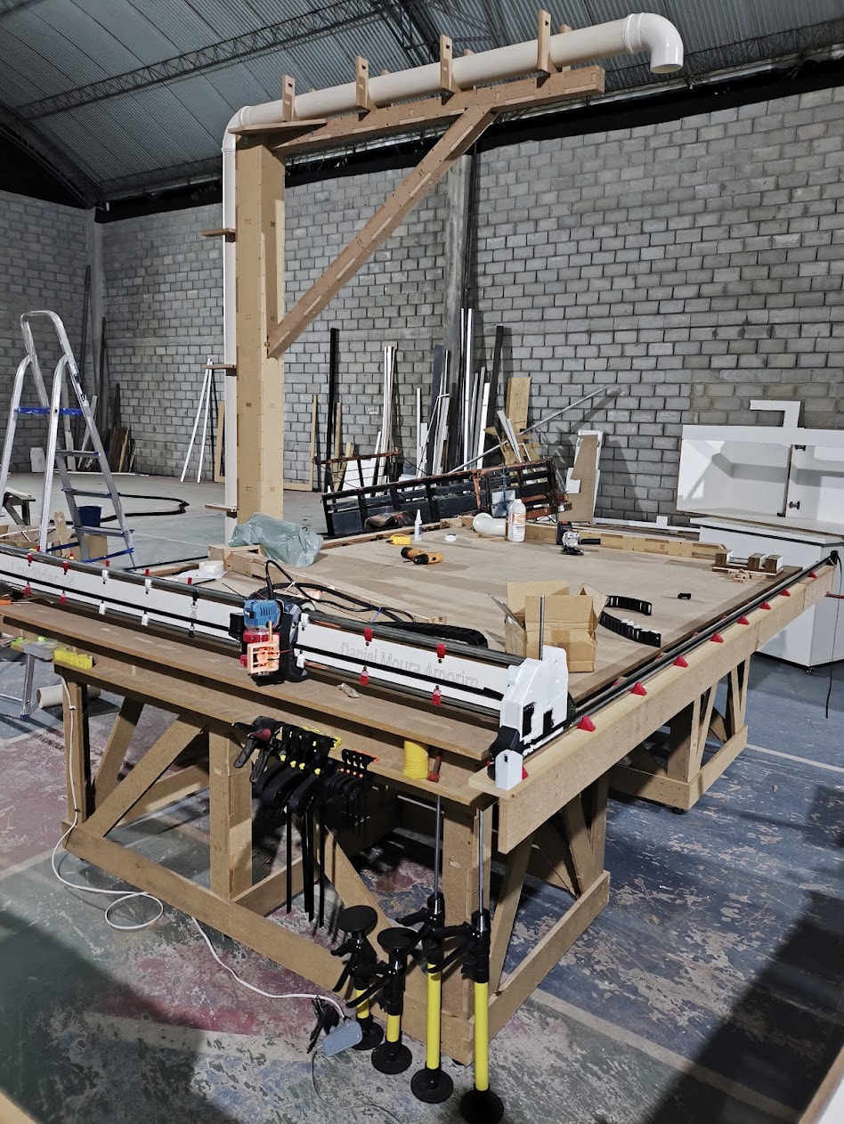

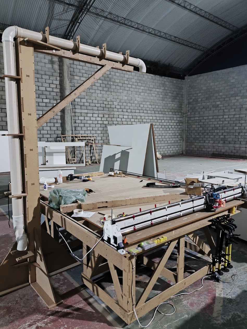

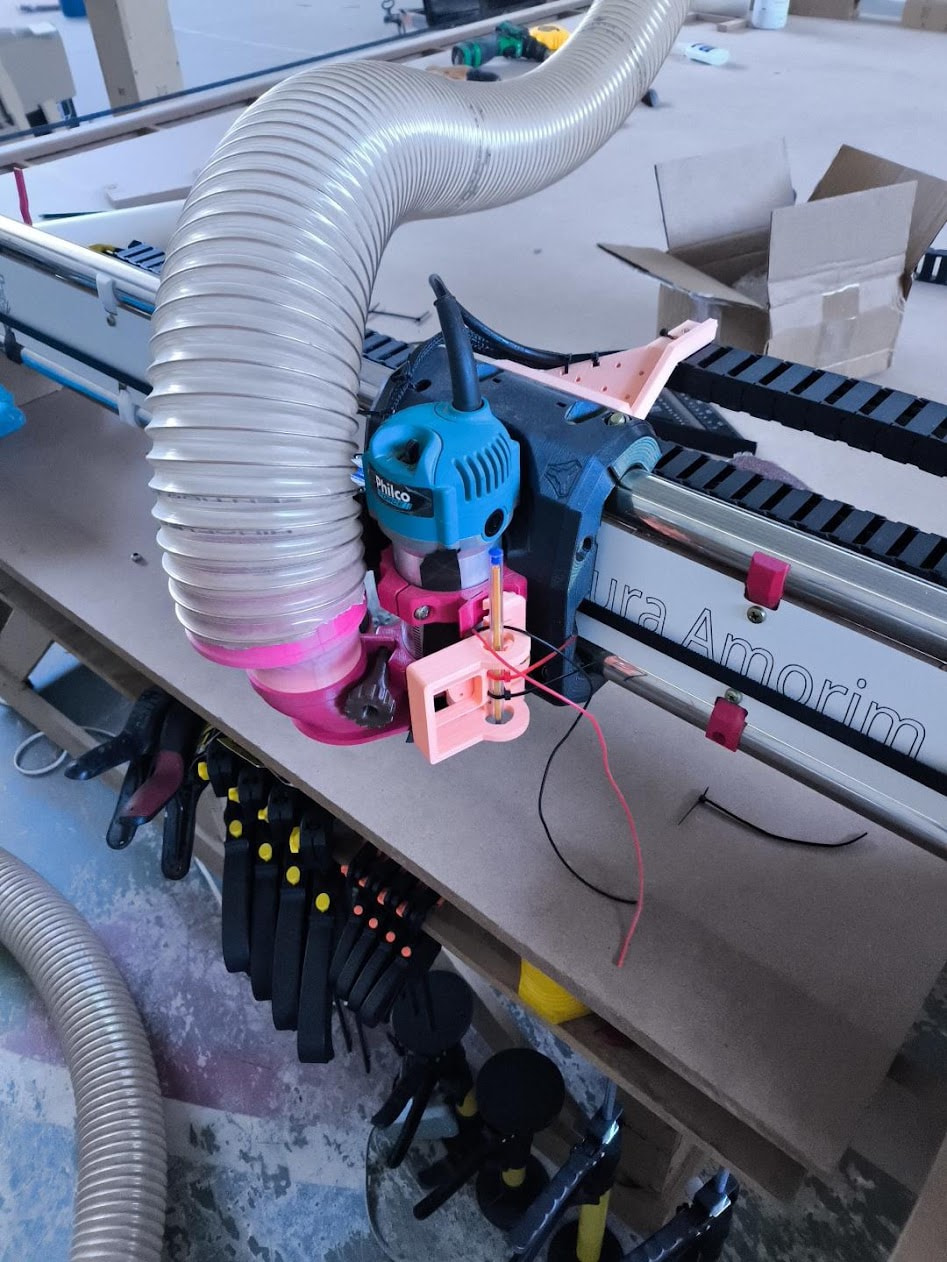

I think I went a bit overboard by using 1.5 meters; 1.2 meters would have been enough for my needs. Still, it’s an easy fix—I just need to move a little further away from the table to center the pipe (I’m still going to trim the excess).

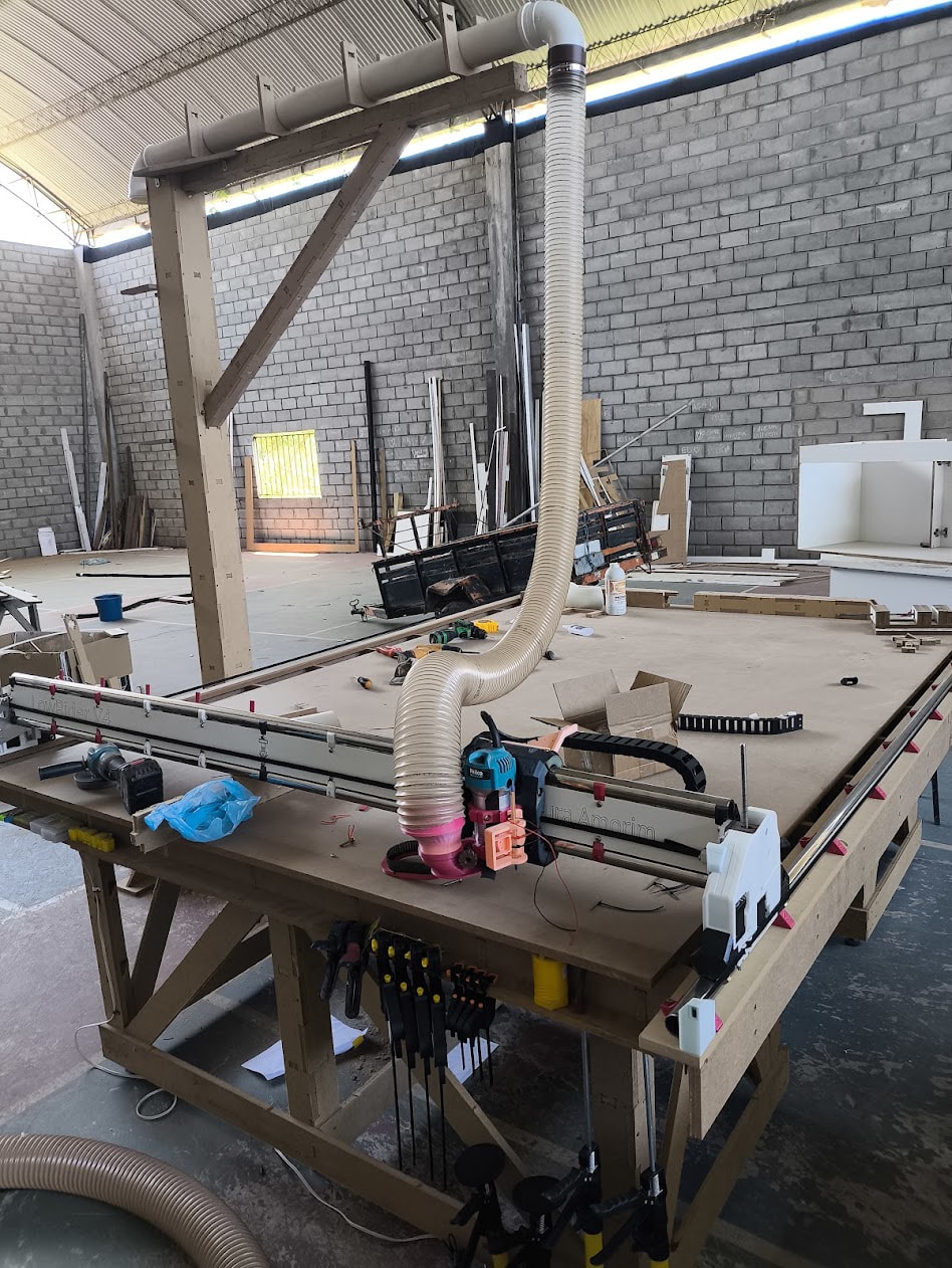

Hi everyone. Has anyone developed or used any kind of support for the dust collection hose on the LowRider 4?
In my setup, the hose comes from above, and I’m noticing that a lot of the load is concentrated in a single point on the gantry/Core. I’d like to add some kind of support closer to the router to help carry the hose weight and reduce that stress.
Ideally, I’m looking for something mounted to the Core/gantry itself, possibly with some freedom to rotate or pivot as the machine moves.
Has anyone made something like this, or seen a design/STL that could work?

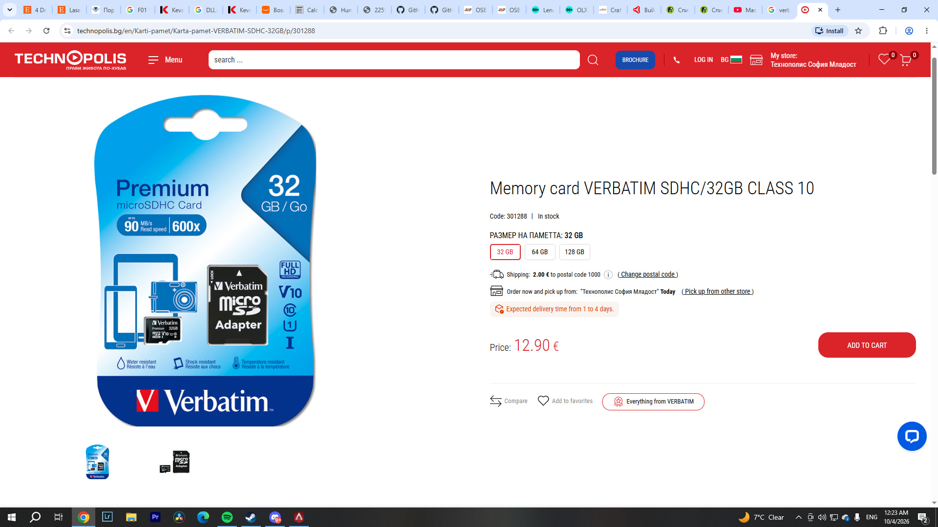

I am using this SD card. I didn’t do anything, it just worked from the start.
I’m also currently working on a boom arm. Will gladly share once done. I have to learn how parametrics work in fusion though, so people can adjust based on their table size.
