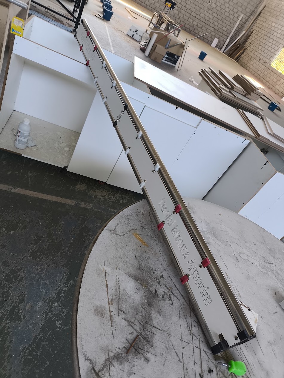

My goal is a fairly large LR4, designed to work with full 2 x 3 meter sheets. Because of the size, one of the things I am most curious about is how the gantry will behave across this span. I know this is getting toward the larger side of what people normally build, so I am really looking forward to seeing what kind of rigidity and cutting performance I can achieve.
For the rails, I decided to use 32 mm steel tubing, and most of the printed parts are already being produced.

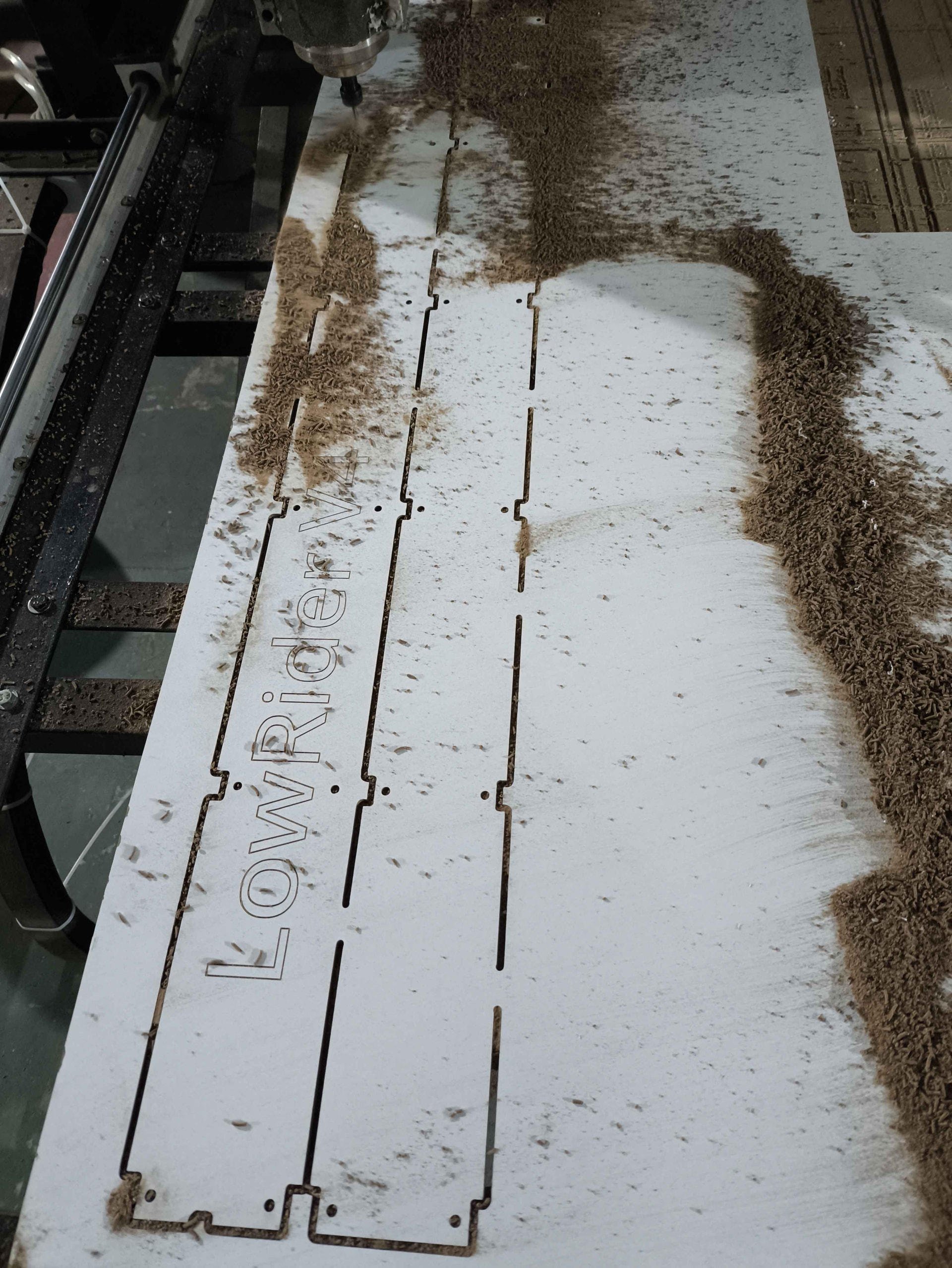

One thing I can already say about the LR4 is that printing the parts is not particularly difficult — there are simply a lot of parts to print. It takes time. However, the documentation, instructions and information shared by V1E and the community make the process much easier.

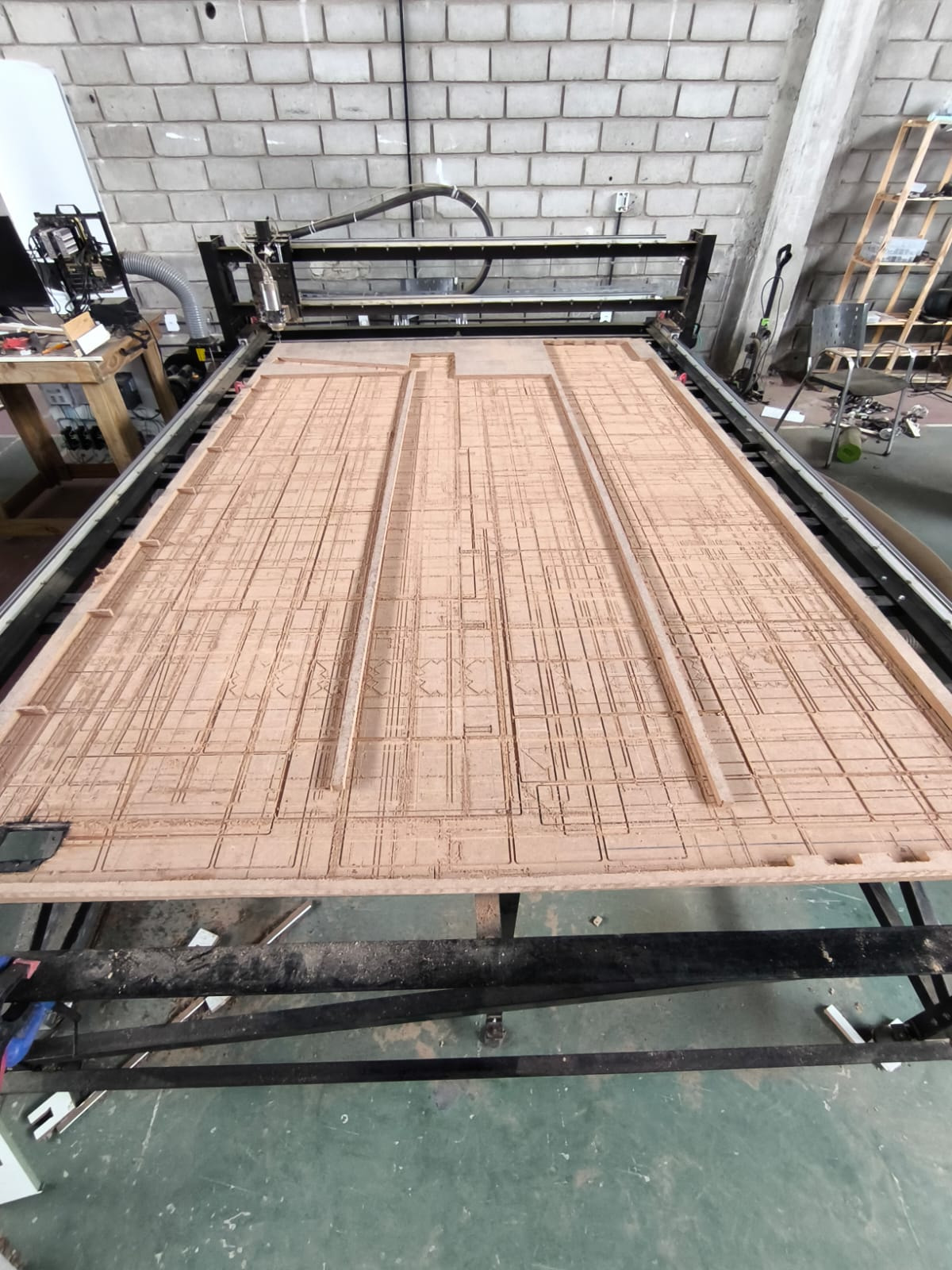

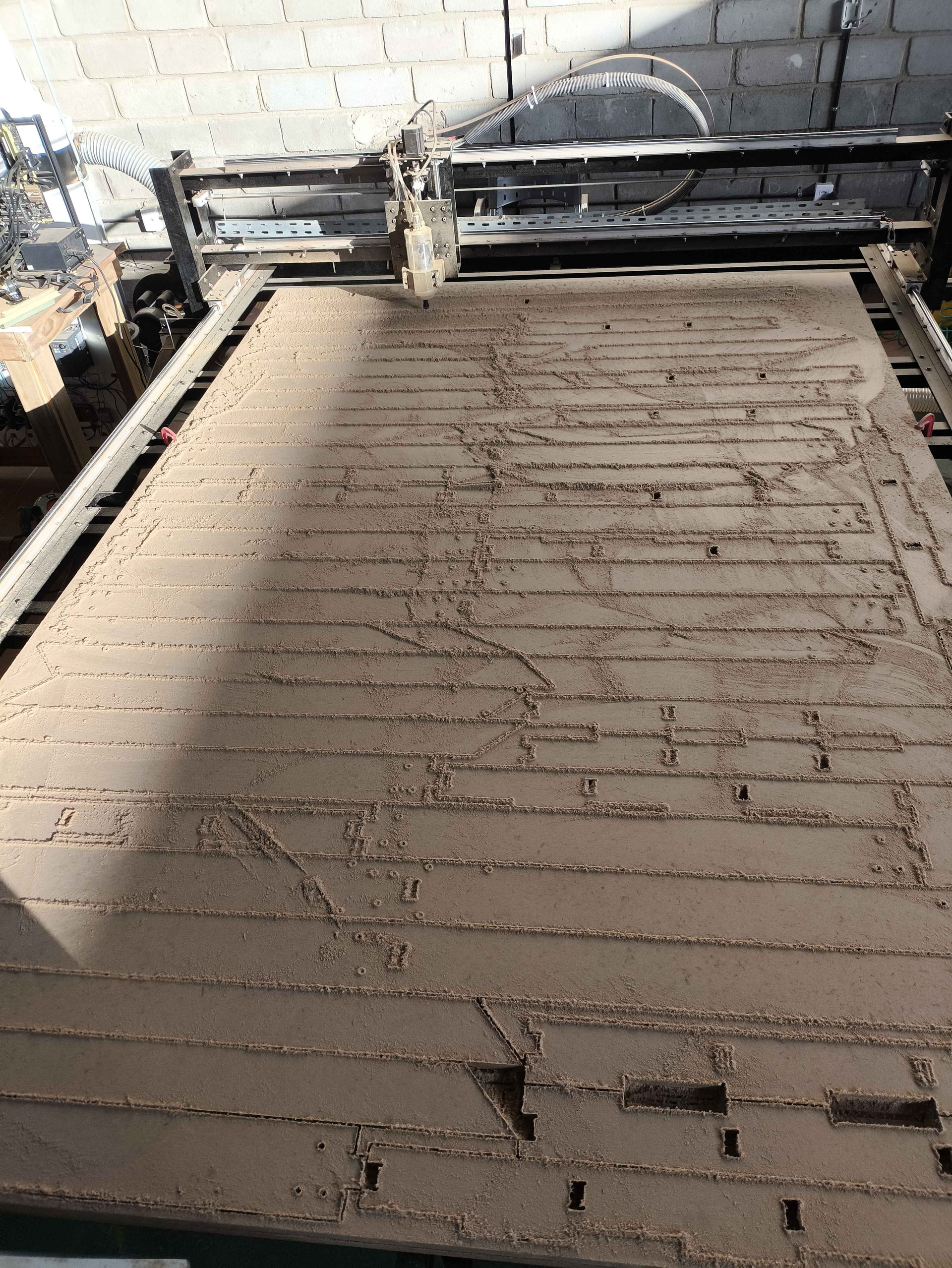

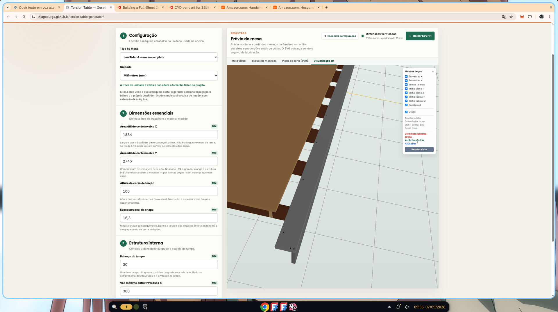

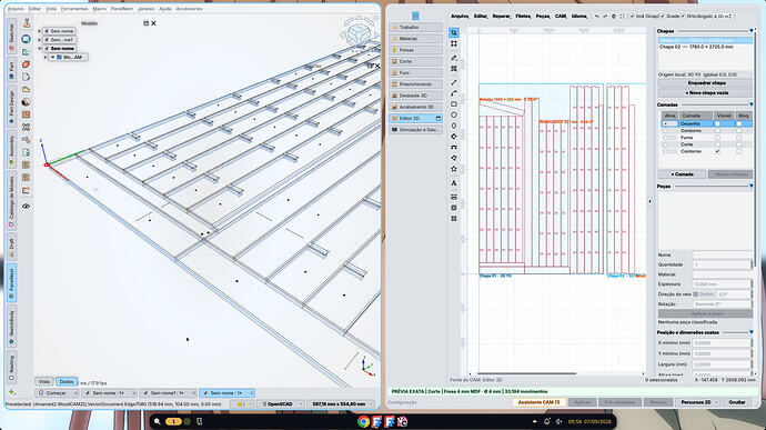

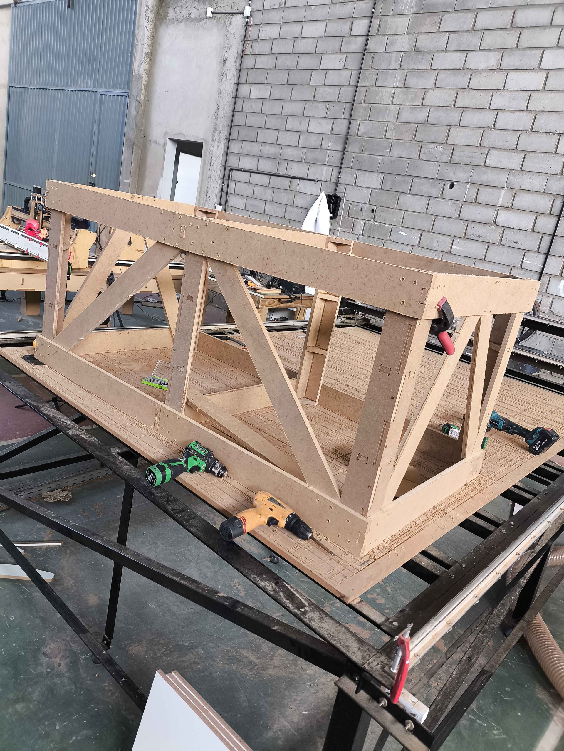

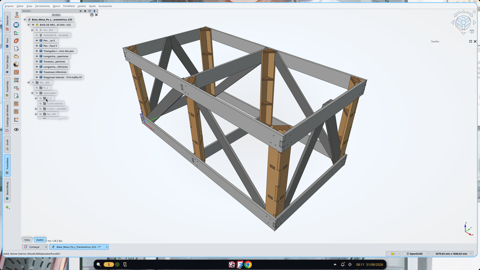

The table

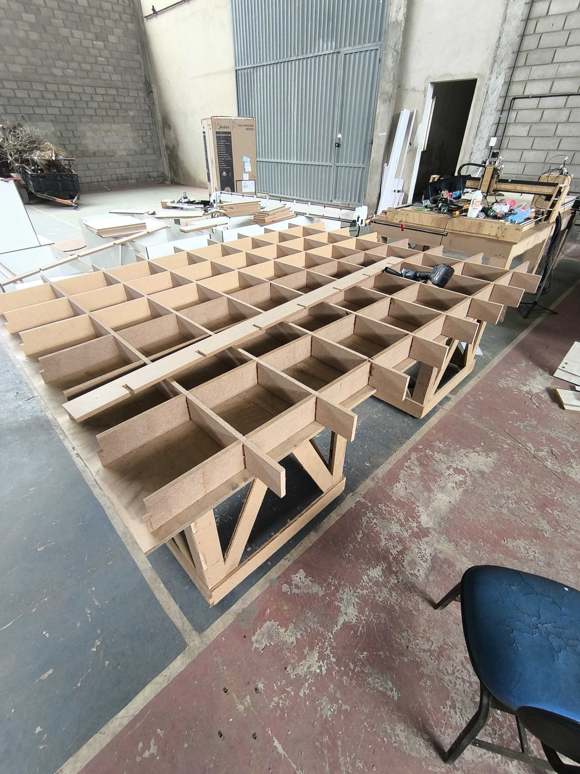

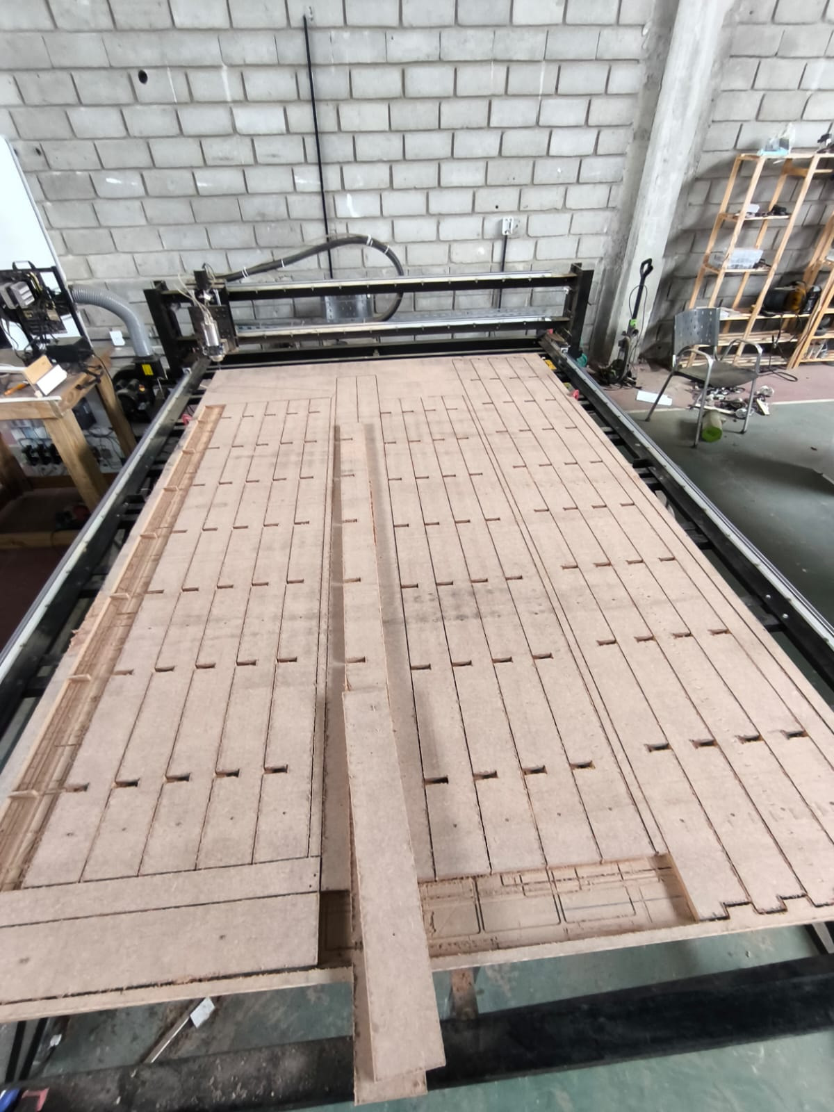

I am also building a table specifically for this machine.
The top will be a torsion box, because with a machine this large I want the working surface to be as flat and rigid as reasonably possible.
For the structure underneath it, instead of using a simple rectangular frame, I designed a heavily braced base.
I had several MDF strips left over from other projects, so I decided to take advantage of them and make the base as rigid as possible rather than letting that material become scrap.
The structure therefore uses multiple cross members and diagonal braces.

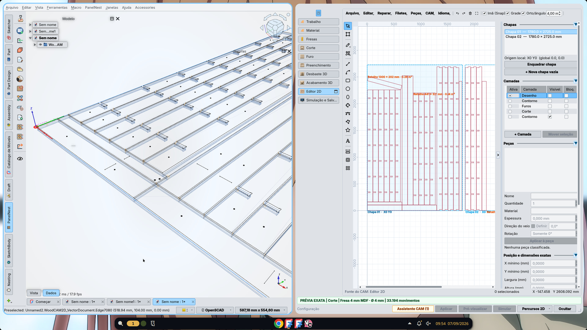

I also designed the base parametrically, so I can still change its dimensions before cutting the final version on the CNC. I designed the joints so that the parts interlock with each other instead of relying only on screws for rigidity.
It might end up being a little overbuilt, but for a machine with a 2 x 3 m cutting area, I would rather start with a very rigid foundation than later try to diagnose problems caused by the table moving.
Once it is finished and tested, if the design works well, I would also be happy to share the parametric table design with the community.

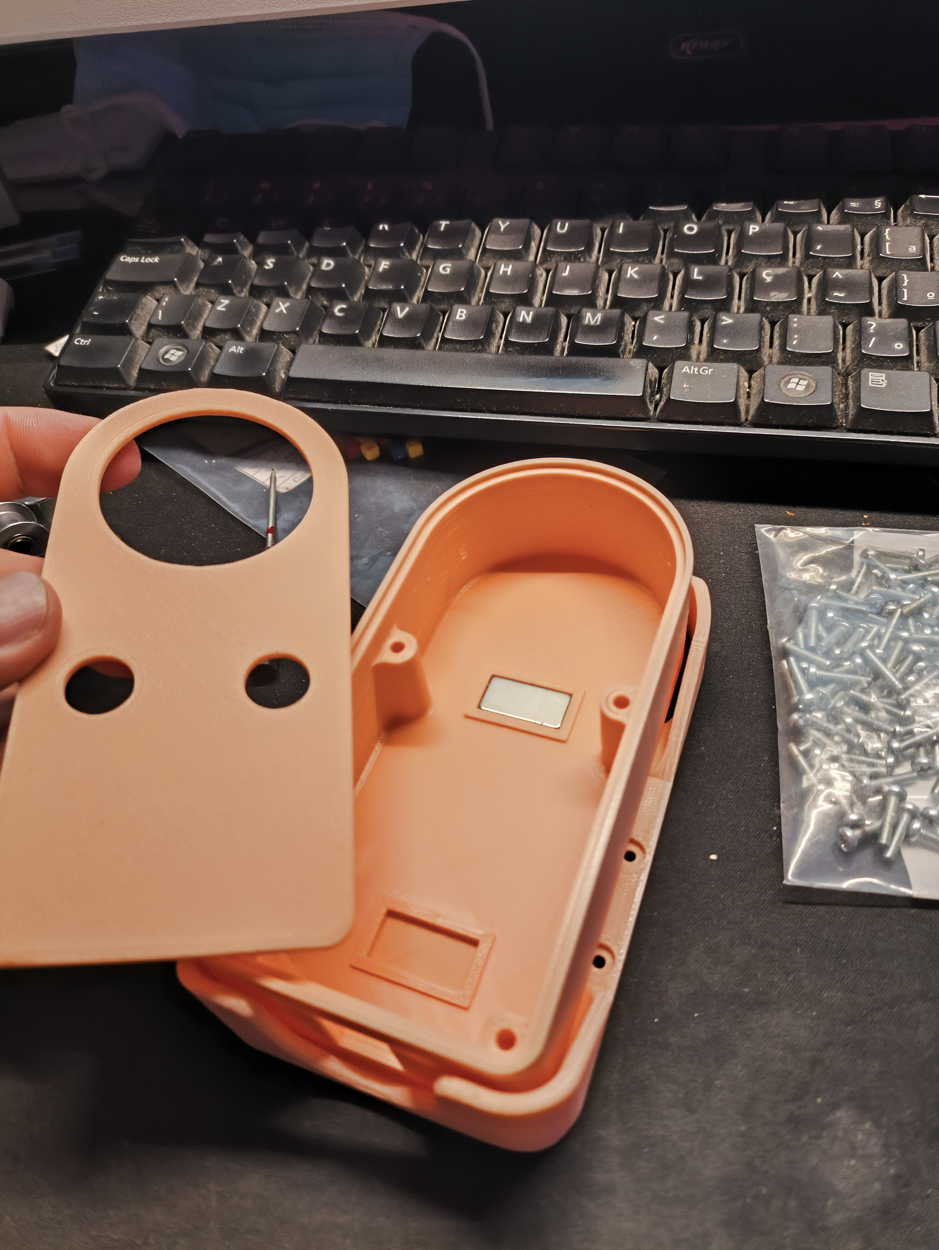

Doug’s pendant/display
Another project I really liked was Doug’s pendant/display, so I am planning to build something very similar.
I like the idea of having a small dedicated controller directly at the machine for jogging, homing and basic operations instead of always needing a computer or phone just to move the CNC.
So that is also part of the build.

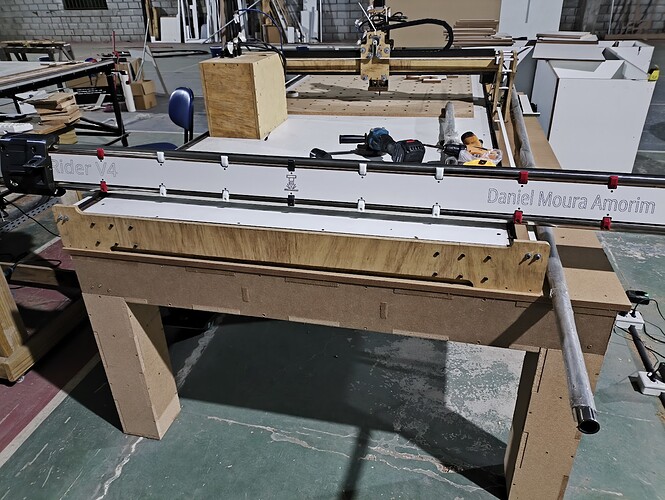

For now, I intend to start with a Makita-style router rather than immediately installing a heavier spindle and VFD.
Because my gantry is already going to be quite wide, I think keeping the moving mass relatively low initially makes sense.
Once the machine is running, I can see how it performs and then decide whether changing to a spindle would actually bring enough benefit to justify the additional weight.
I am also planning the dust collection system from the beginning. I already have a larger dust collector available, so I am adapting the LR4 dust collection system to work with the hoses and equipment I already have.

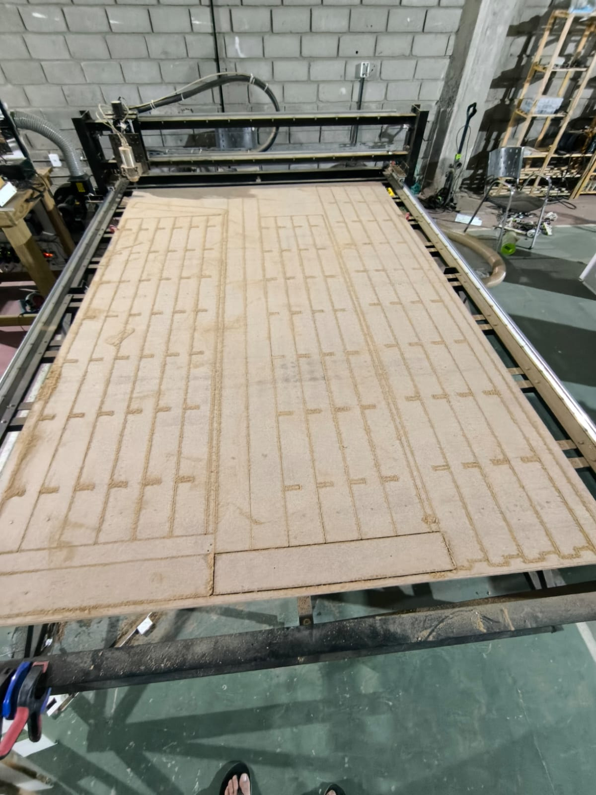

The next major steps are finishing the printed parts and the table, followed by the actual assembly of the LR4.
I intend to use this topic as a kind of build log, updating it with photos, problems, solutions, mistakes and results as the project progresses.

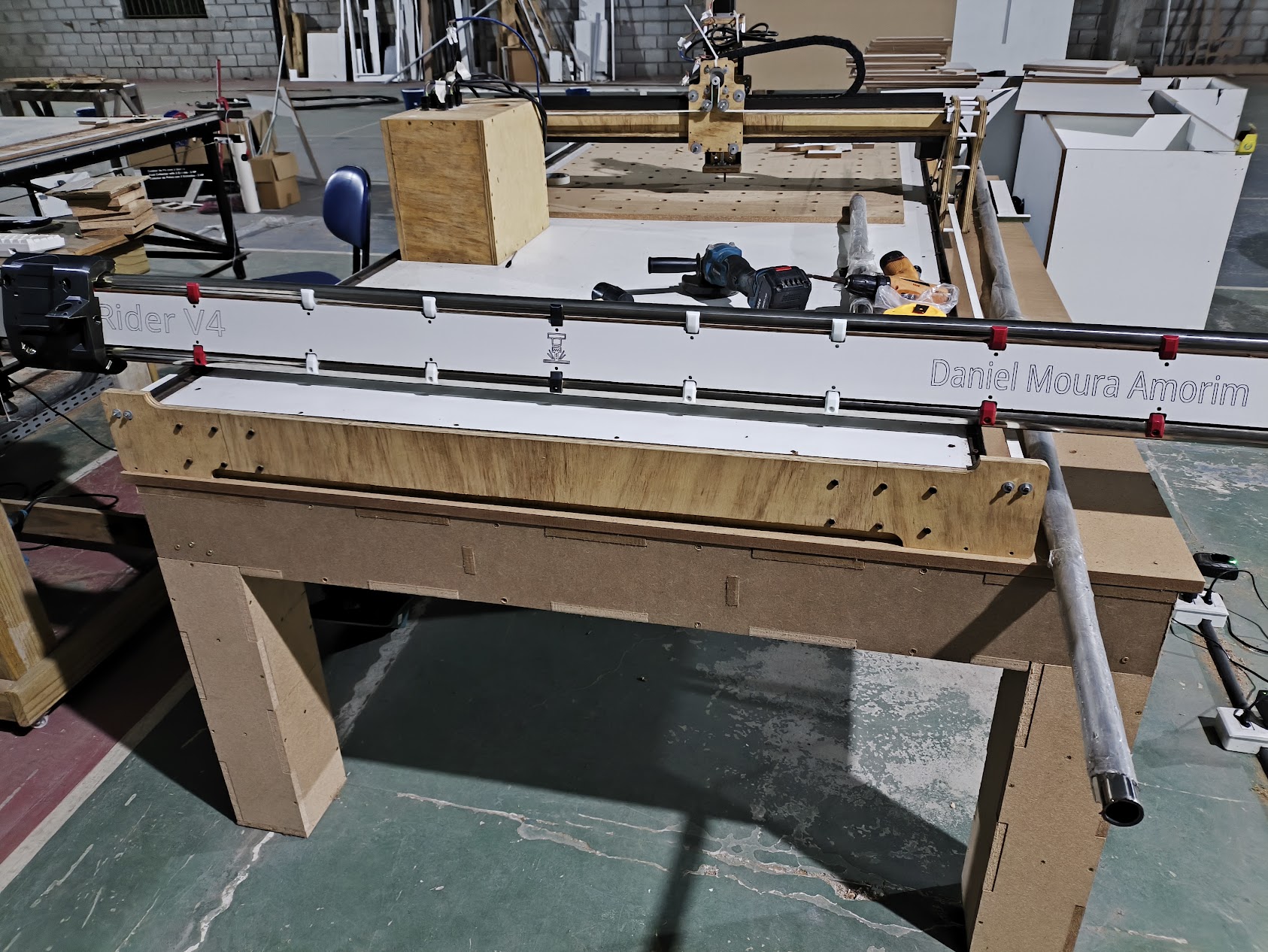

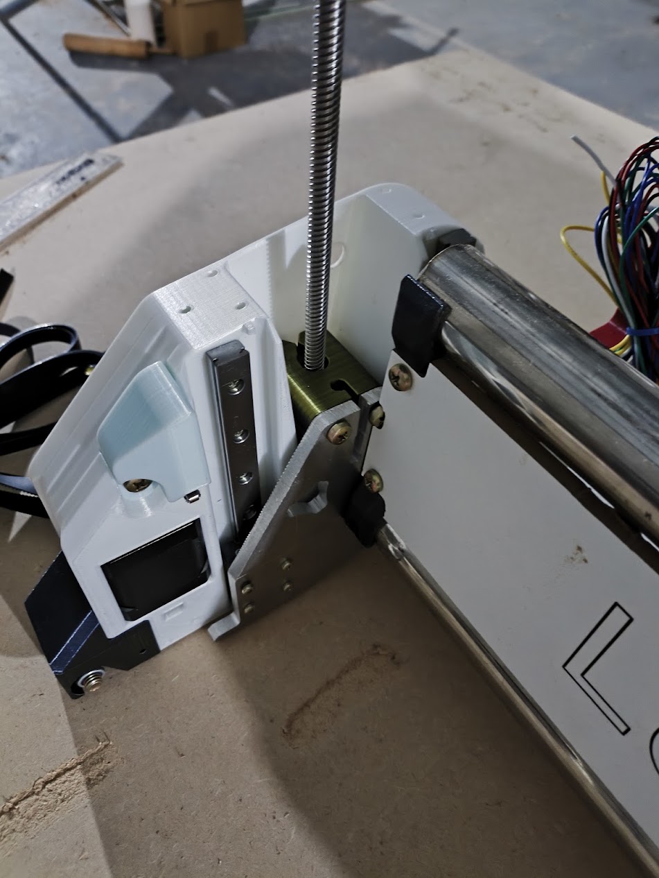

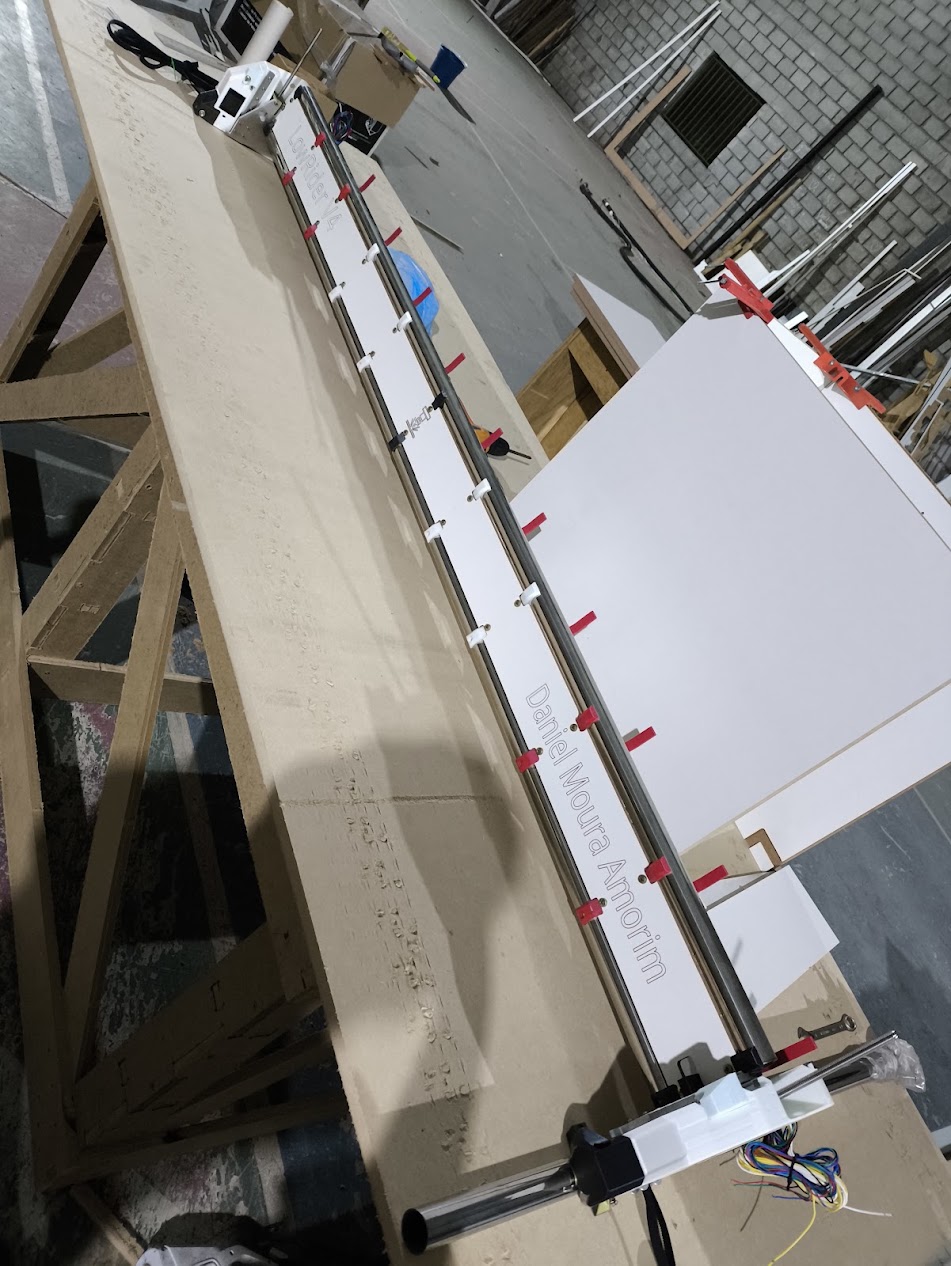

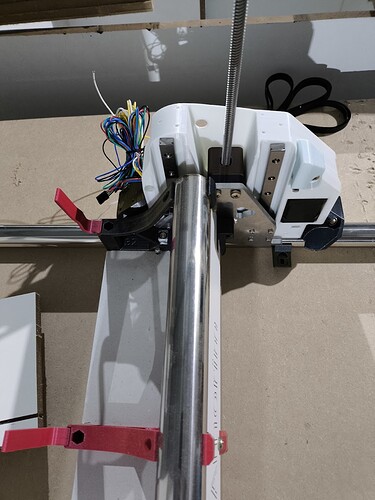

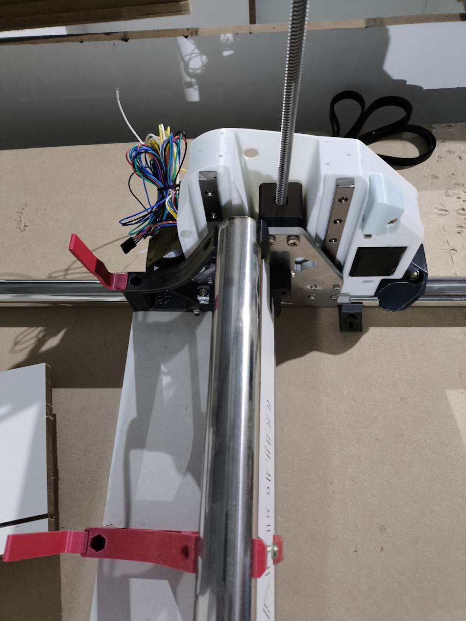

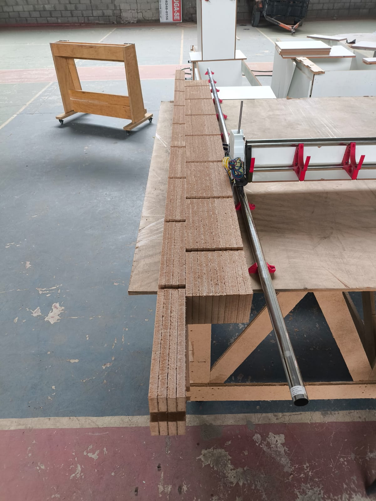

I haven’t tested it yet. I’m still in the assembly process — today I finally joined the main parts together.
