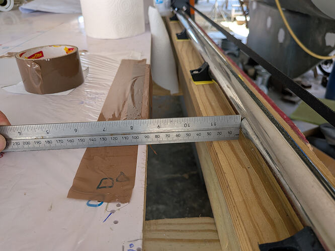

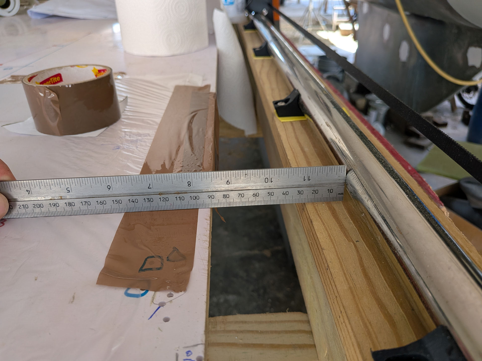

So there is a LOT going on when you do the build. I finished my build though and I got the rails mounted. I chose to do a 4x8 foot build. I bought my metal to match the calculator. I got it all setup and found on the non-metal tube side I couldn’t get to the table edge. And on the metal tube side, I could get off the edge of my table.
It’s not that big a deal but I’m surprised we don’t have some kind of 3d printed gauge that indicates where to offset the tube rail from the cutting table so you know here to put things. Or at least bring it up in the docs.
Again, not a huge deal but it was confusing. Maybe I messed up somewhere? There is a lot going on. It’s not that hard to fix. And in hindsight, of course I shouldn’t be surprised because I could have moved the head to one side and observed the difference but… I was surprised.

What size cutting area (actual dimensions ) were you intending to build? What values did you put into the calculator? What size did you build your table to? What lengths did you cut your EMT to?
(Not implying you were wrong either with your build or with the calculator; these would let us use the same numbers and see if something is amiss)
I’m not sure I follow that completely. Have some pictures to share of your build and how things aren’t quite as you expected? PIctures > 1000 words and all that…

Can you share a picture of what is happening? I am a little unclear on the issue.
For the rail side, the rail clips get lined up with your table edge. Everything else should fall in place from there.
So the part I was confused about is basically the offset on this side from the rail determines how close to the edge of your table the bit can get. Also there is the offset along Y – the negative offset off the top of the table that would determine where that end stop should go so you can get to Y=0 and that is edge of the table (I can go past Y=0 but on the other end, I’m maxing out before I get to the end of the 8 foot sheet).
Does that make sense? It’s not a big deal I just didn’t think about it or have an idea of how to figure out where to put things to get the whole sheet. I’m going to replace the current spoil board with some MDF and I can shift over the whole table top at that point as my X axis is just a little off. For Y, I’ll check but I can probably shift the rail further in the Y+ direction. I cut one of the long belts slightly too short so going to hold off on that until I get a replacement belt.

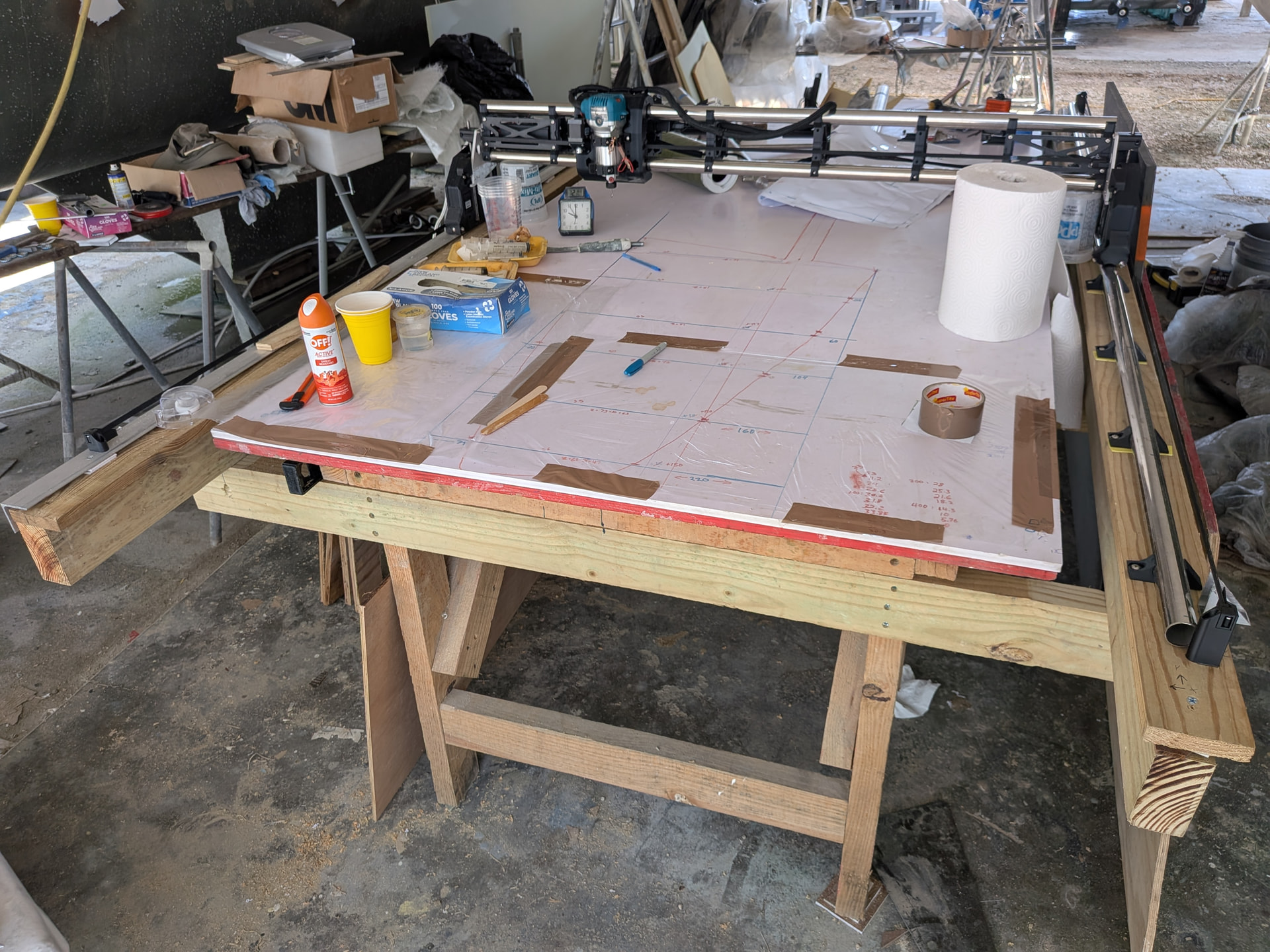

Here is a shot of the whole setup. I reused a table someone else gave me in the boat yard when they took off. So I had to adapt it a bit with adding the wings.
Also for the tube lengths I used the online calculator and used what it said for the 4x8 sheet size. I’ll measure them again to be sure but I was pretty careful about that. Now that I understand how it works, I’d probably go 1-2 inches longer on the X and at least that on the Y. But later, I might have less space so I could understand people wanting to keep it tight.
In the instructions, there is a link for a few tables in CAD, on from me, that gives pretty accurate numbers…but they do vary. The best thing to do is set the machine on the rail and check before you screw down your tabletop. That is actually how I do it.
Same thing here, the endstops go at the end of the rail, use the CAD or the actual machine to set the top sheet. Y=0 is where the endstops trigger, you should not be able to go y negative unless you use a large pulloff value. Y=max is not constrained so nothing to set there.
I know it seems odd that there are no exact dimensions given for a machine like this and the table but the table dictates where the endstops go, the endstops determine where the machine sits at zero, and the machine dictates the sheet placement. So if I told you where the sheet goes then you would have to work backwards and try to place the endstops and machine exactly, much harder to do. On less than a full sheet the location does not matter at all becuase the whole thing is covered.
Hope that clears it up, build the table with no spoil board, place everything, spoilboard last.

One question – just be 100% clear I understand – the surface that the bearing wheel side runs on and the tube mounts are screwed to should be on the same plane as the top of the table before the spoil board? I tried to align to the spoil board. I was going to buy another 1/2" sheet of MDF for the spoil board but would it be better to go thicker to push the spoil surface up higher? My plan was to use a 1/4" router bit (16mm cutting) to surface the MDF as the table surface is fairly good but not perfect.
No.
The frame of the table should all be one plane, the wood the tube clamps screw to should be the same as your spoilboard, then everything will be co planar.
Have a look at the CAD, that might help clear things up for you.
At the same time…it does not matter. The spoil board can be a bit lower or a bit higher. The table can be bowed or twisted and doing one surfacing run will true it to itself (for 95% of CNC work, this is perfect)
No, the lower the material the stronger the machine.
