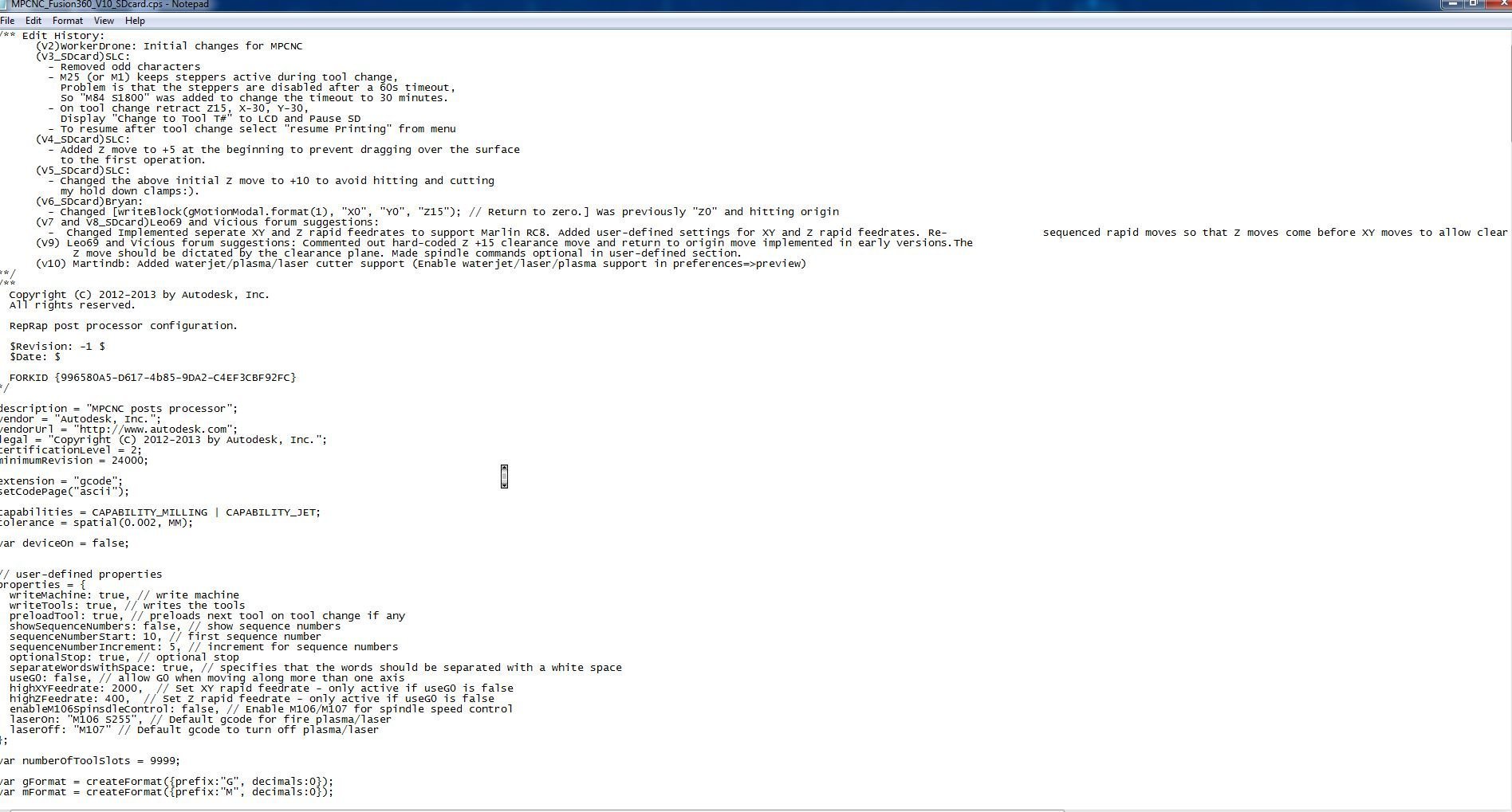

This is picture of my MKS GEN board. Never mind the disconnected drivers for cover removal. The fusion 360 post processor V10 I downloaded from of of the posts here in the Forum. I uploaded to the Fusion 360 post folder unchanged.

For the Fusion360 post-processor, Guffy (@guffy) has a github which he updated more recently than V10.
I will try that. So there is a big possibility that the movement disparity of Firmware and the machine is the post-processor?
Yes, if there’s a mismatch in the units (like design is in inches and CNC runs in millimeters). Are you still having a mismatch between requested motion and actual motion? I didn’t see anything wrong with the motion in the video - were the dimensions still wrong?
