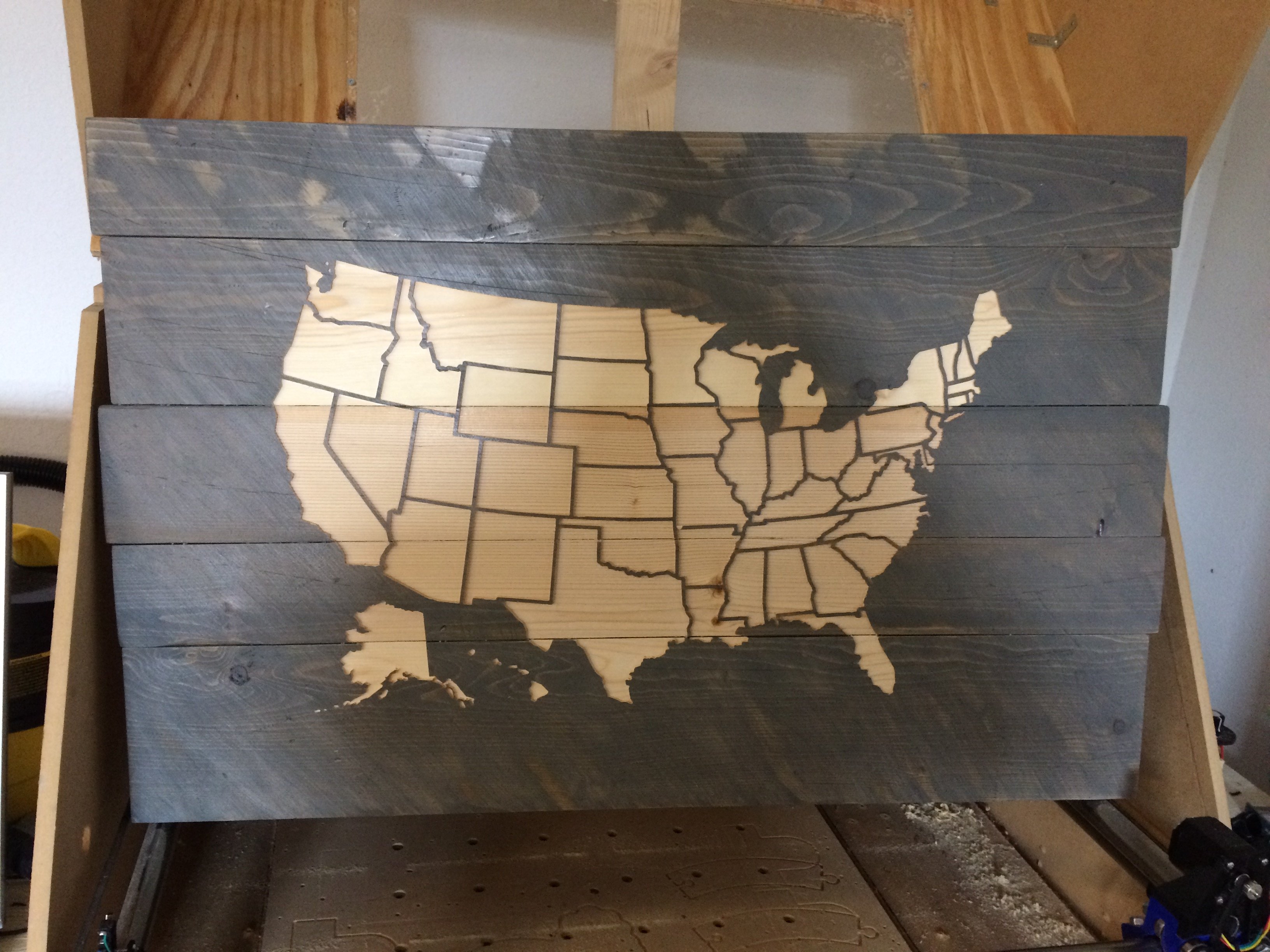

Ok great I’ll let you know how it works out…here’s a picture of the finished map sign in the video…I think the only other project picture I have posted here was the test map… what’s with me and maps your thinking?..I swear I don’t just set around cutting them all the time lol
Looks awesome, adding it to the gallery.
That looks great. I think Hawaii and Alaska are in the wrong place though.
It looks really good though. Just wrong. :slight_smile:
I’m just glad he got the whole state! Most people forget to add the sliver that includes the state capitol…
