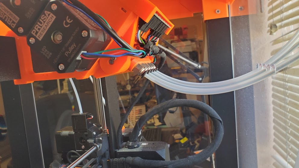

The other big thing that helped was replacing the PTFE tube retainer on the back of the MMU with one that uses quick release festo fittings. That both retains the tubes better without risking crushing them - and makes clearing misloads MUCH easier. It doesn’t prevent misloads…but clearing is a lot quicker and less annoying.
This little upgrade here:

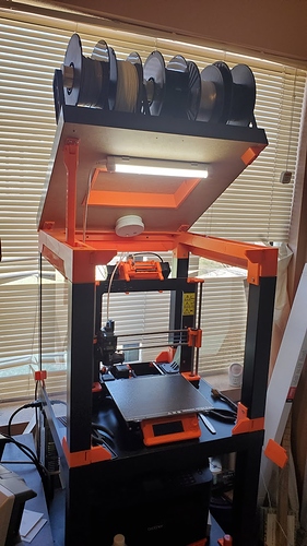

The other big issue is that the MMU takes up a LOT of space due to the buffer. I used the lack table printable enclosure so I can mount my spools up top and that makes it more compact…but having the machine in an enclosure also makes working on it (i.e. clearing misloads/misunloads) a lot harder.

When it works…it’s brilliant (other than the wipe towers often using more material than the prints, but that’s hard to avoid due to the physics) but when it fails it can be a major pain to deal with. If I had room to lay it out instead of having to use the stacked enclosure setup it would be a lot easier to deal with and clear issues. But that’s a LOT of space which I just don’t have.

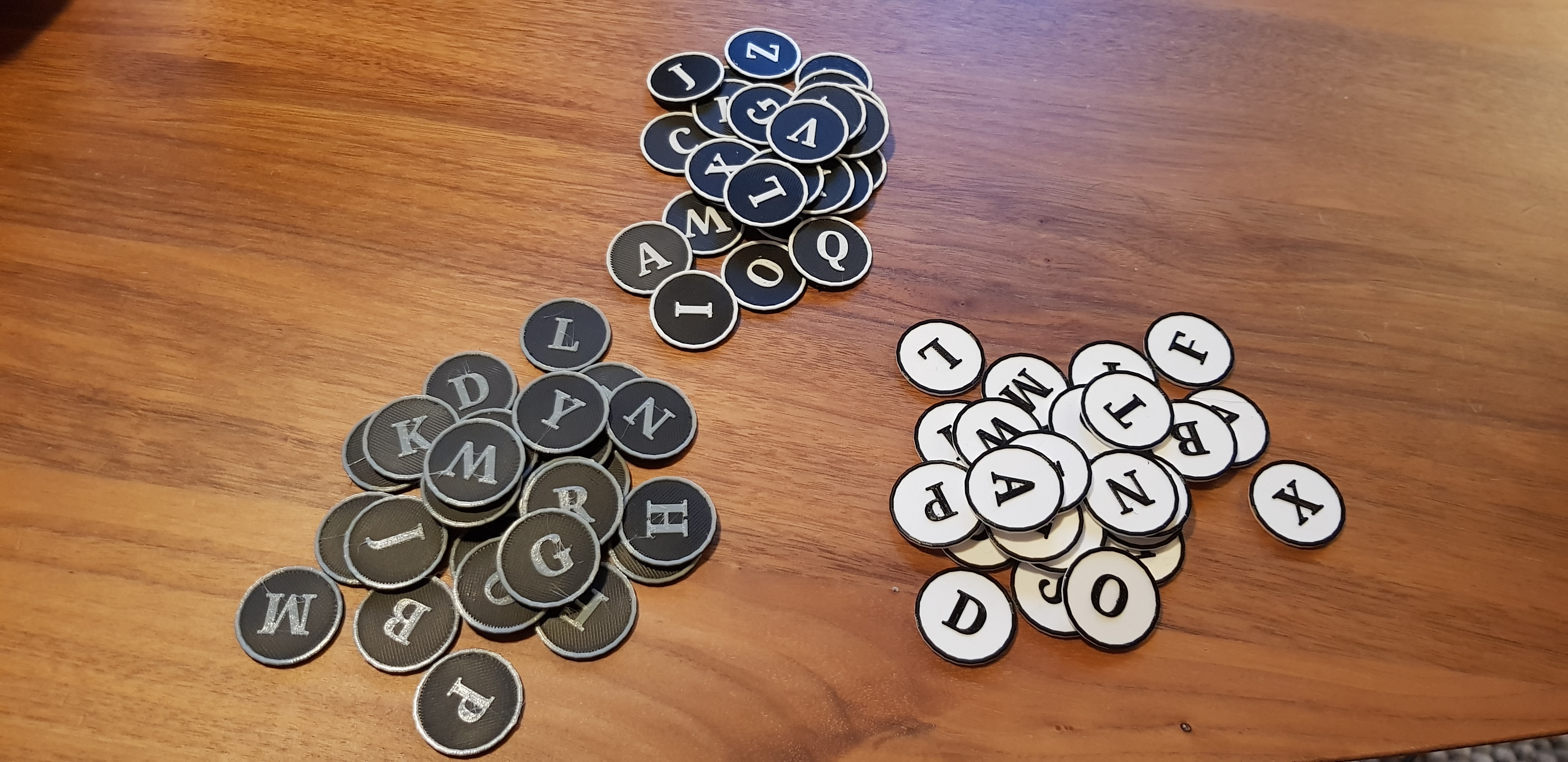

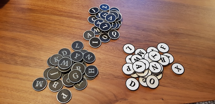

I really enjoy multicolor printing!! (Dnd tokens)
Nice. I’ve used the MMU to print my Kids Wild Kratts creature power discs that are similar. Animal image instead of a letters. They are obsessed.
