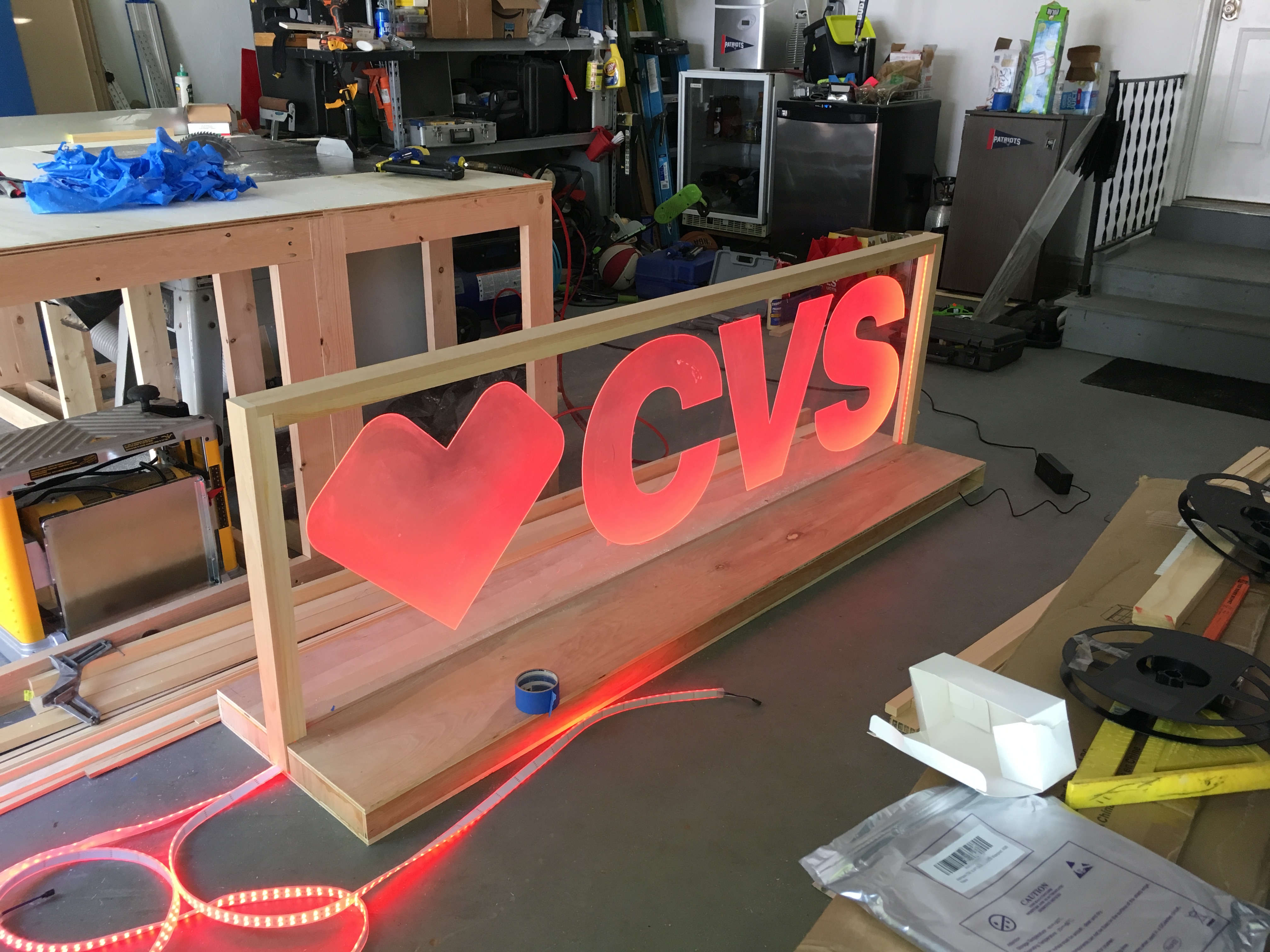

Attempted a LED edge lit framed sign...kinda succeeded. Could always use some advice here
I made couple very large edge lit signs all with 3/4" acrylic, For the CVS sign I used a Double row LED

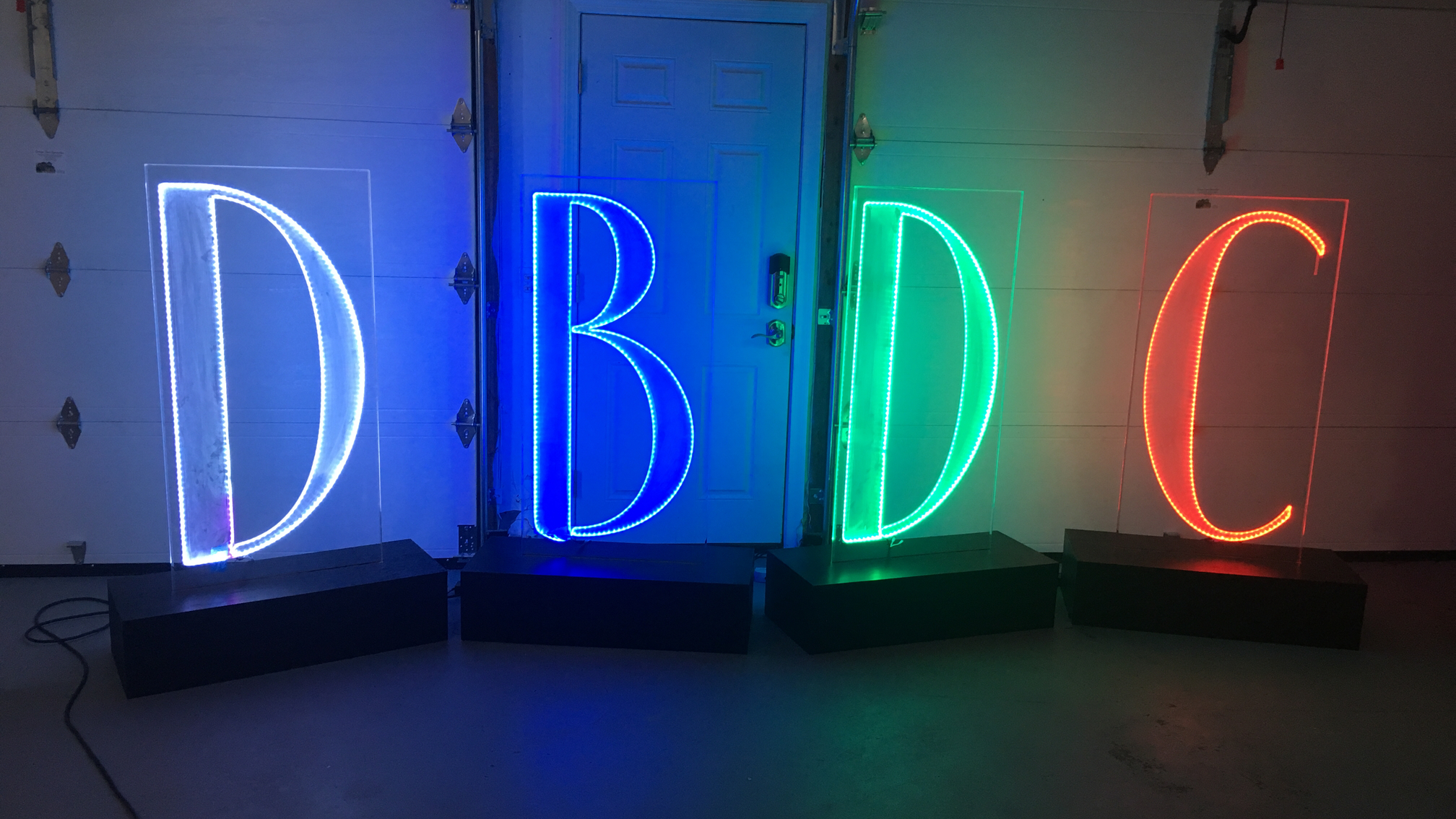

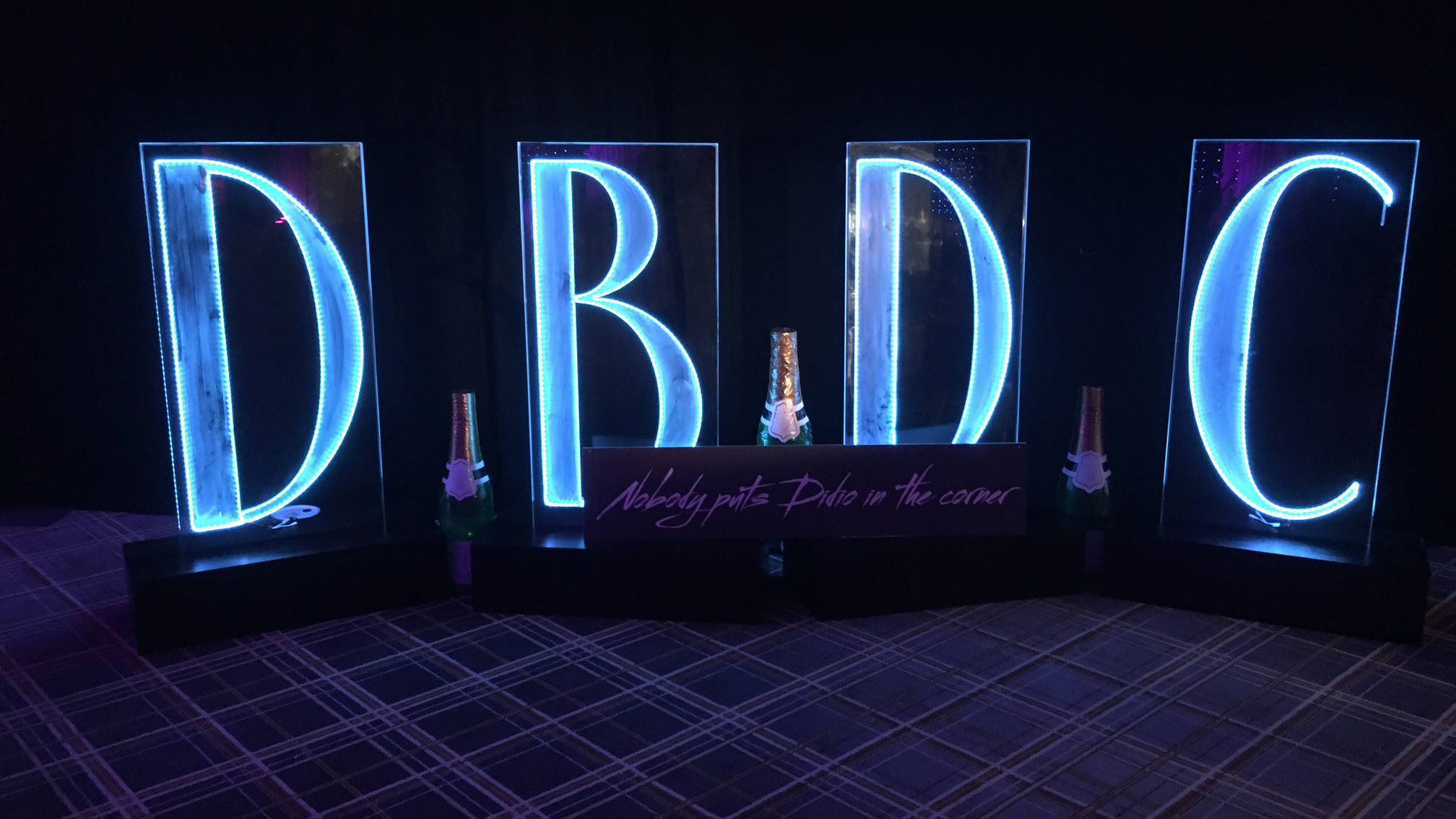

The DBDC sign was a single LED rope like the one listed above, The difference between the 2 signs is that I mill the acrylic down to 1/4" and glue the led strip inside of the letters
