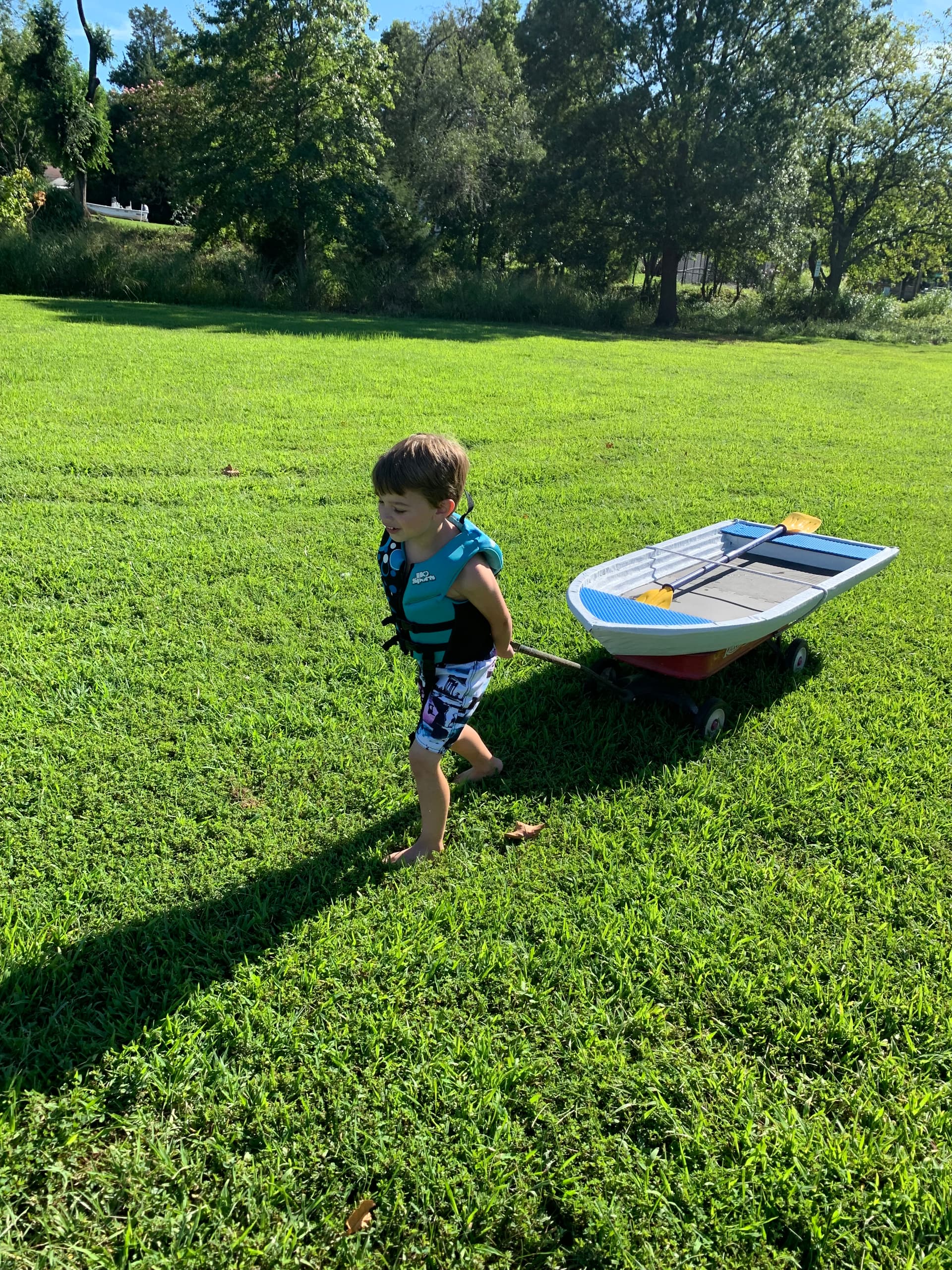

The wagon is so perfect!
  • boat trailer
Yes, my bad. Off road capable yacht hauler!

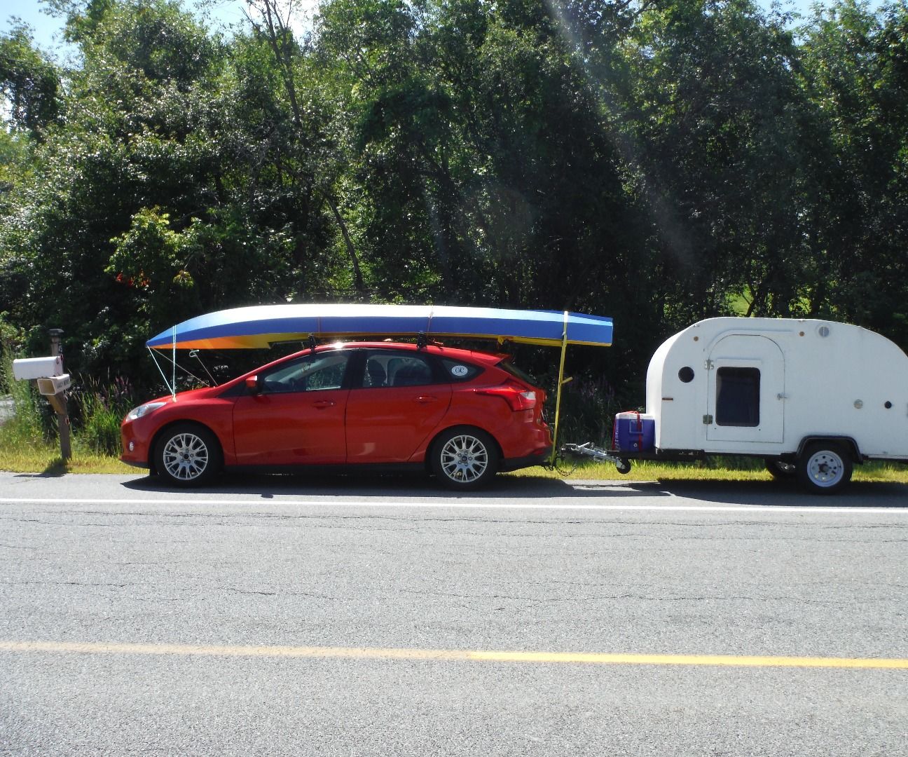

The “BoardYak” stand-up/sit-down paddleboard my daughter and I built from Dave Gentry plans and templates used a fun blend of old-school and new-school materials and techniques. The structure is 1/2" home-center plywood for frames, cedar fence boards ripped down for stringers, all finished with boilded linseed oil then laced together with “artificial sinew” (a heavily waxed twine). The covering is heat-shrunk Dacron fabric stitched and stapled in place, with hardware store Rust-oleum paint filling the weave. Whole thing weighs about 15 pounds.
Going strong after 5 years with just occasional paint touch-ups, but it is stored indoors.
