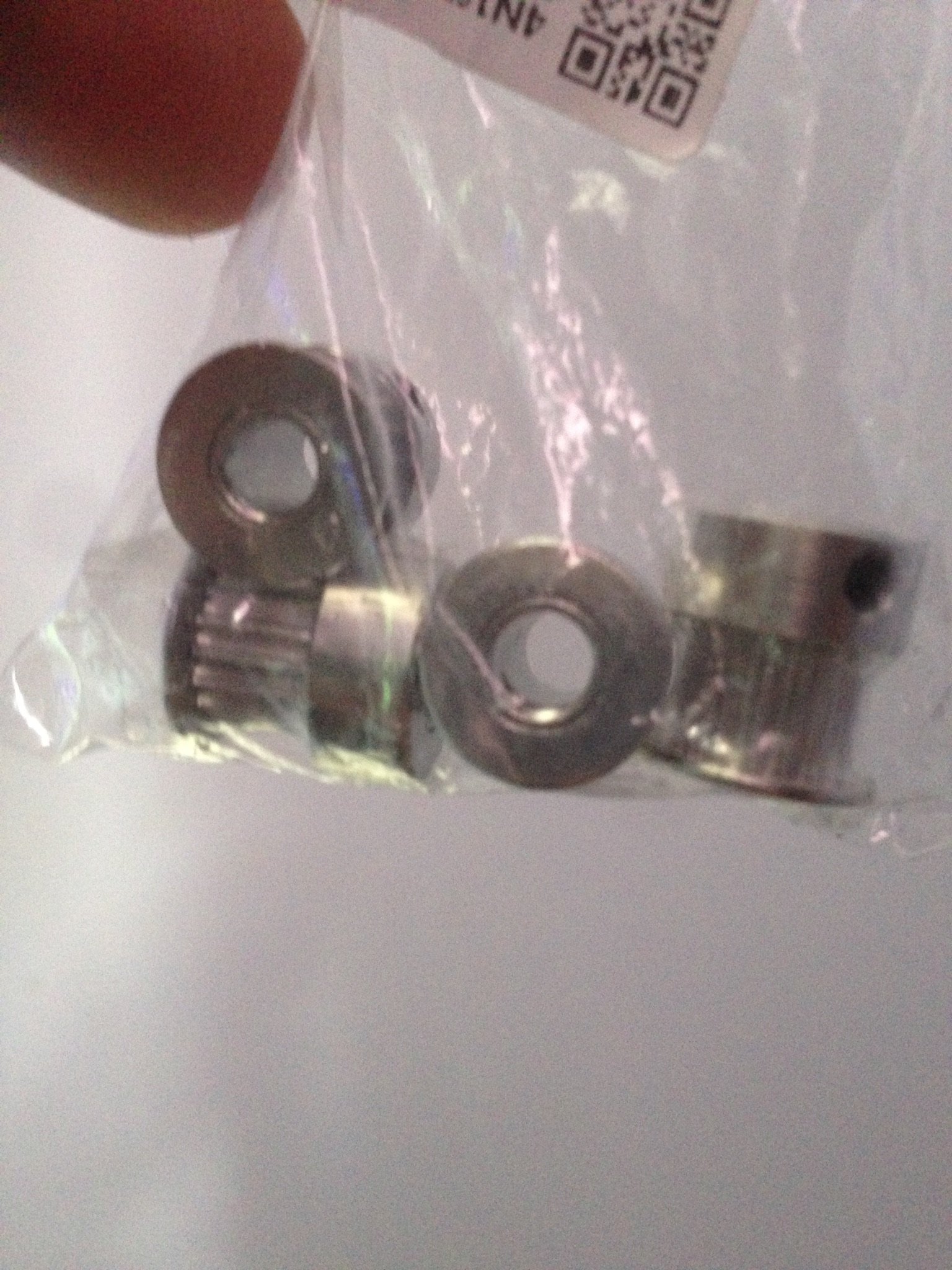

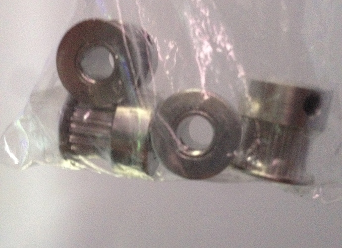

Afternoon Gentlemen
Today postie delivered my penultimate item for my MPCNC, these being the 16t gears
[attachment file=65182]
I now have one more item to receive. That’s the coupler. I guess I could print one but having these delays seems to help as I get time without rushing.
Today I plan on installing those tears, checking / adjusting the stepper driver voltage and again researching how to actually run the software for a CNC… I see many attach a pen first time and Draw Ryan’s Crown…

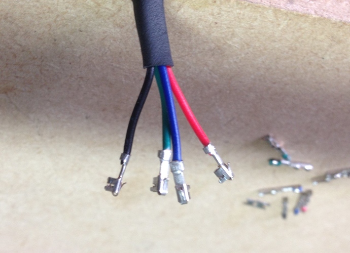

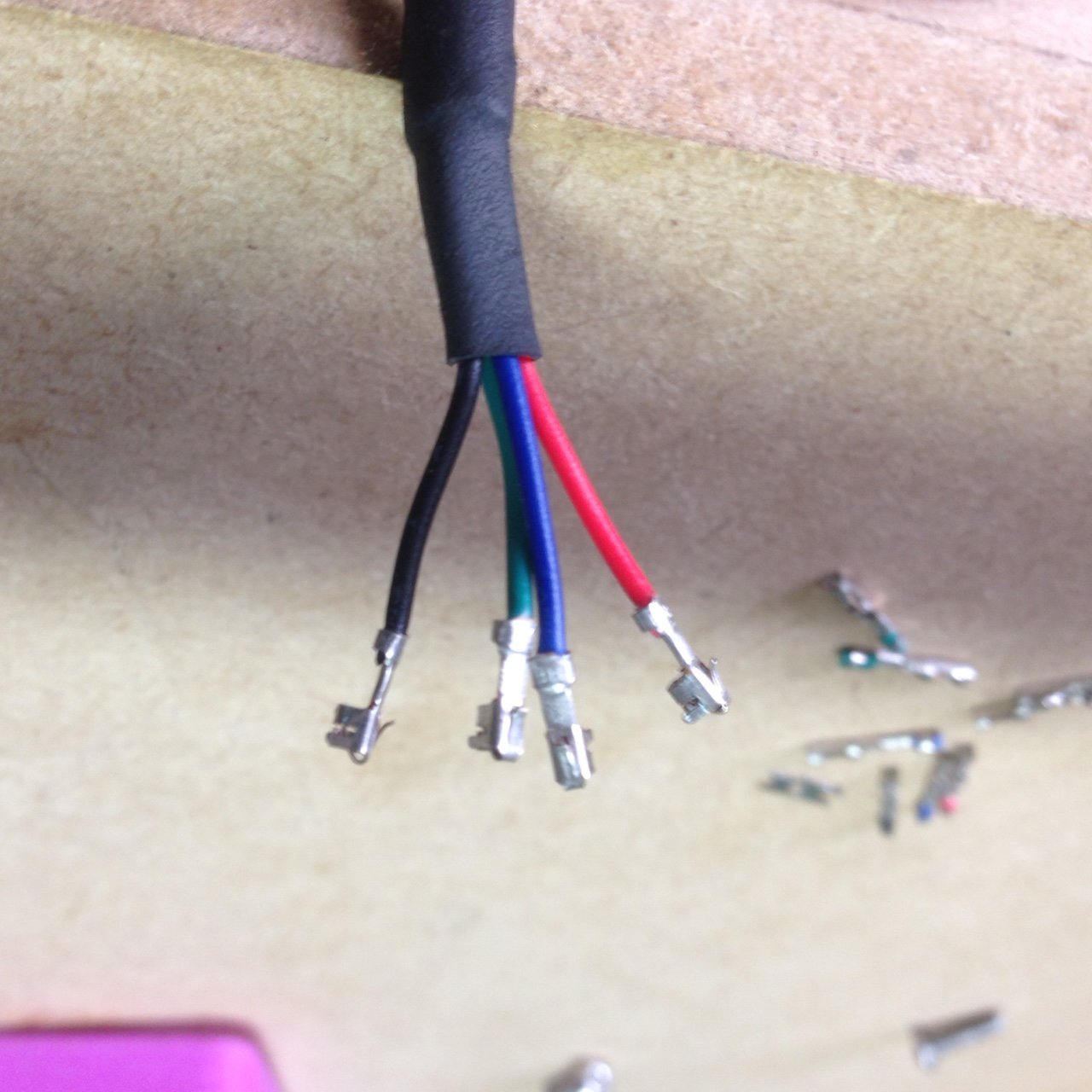

Evening Gentlemen
Well Interesting day. I attached all belts and tightened according to the instructions.The X axis moves to its full extent without issue. While testing the Y axis it is very temperamental. moves to its full extent and then moving the other way stops and judders. No reason to when or where it stops.
anyway, thinking it was stalling, I increased the Voltage for that stepper driver from 0.7v - 0.8 and then 0.85v. This didn’t change anything and it still “stalled”
So I decided to swap X - Y and vice versa. This is where it got interesting. both axis then responded without issue…
mmmmmmmmmm Interesting. so I swapped them again and did some more testing.
Eventually I found the issue. After much head scratching and testing.

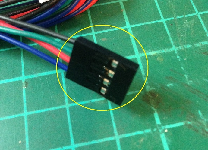

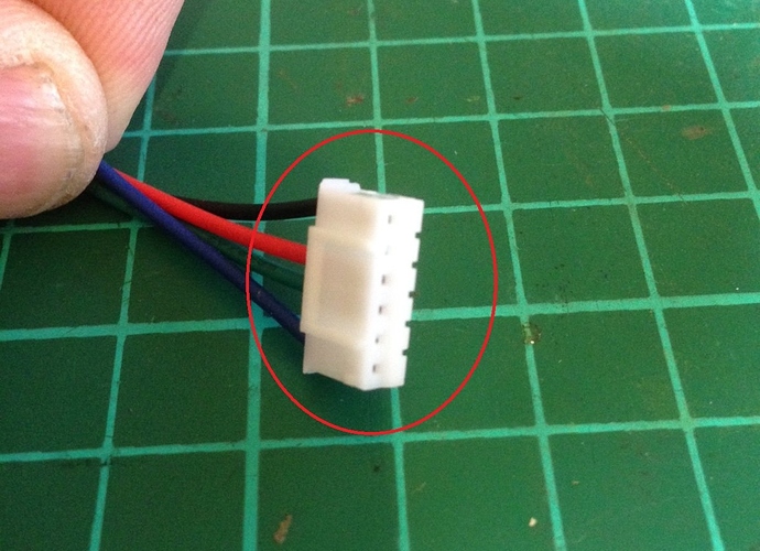

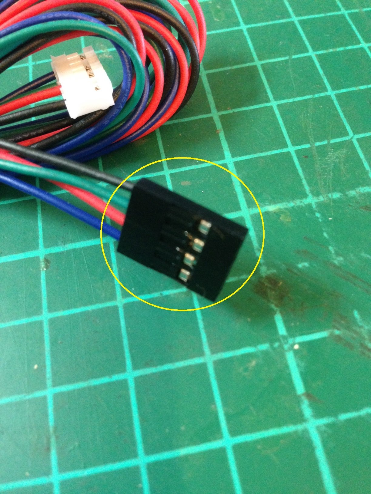

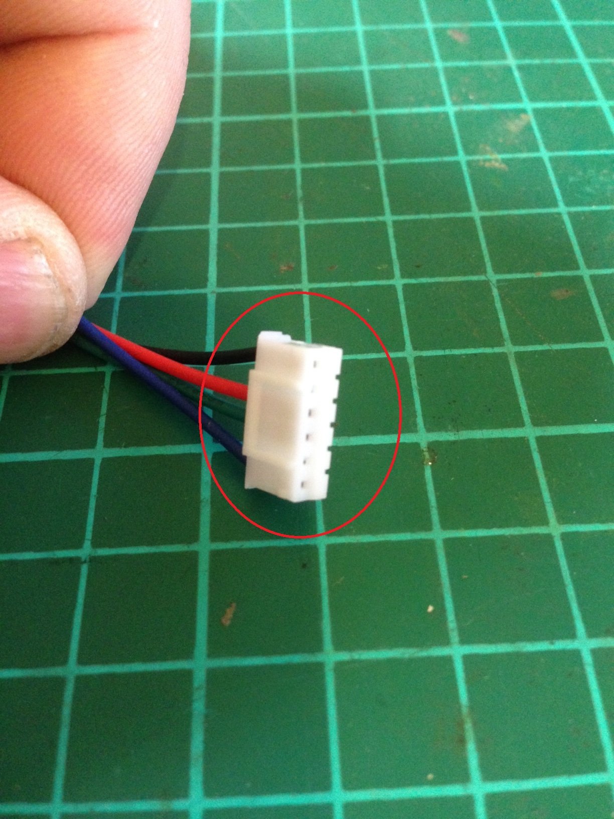

The stepper motor wires are terminated with these connections
[attachment file=65218]
The Control Board connectors are for these,
[attachment file=65219]
Replacing the black connector for a white one cured the problem and so it must have been making and intermittent connection.
They say these things are sent to try us…
Regards
The black connector in and of itself isn’t a problem, those DuPont style connectors are correct for 0.100" spacing headers. Likely the crimps were bad…

I’ve had bad luck mixing the dupont and jst-whatever connectors. I have a feeling it’s actually the size of the pins that is different. Or maybe the length. I’ve especially had trouble with a jst pin on a board and dupont socket ona cable. I had enough trouble that I bought a whole JST setup. YMMV.

Specs are 0.65mm pins with 2.54mm spacing on the DuPoint, 0.64mm pins with 2.50mm spacing on the JST-XH (rated at 3A). There are smaller JST sizes with 2.0mm or less spacing on them. I don’t know about the Rambo models, but the RAMPS models all seem to use the DuPont style headers.

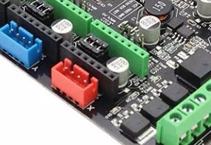

Evening Gentlemen
Thank you for your Advice, these are the connectors in my Controller Board
[attachment file=65414]
I think they are a compatible with JST-XH connectors like these pictured below
[attachment file=65479]
Regards

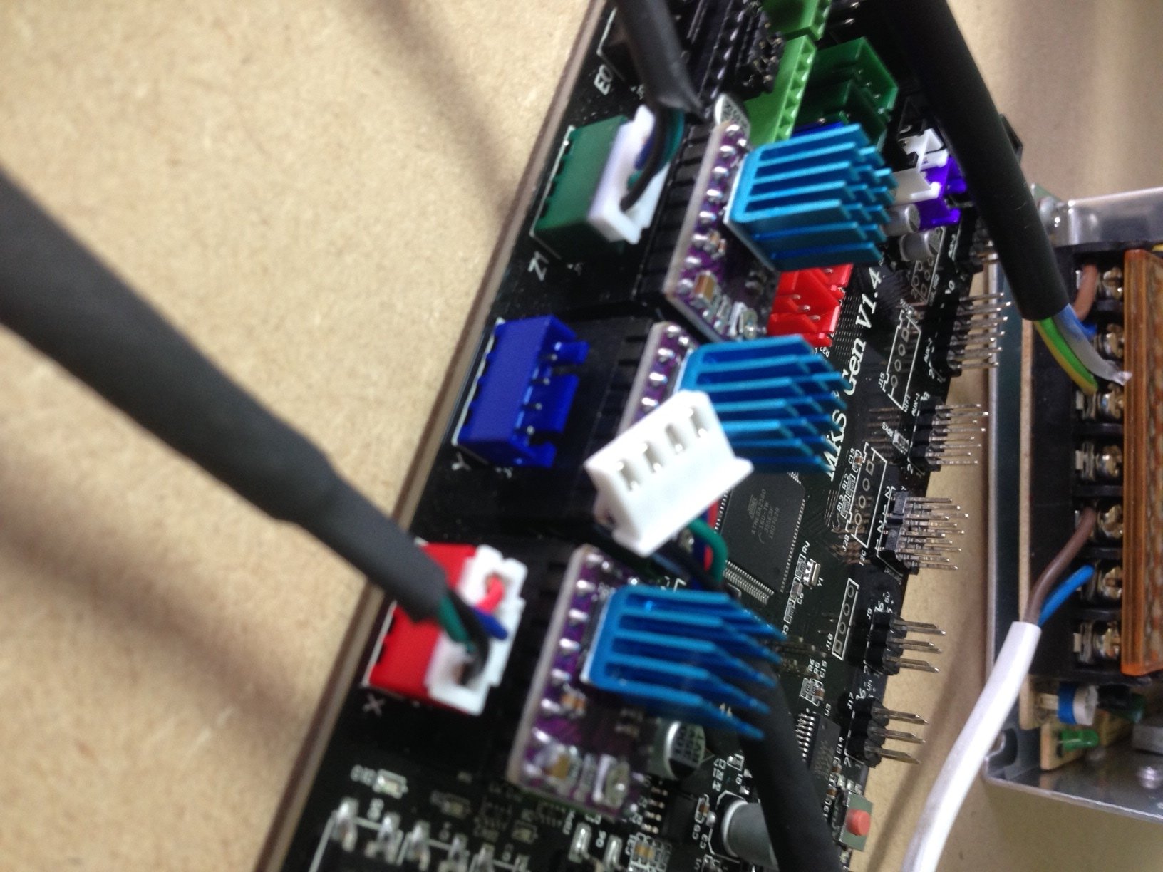

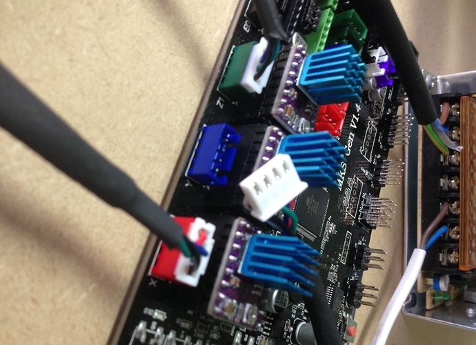

Afternoon Gentlemen

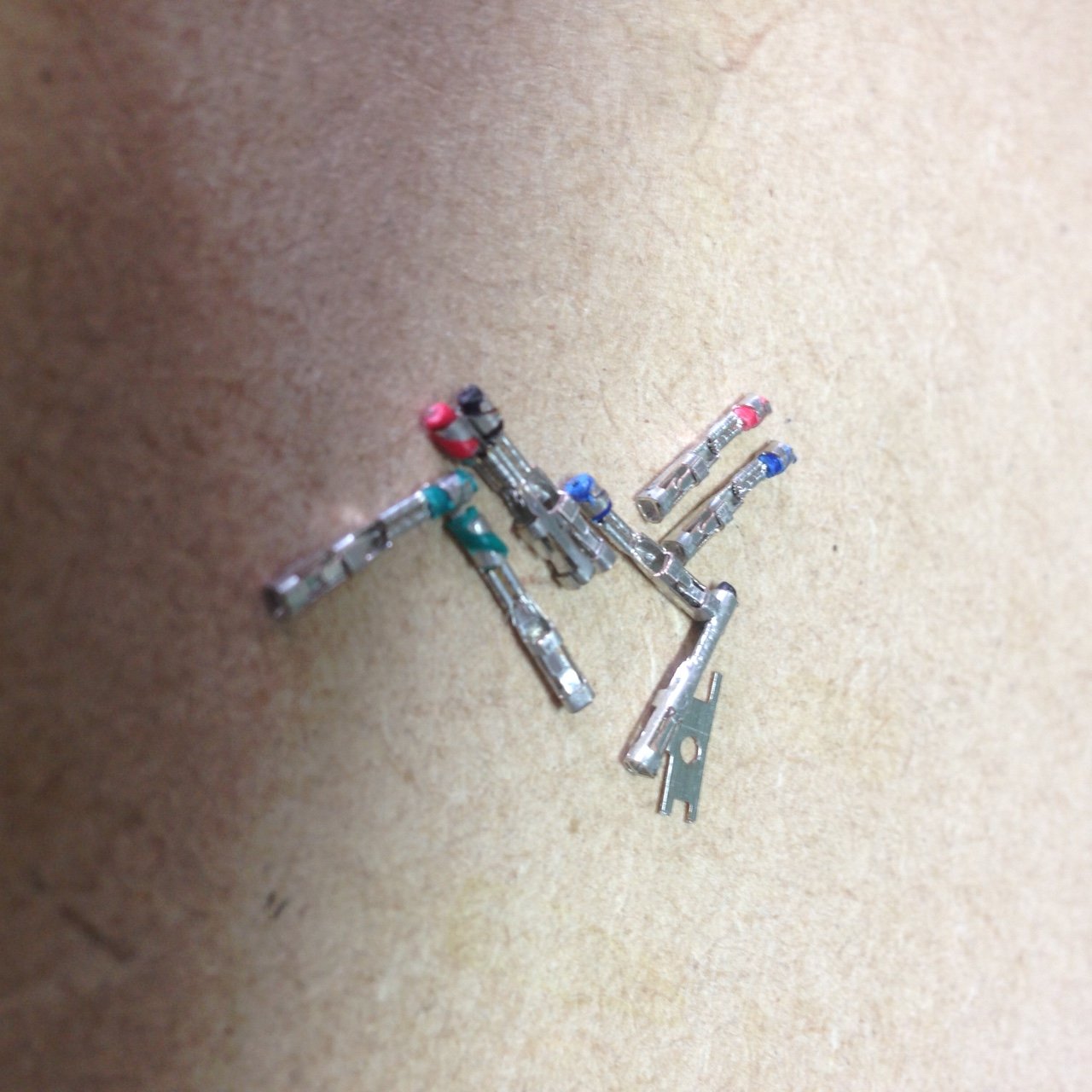

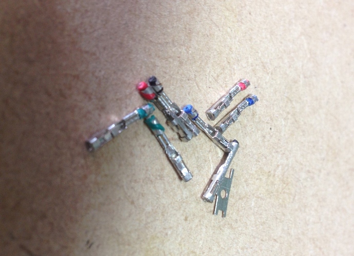

Today the replacement terminals and housings arrived. First I removed the useless Dupont Terminal
[attachment file=65500]
Not a very difficult task, Then a task I quite enjoy. Attaching the new terminals with the correct tool
[attachment file=65501]
Finally after installing the housings and attaching them to the control board
[attachment file=“65502”]
I connected the USB, powered up the 12v Power box and gave the X,Y & Z axis’s a full movement test. Very happy to report that all axis now moved to their extremities without the previous issue as described above.
