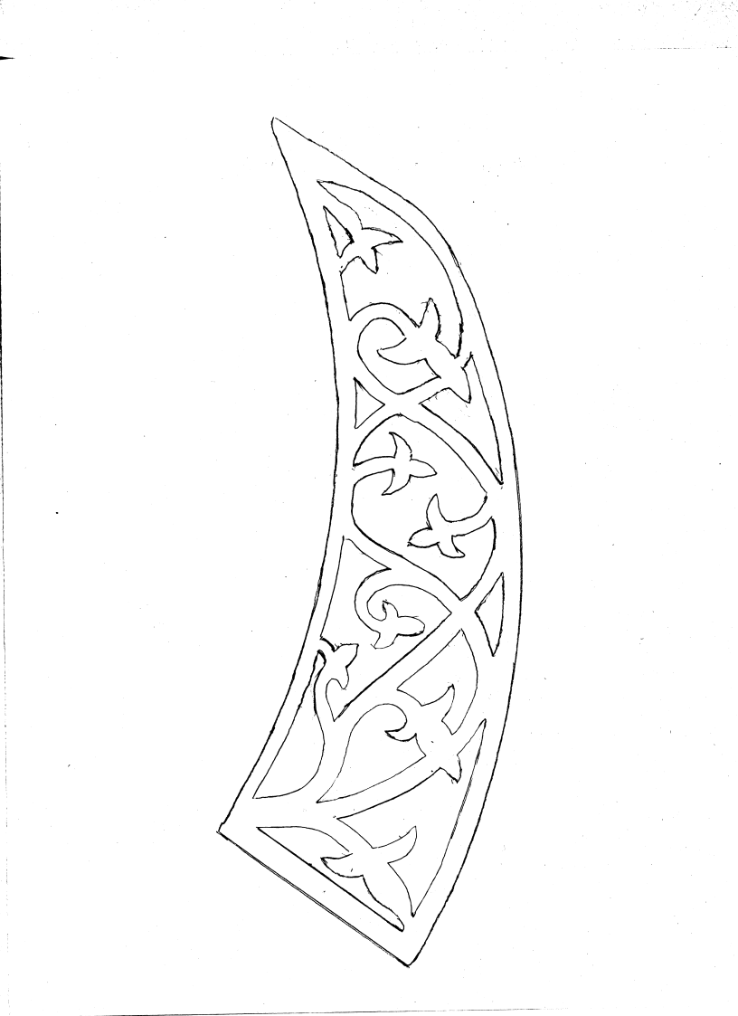

My first step was to pencil trace around one of the missing pieces and then fill in the remaining broken pieces with my limited artistic ability. I scanned the pencil drawing with my epson scanner and created a png image. Here is what the scanned pencil trace looks like (the piece sits horizontally on the top of the clock bonnet):

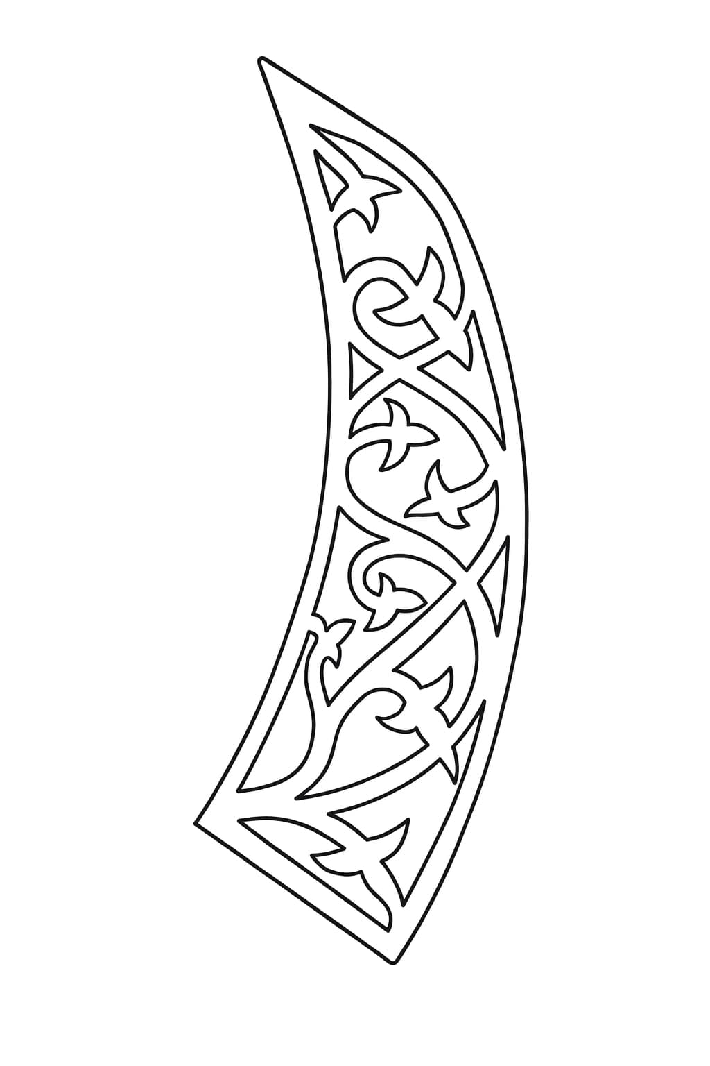

I then tried to use inkscape to convert to svg but the pencil traces are a bit jagged and not smooth. I then asked AI (heaven forbid) to smooth it out for me with strict instructions to keep the aspect ratio and dimension. The co-pilot AI did a good job with this but I had to re–scale back to proper size in inkscape. The flat edge at the bottom of the picture is 69mm. Here is the smoothed panel:

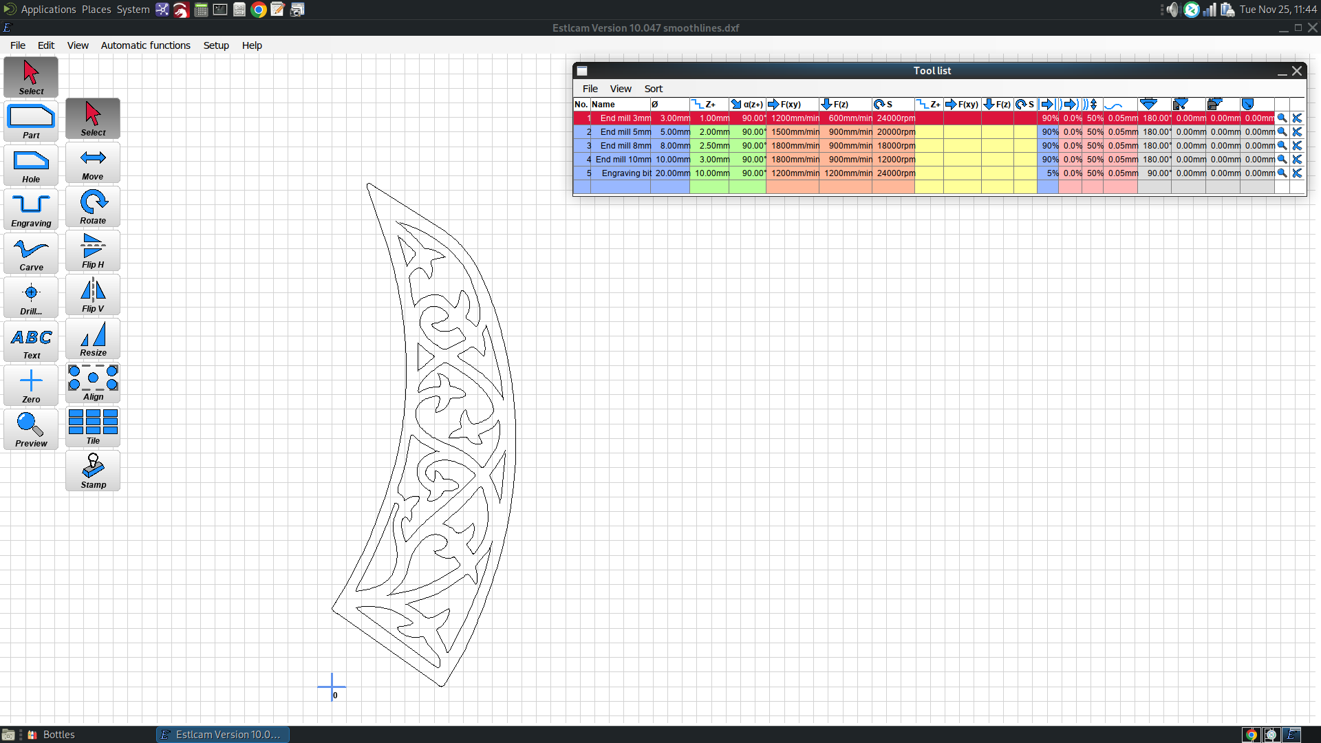

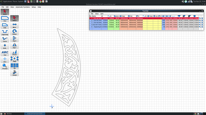

I took your SmoothLines004 image and imported into Inkscape. Did a centerline trace and exported as PDF. I then used an online converter and/or LightBurn to convert the PDF to DXF format. Opened in Estlcam 10. Are you sure that the straight bottom line isn’t ~96mm instead of 69mm? Scale it, if necessary.
Thank you all, these suggestions are really good. I tried the millmage trace which was straight forward but Estlcam scribbled messages when I selected the outline for cutting. It might be some tweaks in the trace settings to get Estlcam happy.
Next I’ll try dkj4linux’s method of centerline trace and pdf to convert to dxf. Clearly it works as in the screen shots. I’ll rescale to make sure that the flat edge matches my physical fretwork straight edge of 69mm. Then I’ll try a thin plywood cutout to see how it fits the clock bonnet.

It can be done with inkscape alone.
Import the JPEG
keep it selected and click path—> trace bitmap (i used default settings)
Then click “apply”
Keep the trace selected, then click path–>object to path
then click save, choose a location and filenname
Open the drawing in estlcam
I used a virgin inkscape installation, used it many times before, but not on this laptop.
