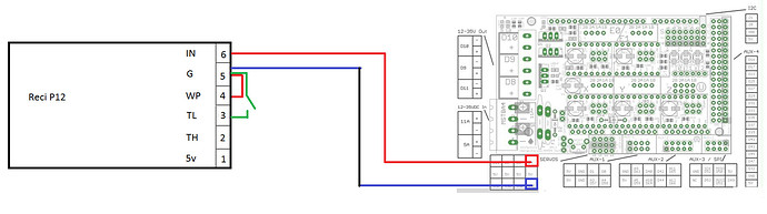

As for setting it up with with Arduino and Ramps 1.4 did you use the same procedure by remapping the 5 v pins to fan control like the tutorial for the diode lasers? That is currently how I have my 6 watt diode set up and was kinda hoping a co2 would be almost a drop in is far as firmware is concerned.

if you are using that setup connect it like this:
And also didn’t had a lot of time to do other stuff than working … but vacation is in sight :slight_smile:
What firmware are you running on it and what function did you map to those pins to control the output signal?
