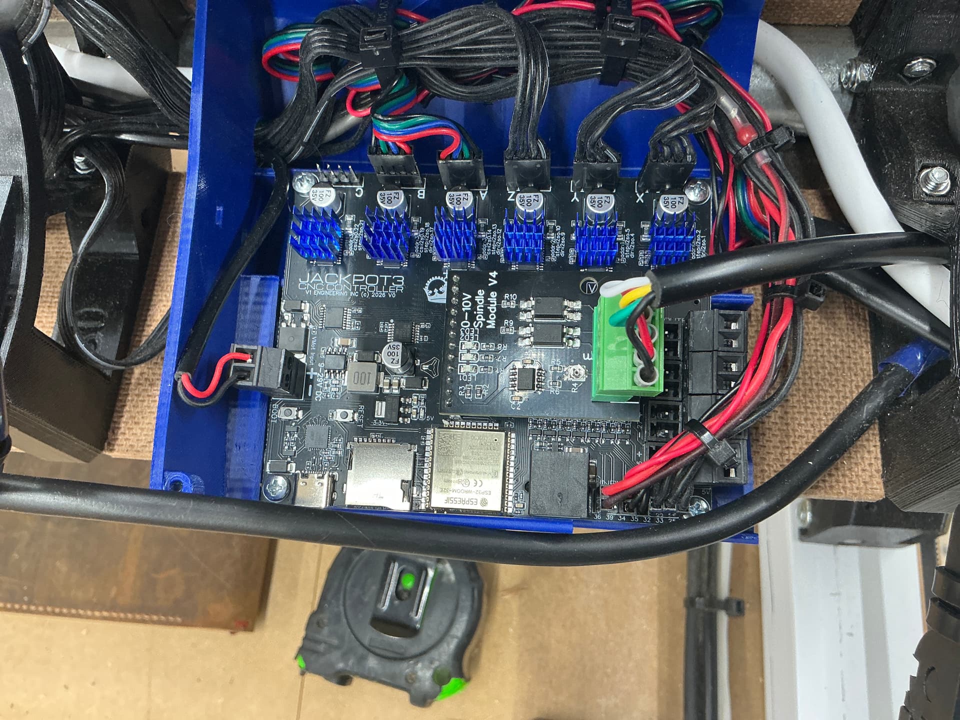

0-10v I/O CNC Module voltage issues
Maybe @MakerJim would have some thoughts?
I need a bit more info to work with.
Is there a build thread for the previous, working setup with The Jackpot V1?
Edit: replying on mobile sucks- spit out two posts instead of one reply.
There have been a couple versions of 0-10V modules. Which one do you have?
Thank Thank you, this is what I have.
Picture attached
This is correct. Also, if using a pendant you will need to disable the reverse_pin on the 0-10V module as the pendant needs 2 GPIO for the UART (and it has to be the upper two pins), and the 0-10V board can use up to 3. The Jackpot board only has 4 available, not 5 GPIO on the expansion header and pendant IO (They share pins)
OK I understand this now in the light of the morning. It’s the same module you had before, but you’ve installed the connector to exit vertically instead of horizontally. That’s the right orientation for use with the JP3.
With a DMM, we need to see what voltages you get between the Analog common ground (Black wire in yoru picture) and the 0-10V out (Red wire in your picture).
We also want to see what happens between the digital ground (Green in your picture) and the forward pin (Out1) which is yellow in your picture [i think]
As a start, command off your spindle. You should see 0V on the analog / 0-10V signal and 0V on the digital/forward signal. Then command your spindle on at full speed. You should see 10V on the analog/0-10v signal and something greater than 3.3V on the digital ground/forward pin.
Finally, if you’re not using a pendant command the spindle full speed reverse. You should again see 10V on the analog/0-10V but now 0V on the forward pin pair and something greater than 3.3V on the reverse pin pair.
Report what you see and we can troubleshoot further from there.

Ok so testing DC, I got the following:
CMD spindle off
Analog Com (black wire) + 0-10v out (red wire) =0.4mV
Digital ground (green) + Forward pin (out 1 Yellow) = 10.75v
Digital ground (green) + Rev pin (out 2 white) = 10.75v
Full Speed forward
Analog Com (black wire) + 0-10v out (red wire) = 11.19v
Full speed Rev
Digital ground (green) + Rev pin (out 2 white) = 165.2mV
Those digital out values seem too high. 11V could damage the spindle if it is expecting a 5V signal.
What model spindle / spindle controller do you have, and can you show how you have the 0-10V module wired to that spindle? Not the picture, a schematic with signal definitions.

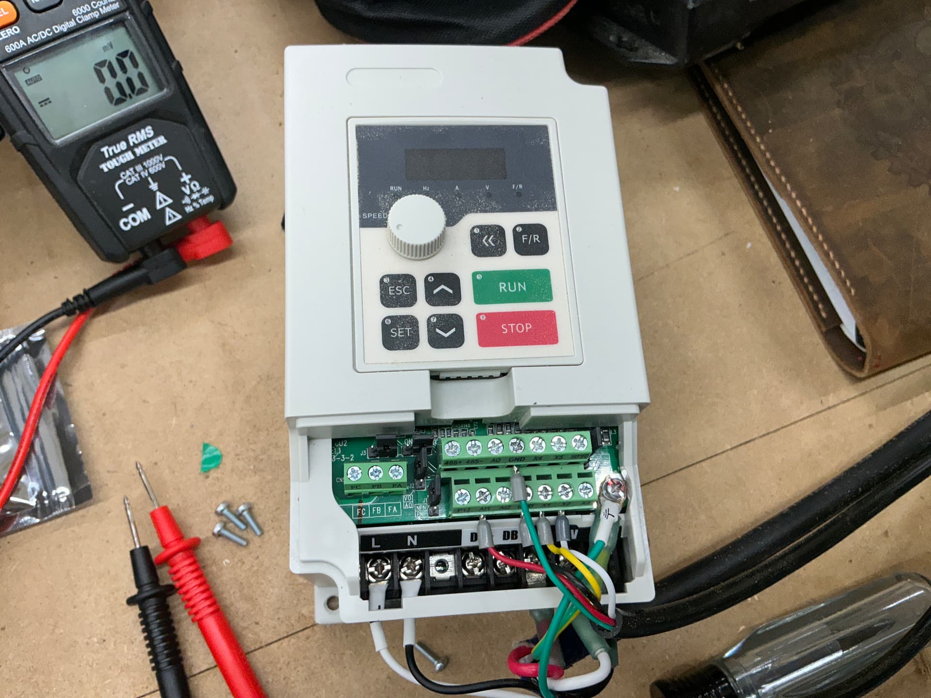

Well, if I remember correctly, when I was using this 0-10v module on my original jackpot, I had to increase the voltage via the POT to get my full RPMs.
I am using the H100 VFD with spindle.
Here is the link to the manual as I am not sure what schematic you would like to look at.
Also, this is how it is wired. As a note, it was working perfect with my original jackpot.
file:///var/mobile/Containers/Data/Application/7E226C46-A61A-4ACE-B408-1E66794E3C5D/Documents/new%20H100%20manual%20V1.8%20(1).pdf
I hope what I attached helps.

If you’re seeing the commanded speeds on the VFD display, it seems that your issue is at or between the VFD and/or spindle, not between the Jackpot board and the VFD.
Or it is the digital signal levels not providing an ON/Forward that the controller recognizes. I still say 11V is wrong for that interface. Later today I’ll revisit this thread.
